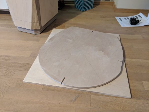

                      I'll toss a plug for a measurement turntable into the mix. Once Steve Manning gets done with all of his fun, beautiful stuff, I'd still want an indexed measurement turntable for the 5 degree measurements that Vituix wants.
                        • 1555
                        Sorry, does this mean to say you're working with Steve to have such a thing made? I recall someone a while back showing one using a 3D printed indexer that looked pretty sweet, dunno if Steve can do that but it'd be cool to offer them to the community.
                        I've got my own plan for one but would seriously consider an SMJ version, especially since mine won't be indexed.
                          • 2135
                          Steve has a rough drawing put together for Bear on said measuring devise. As far as scales and what not think along these lines ......

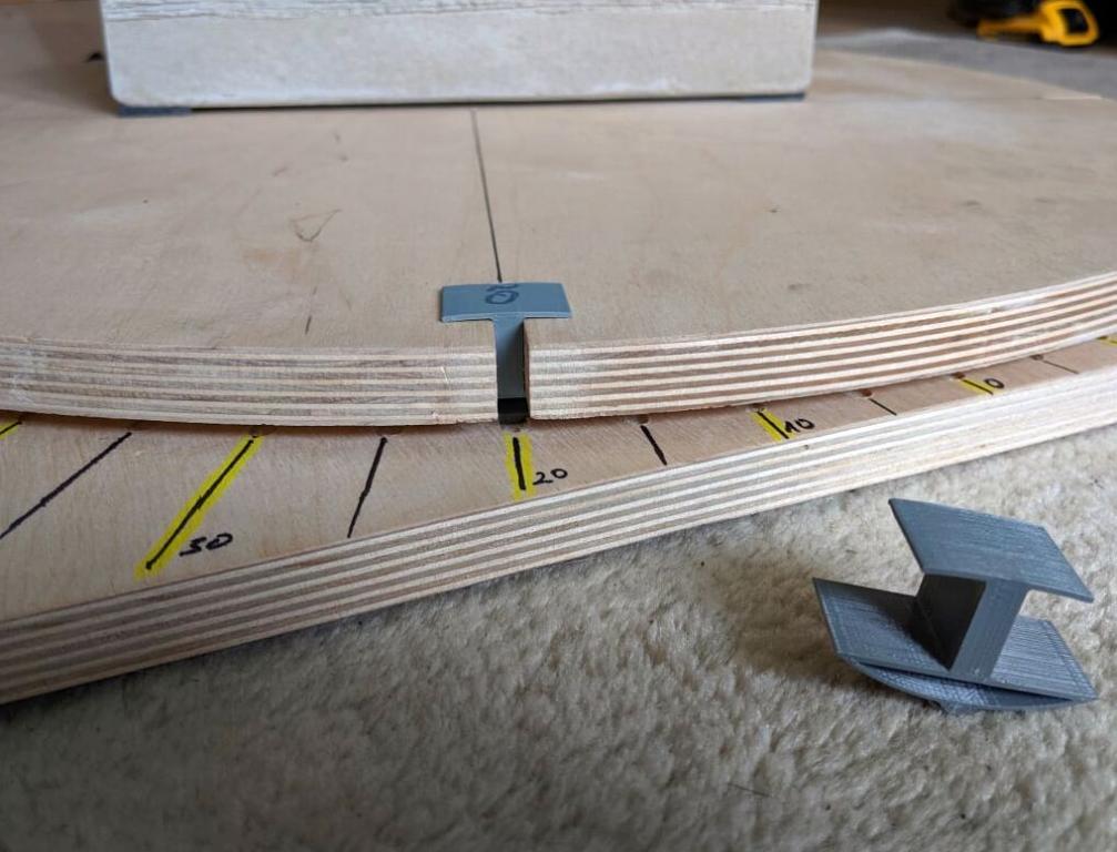

                            That might have been me.... I can share the Fusion 360 files if anyone's interested
ID:	866137Click image for larger version
