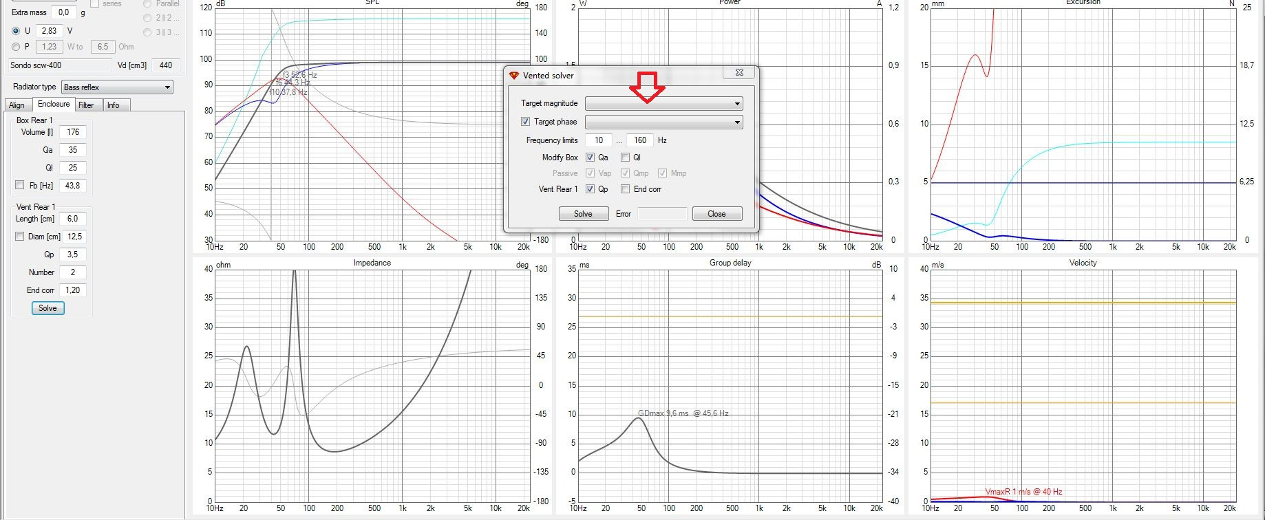

                                New build of 2.0.111.3 has signal limits of 400 Vrms and 80 kW. Switching from P to U signal was not yet fixed in Enclosure.
                                The same limits in Power dissipation window.
                                P.S. Enclosure tool is already quite difficult to maintain and update. Too small changes to remember how everything works so number of bugs has increased. Tool is already overshoot for box+driver design though database browser is nice and useful imo. Product quality is done with something else than "volume and vent calculator". Basic simulation with T/S is far from adequate for much more than purchasing decision and preliminary values of those two. More complex radiator concepts are not supported. According feedback users don't seem to see much more than box simulation.
                                • Nil L
                                  • Jul 2021
                                  • 51
                                  #1052
                                  kimmosto,
                                  The Enclosure tool has a solver to fit the appearance of the impedance curve to the target. But when I press the file select button, the file system explorer does not appear. Second. There is a ready-made enclosure with a driver and a port, and there is a measured impedance in this box. T/S driver parameters are included in the database. The shape of the proposed impedance curve is not similar to the measured one. I tried to use the parameters Qa, Ql, Qp to match the appearance of the proposed curve to the measured one. This improved the similarity, but not completely. Then I went through the Table and Ql options on the Align tab. And I repeated the adjustment of the Q parameters. This brought the curves even closer. Then I added 20 liters to the volume of the box of 180 liters. But still the curves were not the same. Question. Can a program do this work on a button solve? If you give her a file with actually measured impedance with amplitude and phase. And using as fitting variables all the parameters that I used and possibly the TS parameters. Because the TS parameters from the manufacturer were created in 2011. Since then, something has changed, improved, and so on. And many people have this situation. After all, there is an actually measured impedance curve. Based on it, you can select the size of the port, the volume of the box (slightly), the frequency of maximum output of the port, and the transient response.
                                  • kimmosto
                                    • 711
                                    What "select button" and solver? Calculate T/S or Bass reflex or Passive radiator? Everything I have tested works here as designed.
                                    There is a ready-made enclosure with a driver and a port, and there is a measured impedance in this box. T/S driver parameters are included in the database. The shape of the proposed impedance curve is not similar to the measured one.....
                                    What is the problem? Recommended procedure is that after you have actual box, you measure SPL and Z responses, tune if needed, load responses of accepted box+driver to Drivers tab in the main program, design XO with simulator and configure or build XO. That's it. There is no need to override parameters in driver database or try to imitate measured Z response with Enclosure tool and driver database or worry about "normal" parameter differences between (possibly old) datasheet and actual driver samples you have. All that is just extra work after cabinet is accepted and measured for XO simulation.
                                    T/S parameters could have quite large tolerance and changes while burn-in, but that does not cause much or significant effect to box volume. Vent length needs some tuning almost without an exception. Qa, Ql, Qp and Qm of passive are kinda irrelevant. Main target for filling is not to get certain Q. It's to damp possible resonances due to standing waves down to acceptable level. No more.

                                      #1054
                                      If you click on the field or button to the right of the field marked with a red arrow, you cannot make a selection.
                                      If the chosen port length or diameter was not calculated very accurately, and this only became clear after the final assembly of the speaker with the crossover, I assumed that using the Enclosure Tool I could look and select more correct port sizes. Or disassemble the box and increase its volume.

                                        Where's your impedance overlay to solve with? Read the manual.
                                        Scroll down a bit, you'll see "Solving parameters of passive and bass reflex radiators".
                                        • kimmosto
                                          • 711
                                          #1056
                                          Right. This is how it works. 1) Load Z overlay(s) to graph.
                                          Click image for larger version  Name:	image.png Views:	0 Size:	43.0 KB ID:	951270
                                          2) Then you can select correct overlay from solver window.
                                          Click image for larger version  Name:	image.png Views:	0 Size:	15.2 KB ID:	951271
                                          Anyway, I'm quite sure that solver is not able to find solution because it requires almost exact match. That is quite rare in real life.

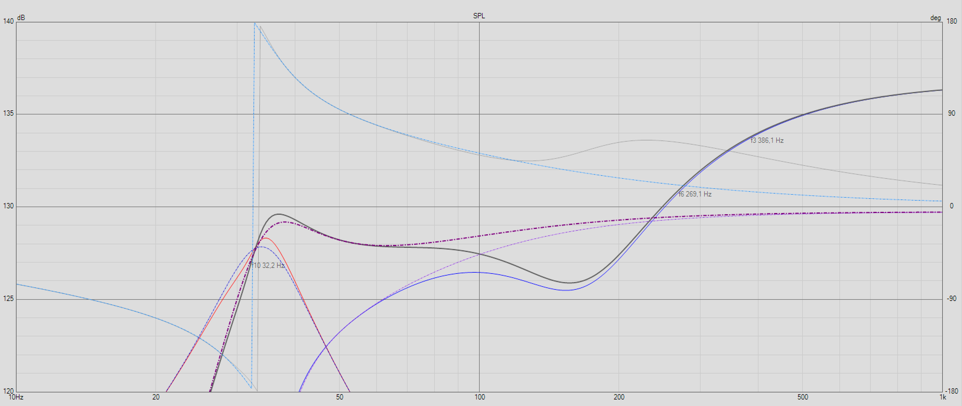

                                                Originally posted by Reet
                                                I found it worked "well enough" for a pair of 10" passive radiators I had without documentation.
                                                Sometimes solver is able find very good match, but it may require solving of extended impedance parameters too. Here is an example with Purifi PTT6.5X04NFA with two passive radiators. So we can simulate accurate impedance response if we have the same system as actual for calibrating T/S and extended impedance parameters Not much sense imo but it's there.

                                                        • Snickers
                                                          • Feb 2024
                                                          #1065
                                                          Max port length of 500cm while still simulating longer ports.
                                                          I was simulating a huge infra bass subwoofer. When I lower the tuning or increase the port diameter to the point where the length passes 500cm, the simulation seems to still work as intented, but the port lenght shown on screen never passes 500cm. As this equals a pipe resonance of 34Hz, it is not a big deal, but still what is shown on screen is incorrect. Also, with a quarter wave calcelling path, a 5 meter port could be useful up to just above 50Hz, so some might look for a solution like this.
                                                          • kimmosto
