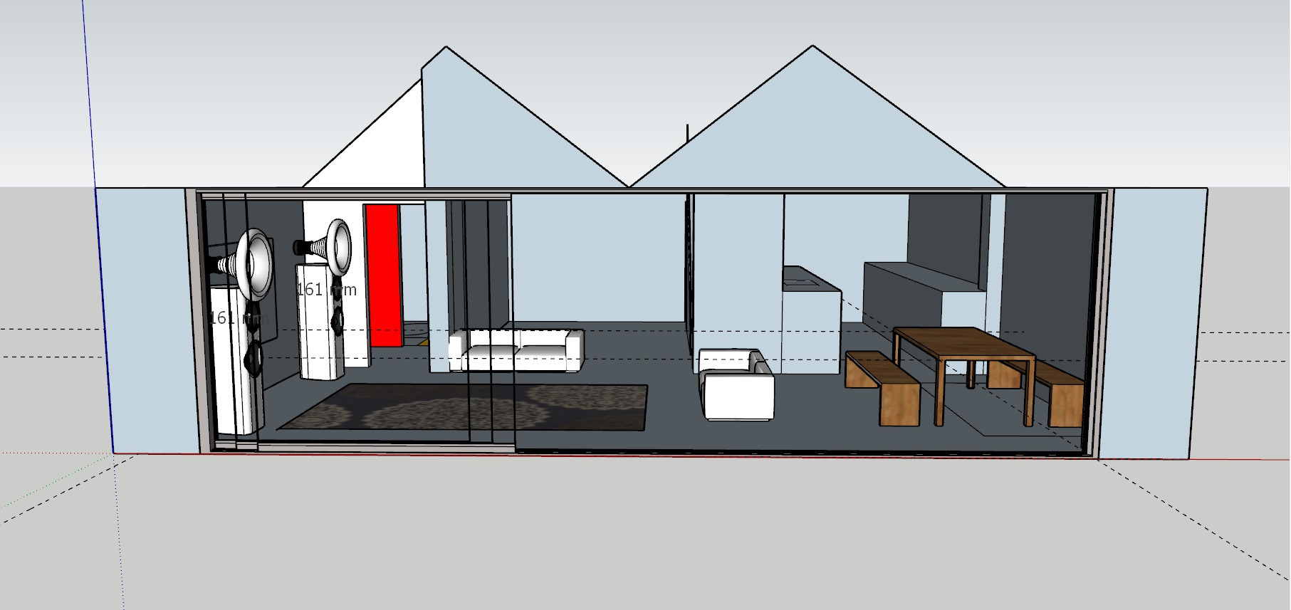

                  So I really need to give some better information, and constraints to move forward productively methinks.

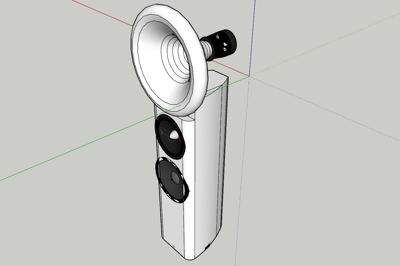

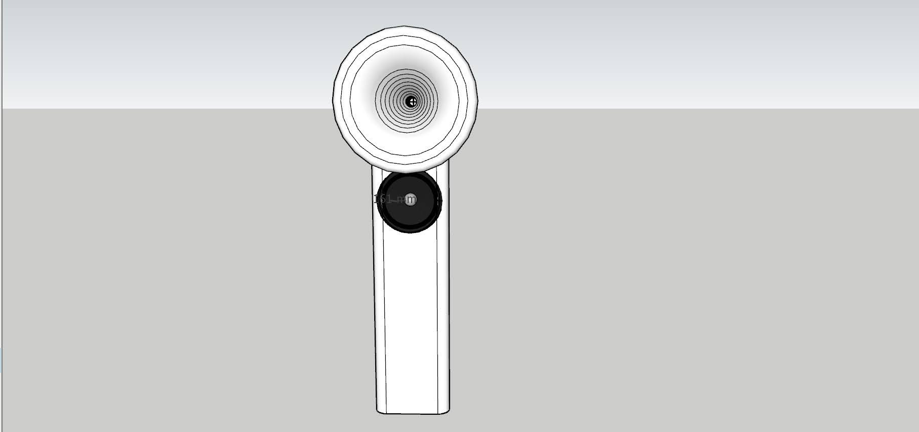

                  Here is an image of the original proposed design. (The driver in this image is the TD10M.)

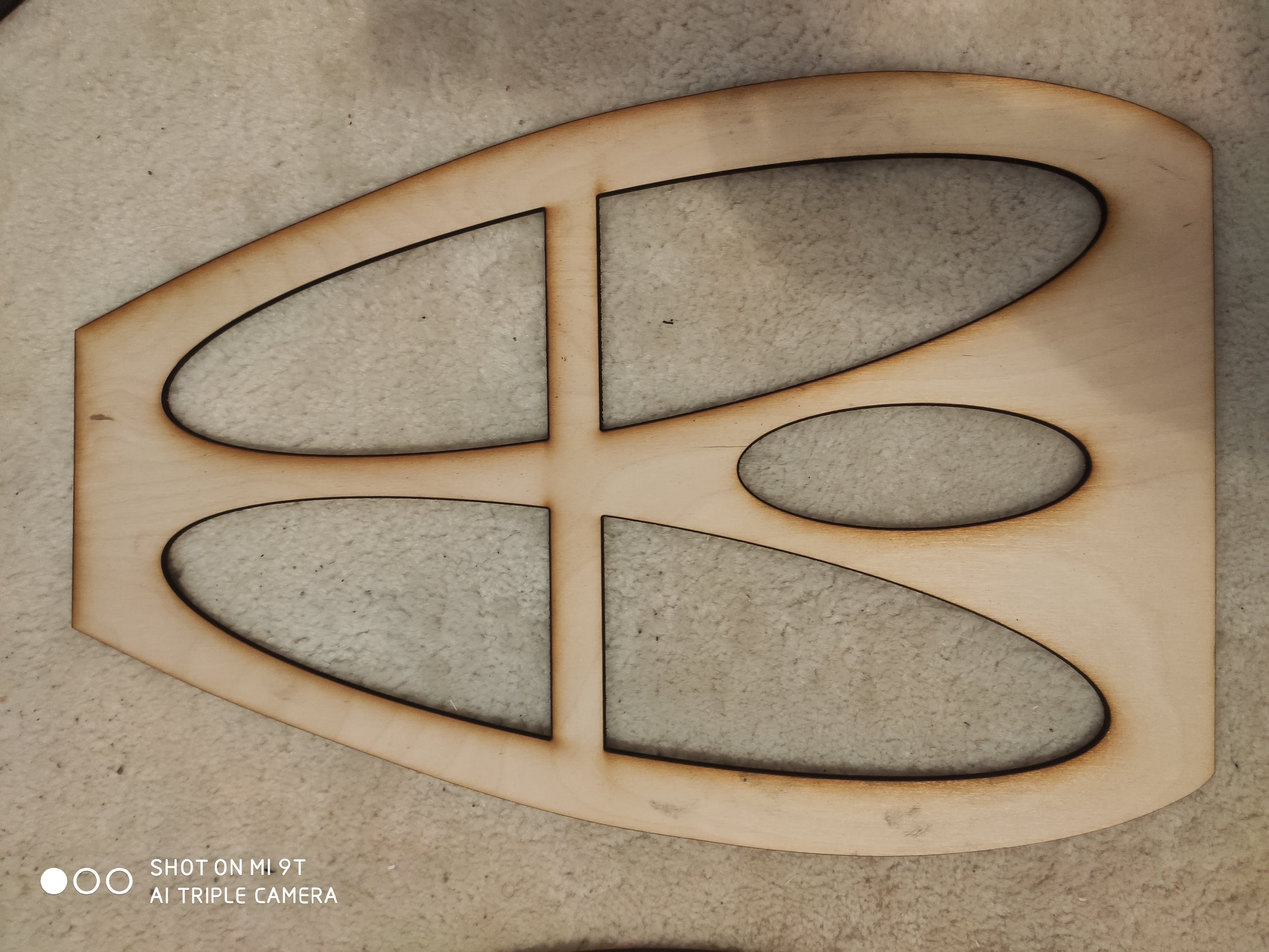

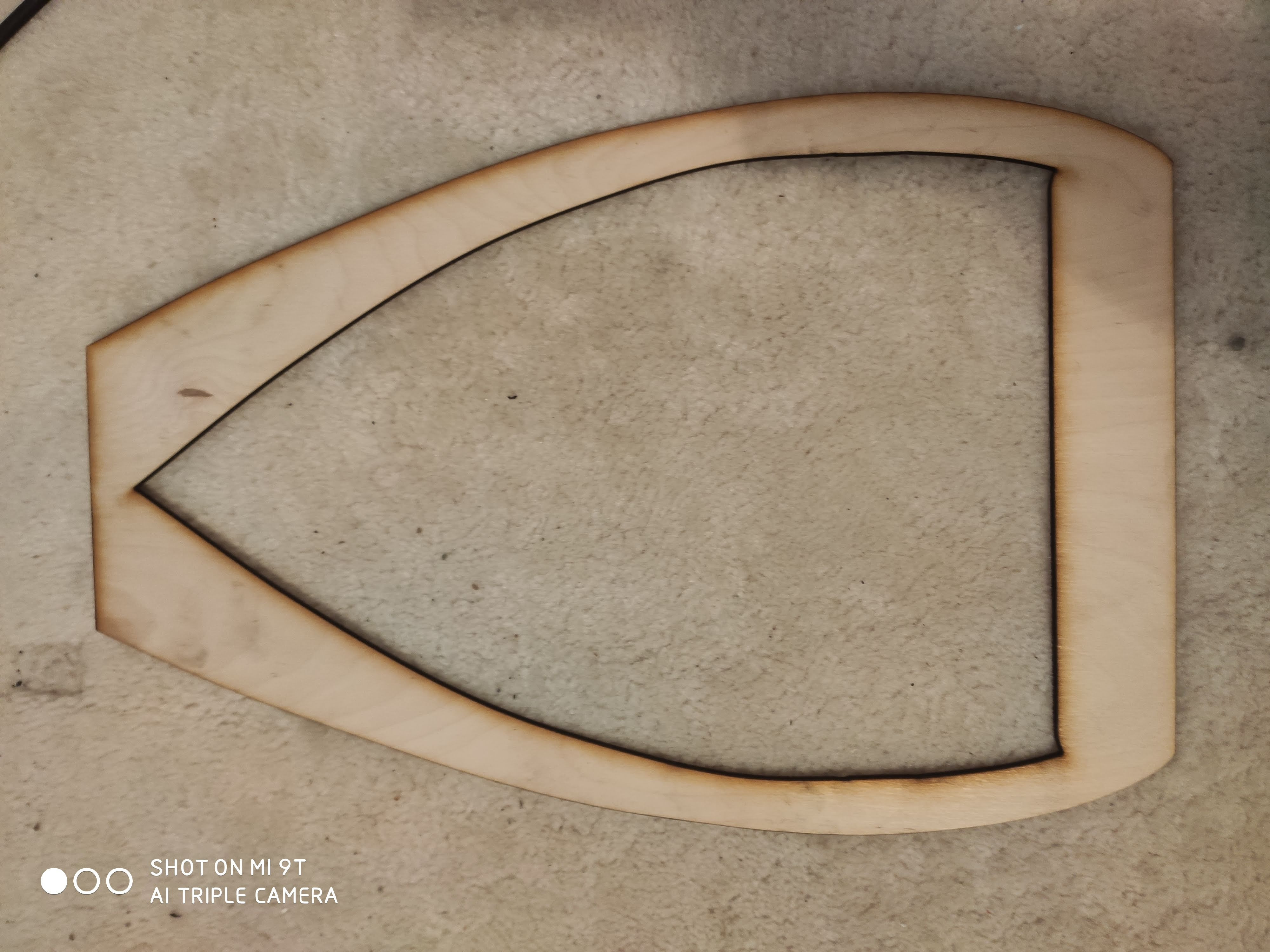

                  When I laser cut some test sections, and put the CAD speaker in a drawing of the living space, it was just too dominant to get it past the boss.8O
                  Dimensions.
                  Having looked at it closely the limits on dimensions for the bass cabinet are the following
                  Height: 1000mm and 1150mm
                  Width: Up to 220mm (ish)
                  Depth: More flexible: Ideally 300mm, but even over 400mm is not outrageous.
                  Frequency range
                  As the spec for this design is pushing the limits, I can make some adjustments to the target response. I would like flexibility for the horn to be changed over at a later date (I would like to try a CD horn at a later date if I could find one that went down low enough!- I'm thinking at this stage I will have to 'roll my own':W)
                  60hz to 600hz would be great for the exact horn and driver I have now, but 80hz to 900hz would give me the flexibility to play with CD horns later.

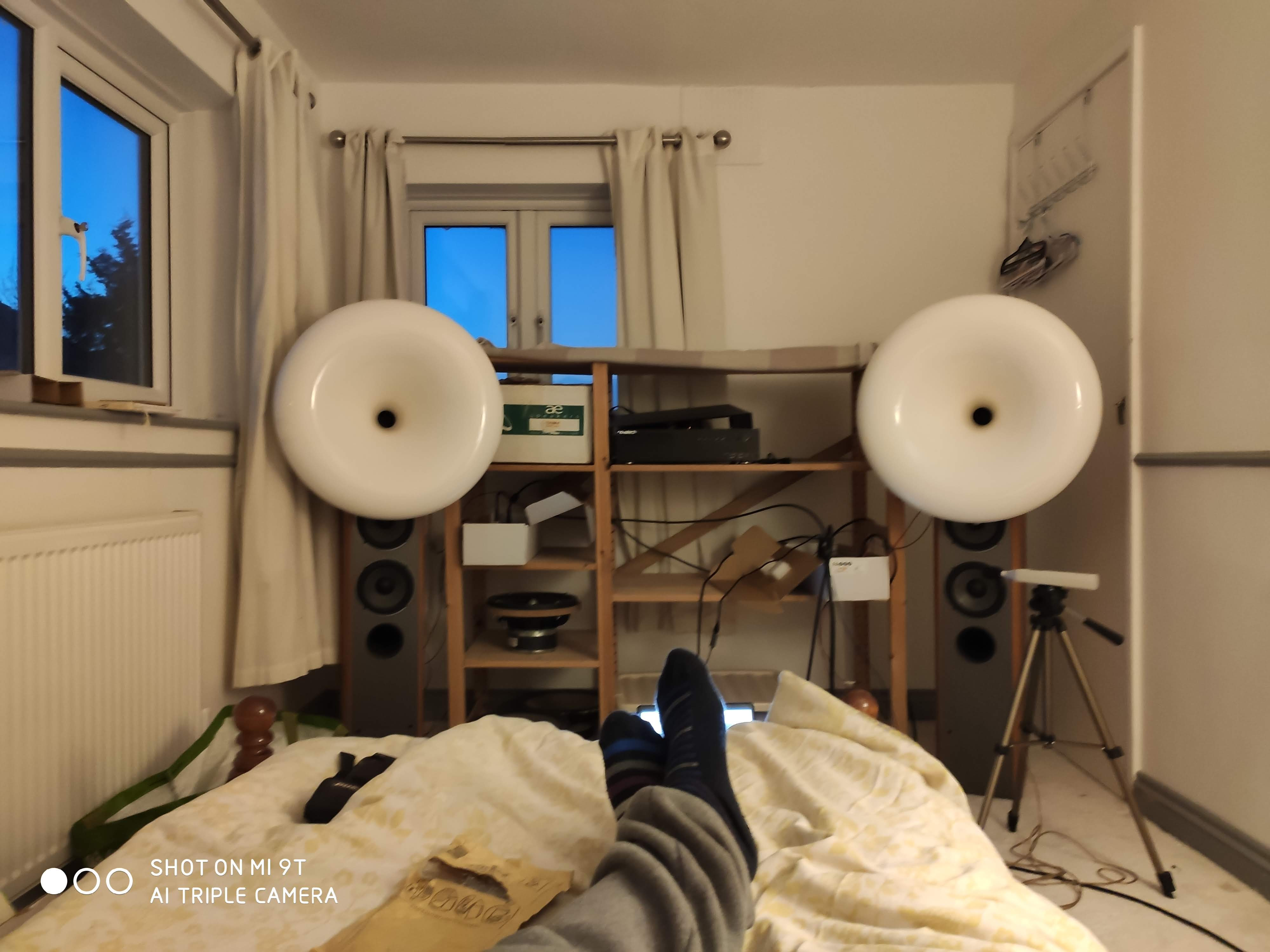

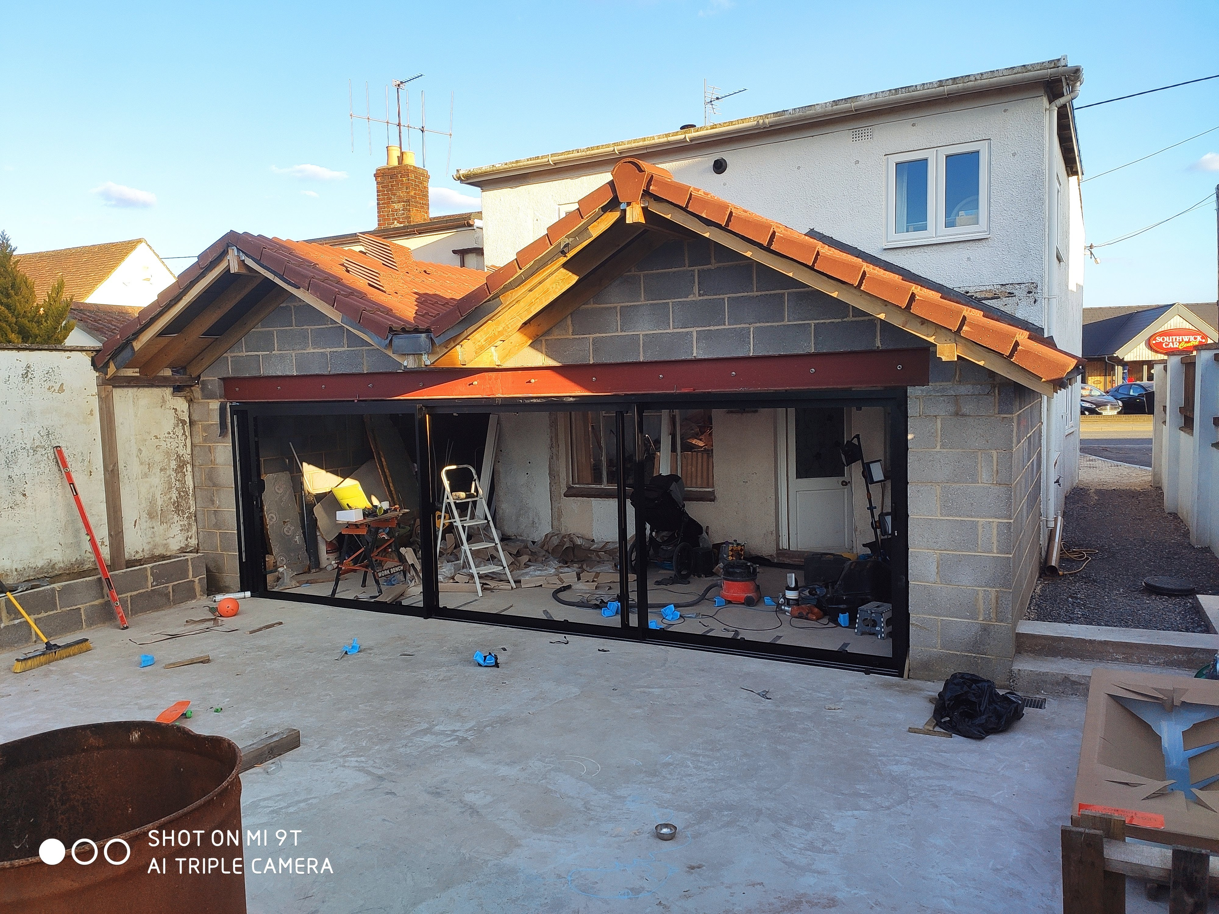

                  Anyway, just for background, here are a few interesting pics:
                  The room (Bath, UK) (I designed it and am building it myself)
                  The horns in the temporary man cave (using JM labs 816s as the bass for now)

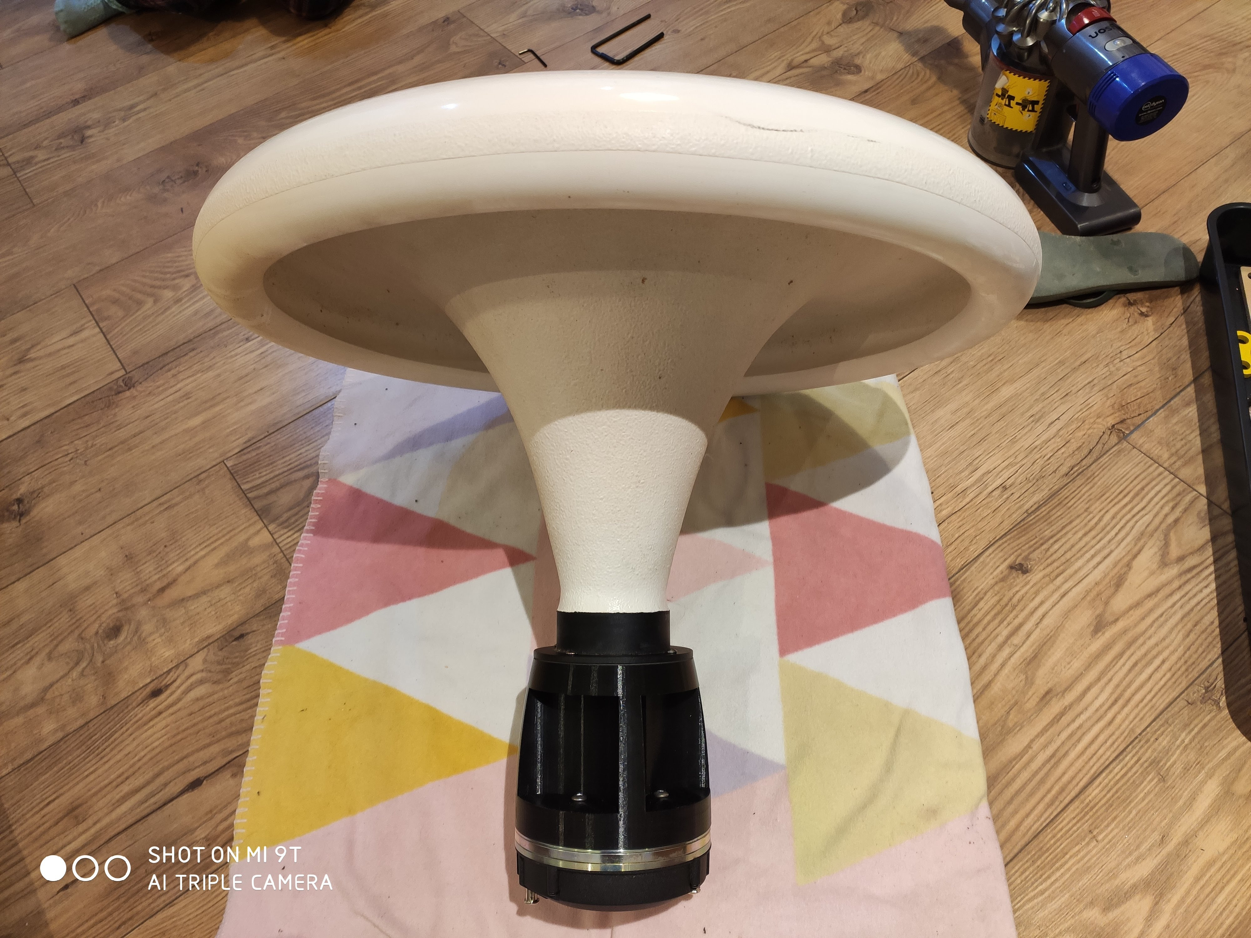

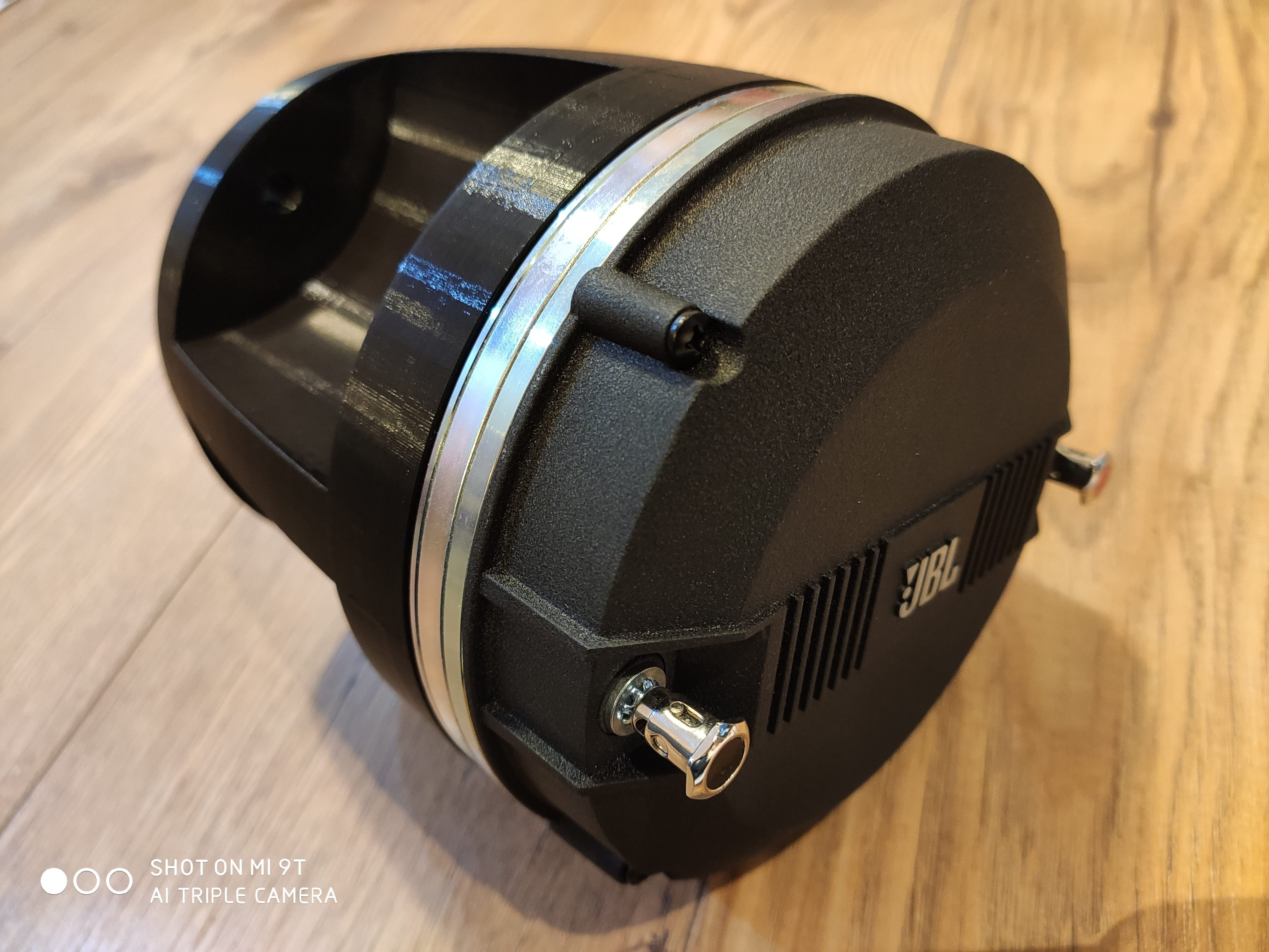

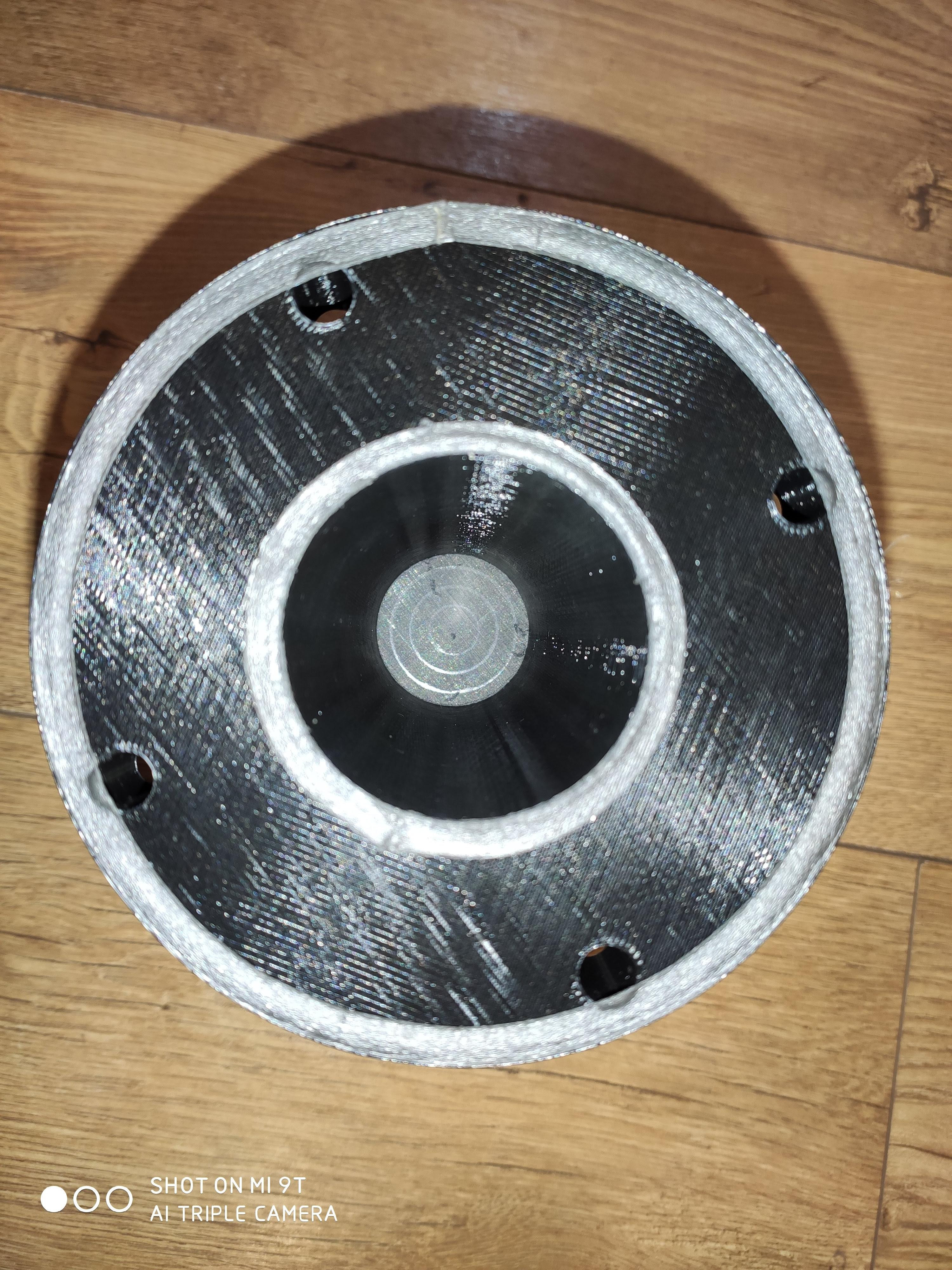

                  The compression driver (JBL 2452SL) on my 3D printed horn interface that matches the exit angles of the driver (1.5 inch exit) to the horn (2 inch throat)

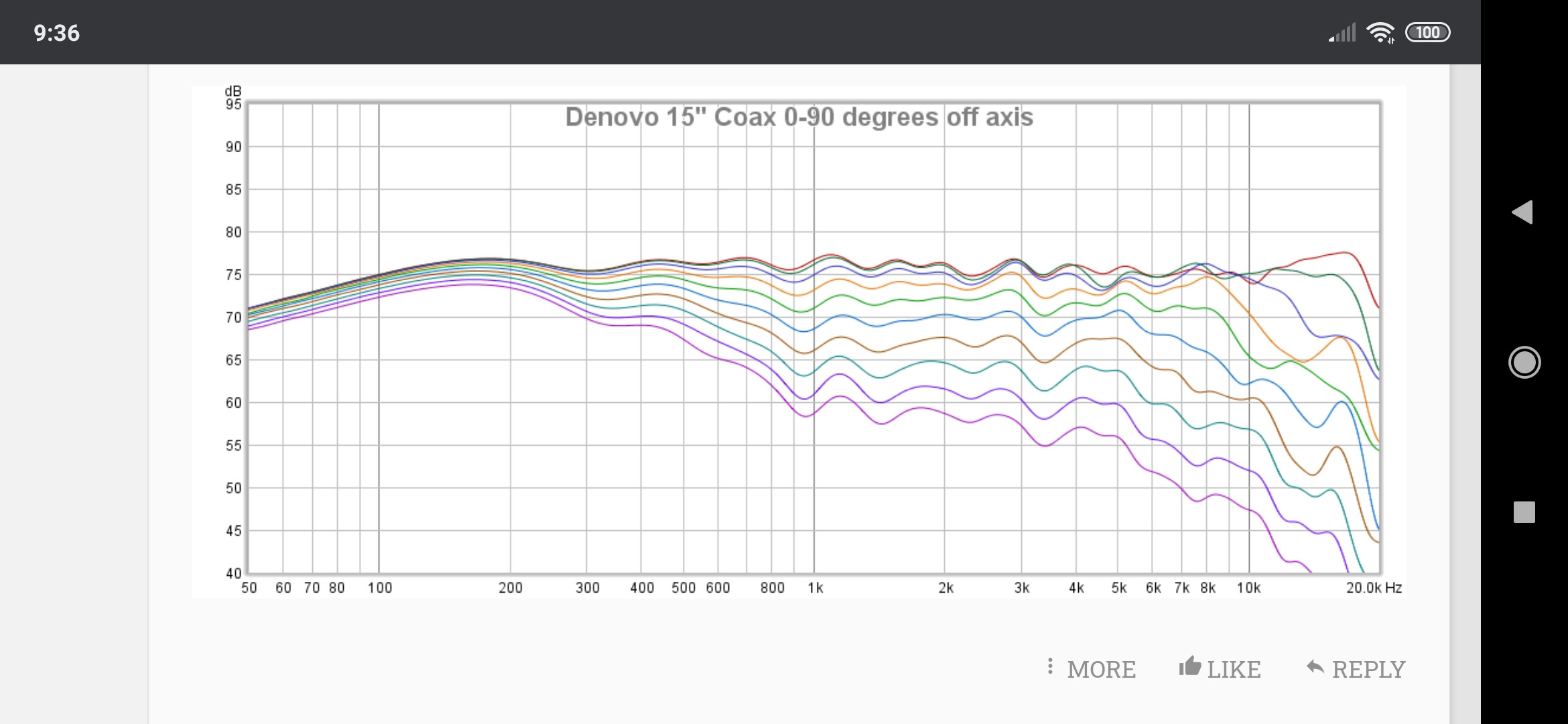

                      An alternative may be the Denovo CX15 coax driver, but unless I get some distortion data on it, I cannot go with this option.
                      That is quite impressive though, especially as its a Coax, as this is the same for vertical as it is for horizontal!8O
