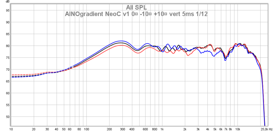

                                    Actually Neo3 holds up extremely well, Neo10 low end is more in trouble. I have LR2 topology mostly, but LR4 is also ready for the "audiophool" friends who crank up volume!
                                    • Scottg
                                      • Nov 2006
                                      • 335
                                      -even the low order slope in your graphs is still about -26 db from the average at 1.5 kHz. So it's not surprising that it holds up well in this situation.
                                      ..but verticals do suffer in comparison to a design with a crossover near 1.7 kHz. ..and some people are more aware of this than others (..I can't stand most of the MTM designs I've heard because of vertical "suck-out" - even when listening within the reference "window").
                                      (..btw, nice use of the omnimic's polars!)
                                      • Juhazi
                                        • 239
                                        Thx, I transported REW measurements to unregistered version of OMNImic, it just took some trials to find right format!
                                        LR2 slopes are practically elliptic/duelund acoustically - get steeper way past xo point.
                                        Vertical lobing depends on xo topology very much. I have had tens of different xo versions, but never have I heard lobing in normal listening situations. -15deg means below my waterline when sitting and +15 hits my ears when I stand at spot. With dsp it is easy to aim the main lobe by adjusting delay of the tweeter. Dipoles radiate so much ambient sound that direct/reflected ratio is low at over 2m distance - it helps too.
                                        Actually I was conserned about setting xo above 3kHz, but it sounded fine. Even 4kHz LR2 is ok! LR4 gives higher Q for the nulling effect.

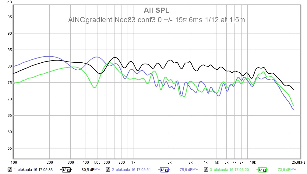

                                          • Juhazi
                                            • 239
                                            I guess it was "Export measurement as text" and I had to delete first two lines from the files created by REW. Before export I had to set gating and smoothing. File name must contain number of off-axis angle. Without +/- prefix OMNImic uses same files for L and R.The files are on my old computer...
                                            The unregistered version cannot save it's own measurements.
                                            ARTA can create directivity spectrograms too, but takes more time to learn that I can give... dumbass!
                                            I measured +/- 15deg verticals again and listened, and I can clearly hear the change in pink noise sound when I stand up! Far off-axis balance is however ok, with some loss of treble of course! All LR2 xos, MT at 3.6kHz. With dsp it is easy to set different topologies, Minidsp 4x10HD has 4 presets.

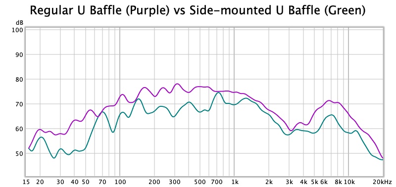

                                              The side mounted woofers are a no go. I did some proper measurements today.
                                              The output is lower with two drivers than one in a regular U frame, and no radiation advantage I could see.
                                              Drivers were RS225s in a 30 x 30 x 30 frame. No top.
Name:	U vs Side.jpg

                                                • sfdoddsy
                                                  • Sep 2000
                                                  • 496
                                                  Sorry, 30 x 30 x 30 U frame. Same distance.
                                                  The results I got were very close to what Edge predicted.
                                                  There's no top because the layout I had in mind didn't have room for one.
                                                  But I can plop one on and see what happens.

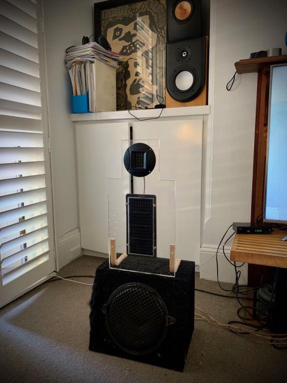

                                                      Well, I've done a bit fiddling, listening and measuring and decided to go fully active with the Neo 3 and Neo 10 in a stepped perspex baffle.
                                                      This is the test baffle. I'm currently using sealed Peerless SLS in boxes I had lying around below 300Hz, but may go OB with them too.

                                                        Looking good! (=transparent ) For final version you can try to get M and T closer vertically. Angled shoulders in the baffle? Any measurements done yet?
                                                        • sfdoddsy
                                                          • Sep 2000
                                                          • 496
                                                          The perspex baffle is actually an old one I had hanging around for a different tweeter, so I would indeed be nudging the Neo3 and Neo10 closer together for the final one.
                                                          However, I flop whilst listening so my ears are at about the level of the Neo10. I did some verticals and in the narrow window of my head lolled and perked up there appears to be few issues.
                                                          I have heaps of measurements, but in all honesty they weren’t significantly different from my last speaker using the same drivers in a trapezoid baffle. The stepped baffle has a few more ripples up close, but the amount of EQ required is similar.
                                                          Off-axis measures slightly more dipolar, but it could easily be measurement or measurer error.
                                                          I’m still tweaking the MiniDSP settings so am happy to do any measurement you’d like.

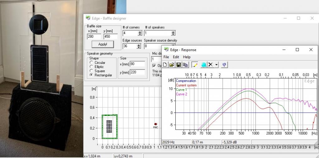

                                                            Oh nothing specific in my mind. Here is Edge sim of on- and off-axis respones roughly 20 and 40deg
Name:	steveneo10 eddge.jpg
                                                            • sfdoddsy
                                                              • Sep 2000
                                                              • 496
                                                              That's not far off what I got with my Edge sim and my measurements (the actual baffle width is 275mm). The dipole peak was a tad higher and a bit lower in intensity. A similar MiniDSP cut and then 12db boost as I used with my previous OBs has the Neo10 flattish to 100Hz or so.
                                                              I cross to the bass drivers at 300.
                                                              The sims for the tweeter were less useful. Both the sensitivity and the FR were wonky.
                                                              I imagine it would quite tricky to blend them with passive crossovers.
                                                              I've tried crossing my pair passively before and don't have the skill or patience to do it properly.
                                                              Since I have adequate amp and DSP capacity it is just much easier to go that way.

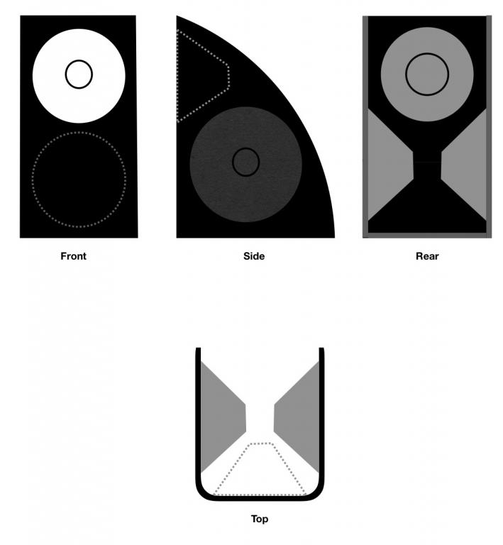

                                                                After a few more tests, I've decided to go OB all the way.
                                                                Since I have enough of the SLS 10s hanging around, I may as well make use of them.
                                                                So I'm doing a 3 way stepped baffle with a pair of SLS10s a side in a SLOB/W baffle.
Name:	Stepped Neo baffle.jpg
                                                                The interesting bit will be the crossover. I can do it all active with MiniDSPs as I have previously, but I'm also going try a 3 way passive crossover with MiniDSP EQ.
