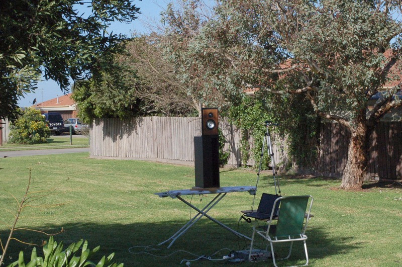

                                              In any case we've had few good runs on great weather so I hope to conclude and post this project soon!
                                              A bit tricky as it seems everyone and his dog went out and fly their planes on such weather. And I meant stop taking measurement every minutes or so 8O. I live about 20km from a small airport and Bonbeach seems to be their favourite run. Must be nice from up there but I also get to understand what frequencies these planes drone at.
                                              Last edited by theSven; 03 May 2023, 20:50 Wednesday. Reason: Update image location
                                              gainphile.blogspot.com
                                                • 1678
                                                I have also taken to repurposing ironing boards for such endeavors, I highly approve! Nice spot for measuring in though, the planes aside.

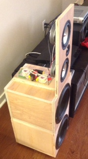

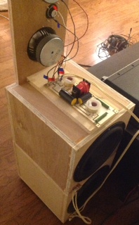

                                                                                        Some pics
                                                                                        So, I deviated from the original some. Upper portion is same equalized with miniDSP for dipole roll off. Lower bass portion I tried the dipole bass array in W frame but I wasn't particularly satisfied with the SPL and extension, so, I tried an experiment for kicks. Built 4 cabinets and put two 10" Dayton DVC subs on front and rear baffle of each in push-pull configuration. Wired in parallel/series for each cabinet (1x1) so each sub is wired in push-pull parallel (4ohm), and the total cabinet for two subs is wired series at 8 ohms. Each stack is wired in parallel to get 4ohm total for each side, with a Crown XLS amp running in stereo mode and equalized through MiniDSP with Linkwitz transform down to 20hz with .5 QTC, and 2nd order LR low pass filter with 180HZ roll off, its a decent transition with plenty of tight, distortion-reduced bass. Used software to calculate LT filter after having two 10" DVC subs in a very small box and keeping xmax just within limits of power handling to lowest frequencies. Wiring out of phase in push-pull creates a dipolar pattern but overall, it feels like more constant punchy amplitude down to low frequencies. Very controlled bass here, nothing flapping around with heavily reinforced cabinets. Note: these have not been measured but my ears are pleased so far. I could be delusional with this bass array but it sounds great and gave me ample practice on my new table saw. Measurements and further equalization to follow.
                                                                                        What I might do? Put these MTM's in a box for rear surrounds, and try the Zaph MMTMM kit in an open baffle design with existing bass array for better vertical controlled directivity and to minimize room nodes across the entire range. That would make a big speaker with big sound.

                                                                                        • wmcarpenter
                                                                                          • Sep 2012
                                                                                          • 5
                                                                                          Well, I've learned a lot since first starting this build. A few failed experiments, a few important realizations when trying to connect theory with real-world (measurable) results, but most of all, I've learned that there is so much to learn, and this is a hobby I'll probably keep doing for a lifetime. Thank you gainphile (and everyone else) for sharing your ideas and designs with a most grateful community of "sound" architects; both novice and experienced.
