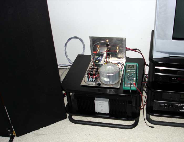

    well, i have my prototype class d amps built and running! im listening to them to see how i like them and if they are a good match for my system.
    they are build off of the UCD400 modules from Hypex. so far, they sound great.

    Looking good Rob ..... :T
    Nice to see you've got a manly power supply ....
    • Cowanrg
      • 225
      these chumps are recommending like 330va or 500va transformers for this amp.
      screw that, i dumped in a 1.7KVA transformer for each mono 8O
      i dont mess around. they are actually sounding REALLY good. im not like one of those "OMG class D is the future!" guys yet, bit its impressive what this little module can do.

                  i just downloaded the manual for the ucd400, i'm amazed i think that even i could put together a couple of nice monoblocks. besides the power supplies are there any tips or special parts that you used or recommend?
                  I doubt that i will ever build one of these but its really cool knowing i could (i think).

                    • TacoD
                      • 1080
                      If you follow the connection diagram of Hypex, you get with almost no effort, a nice amplifier. I have build Hypex ucd180 for a friend.

                                    I have three stereo UcD 400 amps, so I have some basis for comparisons. I've gotten good dividends by going a little further than the basic PSU. Best PSU caps I have tried out so far aren't the most expensive ones, Nichicon KG Golds, from Michael Percy ~$7/ea (4,700uF) iirc. I use two per rail with dual mono designs.
                                    I got some IXYS bridges, can't say they made a huge improvement but for $16 it was worth testing out. Bypassing the bridges with .022uf caps made a larger improvement, IMO. I also bypass the Nichicons with Jantzen .1uf and .01uf caps and then a snubber after that. Sounds a treat.
                                    • Cowanrg
                                      • 225
                                      hum. yeah, those caps are $8 each. i would need 4 of them per channel. and im planning on making these stereos too. i wonder if he would do a quantity discount on a bunch of them... it might be something to try, ive heard that nichicons are a great value and its hard to get a significantly better sound without spending 4x more money.
                                      im not sure what i will do for a bridge rectifier. i might get some nice diodes or something, but im not sure yet. one of these days ill get downstairs and put the power supply on my scope and look at it with different configs, or listen to it. its just so tedious.
                                      i do plan on using bypass caps across the rectifier, and it seems pretty universal that it makes a good improvement in the sound.
