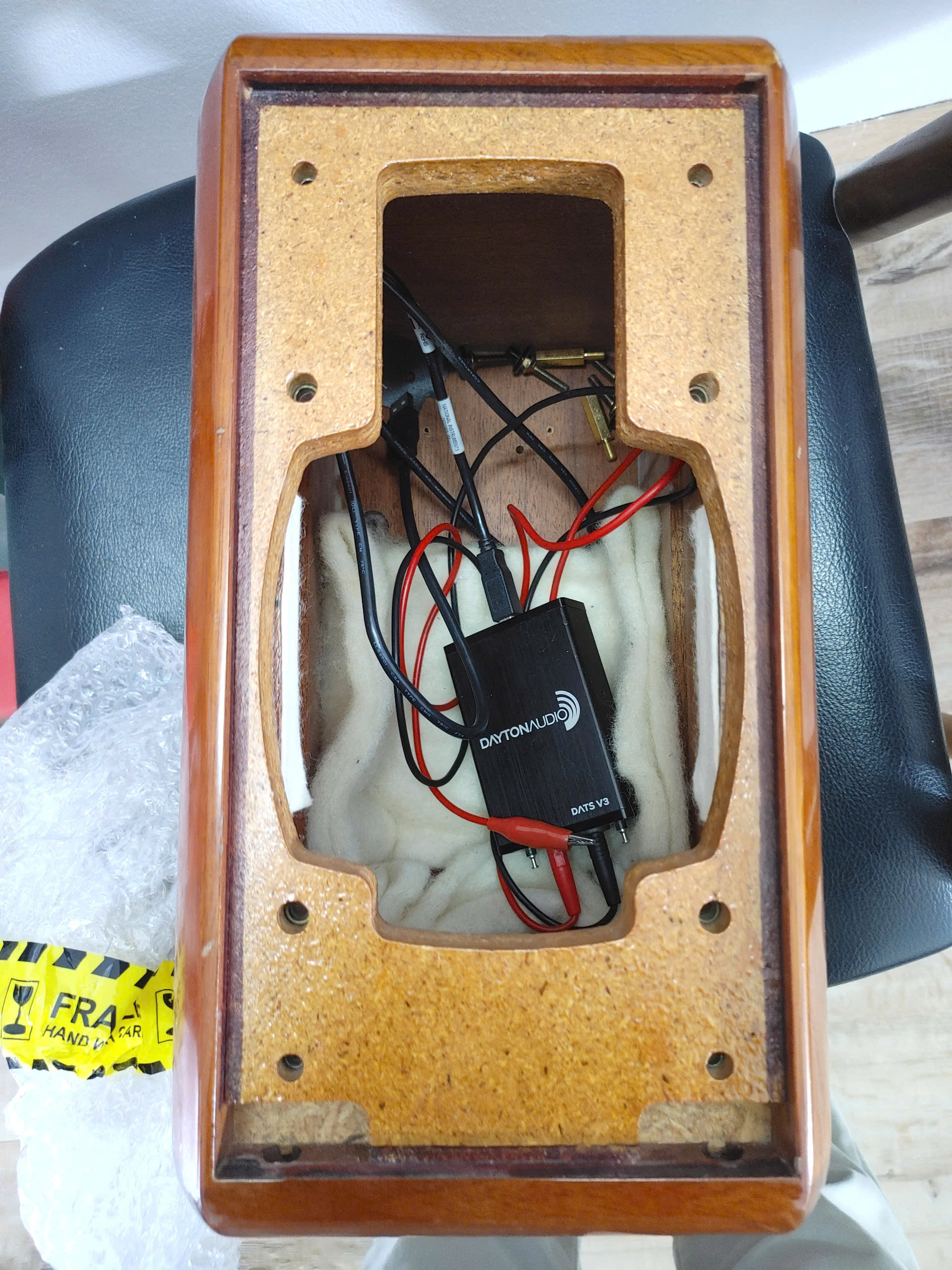

    The starting point is the warehouse on the top floor of my house where the almost finished speaker cabinet is kept. Back about 10 years ago, the speaker was bought by my cousin from Japan - he is an automotive engineer, a powertrain designer and a permanent resident in Japan. He often bought components for me because Vietnam used to have few official distributors at that time.
    The original speaker cabinet is handmade in Japan from mahogany, for the sides, top and bottom. Its external dimensions are Width 200x Height 343x Depth 263 mm. However, with the 25mm thick edges, its internal volume is only about 8.5l. The front panel is removable and originally made of brass with dimensions Width 149 x Height 299 x Depth 10mm. Because of the small volume, I have had difficulty for many years in choosing 5in mid woofers, they usually require a larger volume to be able to produce bass. However, the speaker cabinets are finished quite nicely so I have always kept them waiting for the opportunity to come to me. Recently, I found the SB15CAC30-4 seemed like a suitable choice with a volume of 8.5l so I bought one to test and continue this project. They will be for my 7 year old son for Christmas. He needs speakers for learning English, studying online via Zoom and listening to music. Therefore, in addition to being a gift, of course it will be my task.
    The idea I came up with was to provide the SB15cac with a passive radiator in a speaker cabinet of about 8,5-9,5l. Since the front panel is removable, I can change the volume a bit. The passive radiator I'm looking at is SB15SFCR-00. The PR I have on hand is the Wavecor PR182BD01.
    The tweeter I'm planning to pair with the SB15CAC is the Seas 27TBCD/GB-DXT. I have many other tweeters but I read about Mr. Jon Marsh's "PSD Modula" that this tweeter is suitable for 83-85dB applications so I think it's suitable for the SB15CAC
    Thanks to Jon Marsh for agreeing to help me with the PR optimization, but I'll still try to implement it myself while he handles more urgent projects. And once again I really appreciate your comments to complete this little project.

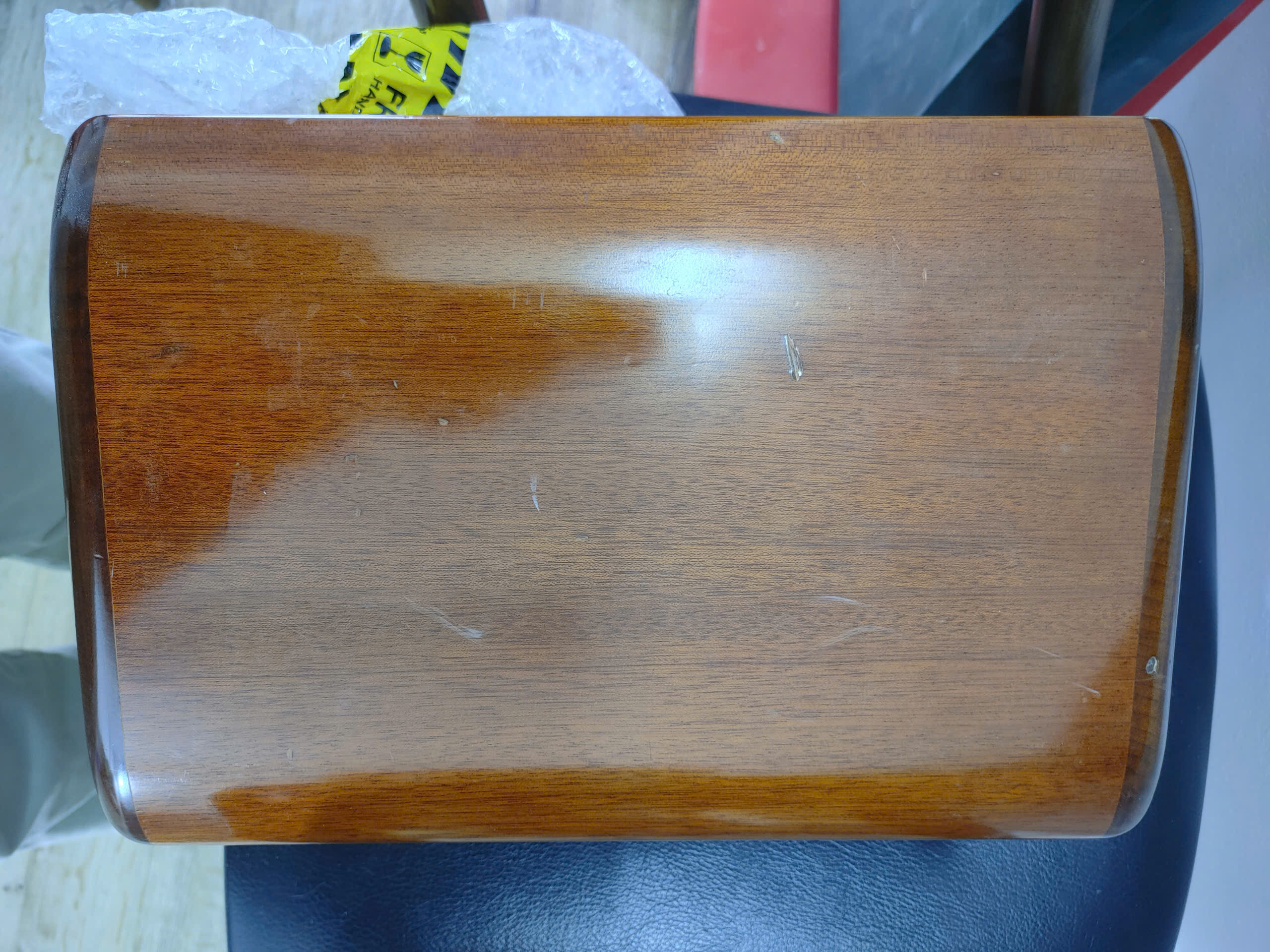

    Below are pictures of the speaker cabinet as they came out of the warehouse. They have a lot of scratches, they are the result of a few house moves. The first thing I need to do is sand off all the old paint and re-sand the wood to remove as much of the scratches as possible.
ID:	955400 Click image for larger version

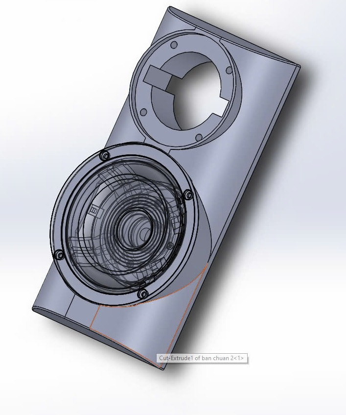

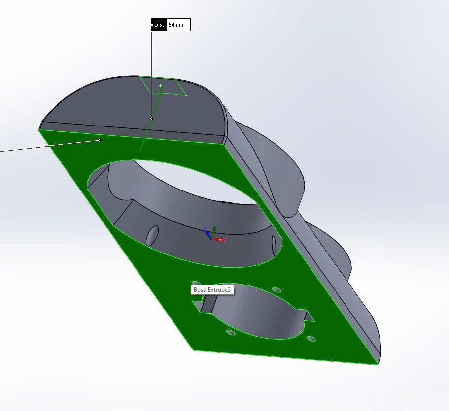

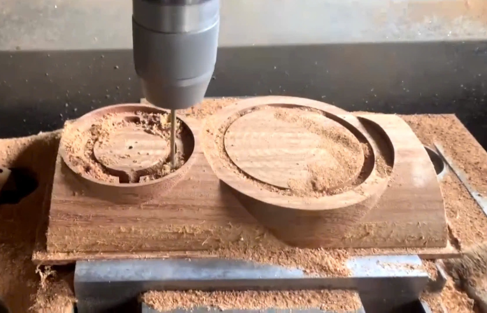

            One task performed while waiting for the oil to dry is to create the shape of the front panel. As talked with Mr. Jon from his Modula PSD project, I edited to make them suitable for SB15cac and Seas DTX.
            Click image for larger version  Name:	6c1a9fd1daba61e438ab.jpg Views:	0 Size:	138.4 KB ID:	955479
            One trick I did to speed up the process was to buy bamboo from the chopping board product in the supermarket. The cutting board is 32mm thick and I will combine it with a 15mm sheet of baltic plywood to get an overall thickness of 47mm. Then 7mm will be inside the 2 side edges and 40mm is the outer front panel that needs to be CNCed according to my idea above.
            Click image for larger version  Name:	3ef930c01915a24bfb04.jpg Views:	0 Size:	594.6 KB ID:	955480

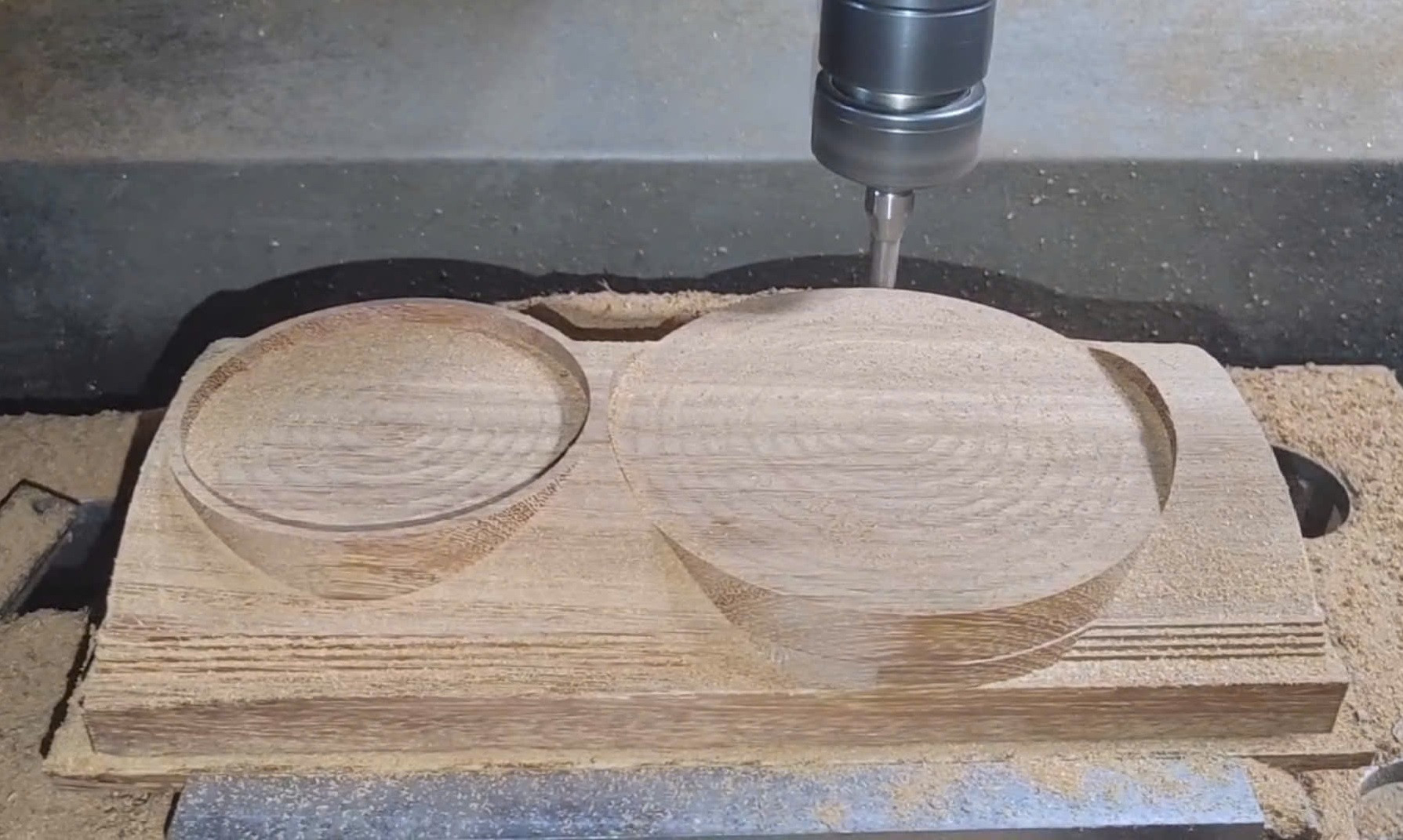

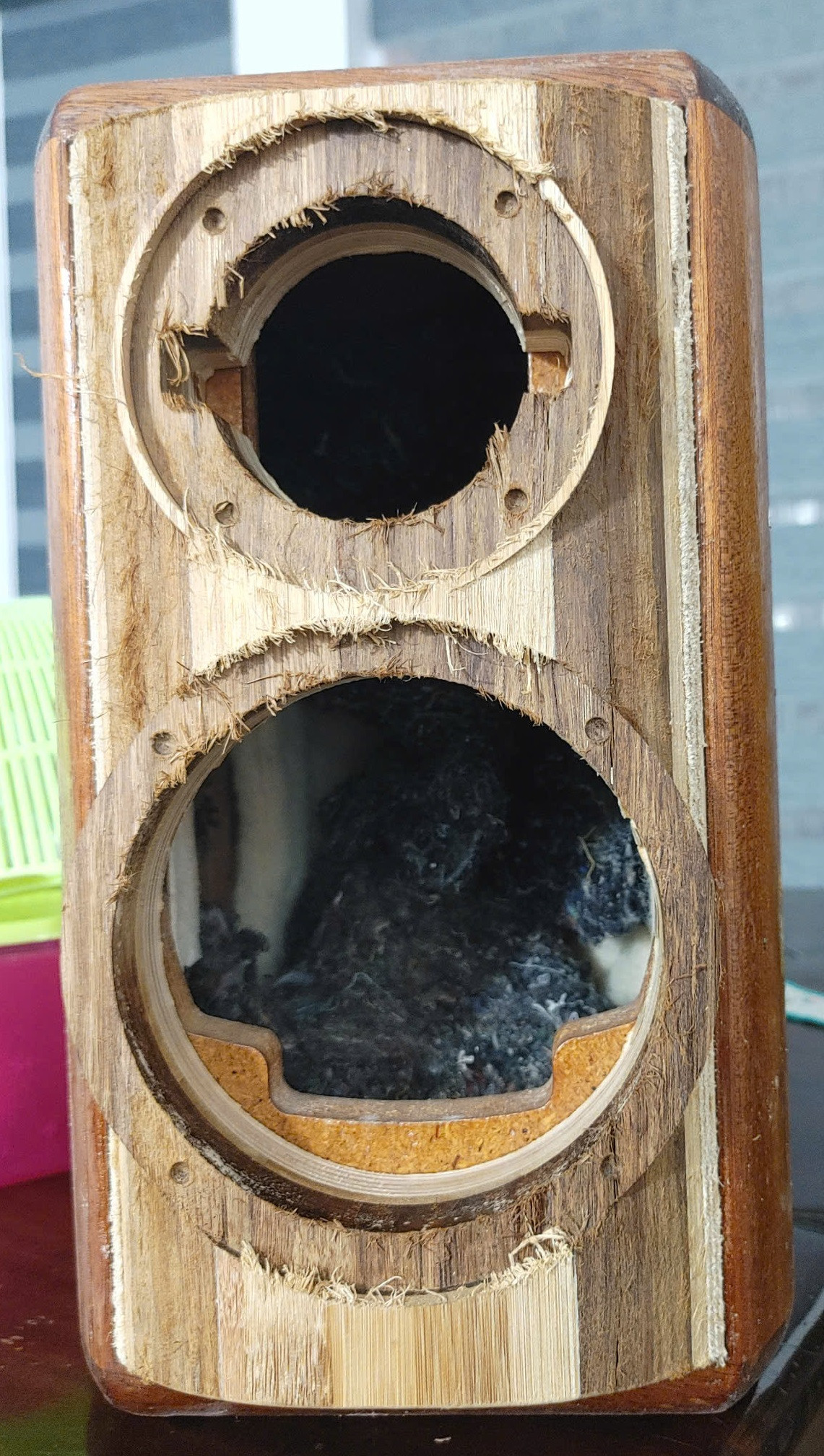

                My "trick" didn't work as expected, the compressed bamboo layer in the middle cracked during the CNC work - or maybe they had already cracked. They looked very unsightly so I decided to leave them aside.
                Click image for larger version  Name:	c30d1fdc55ecefb2b6fd.jpg Views:	0 Size:	766.6 KB ID:	956446

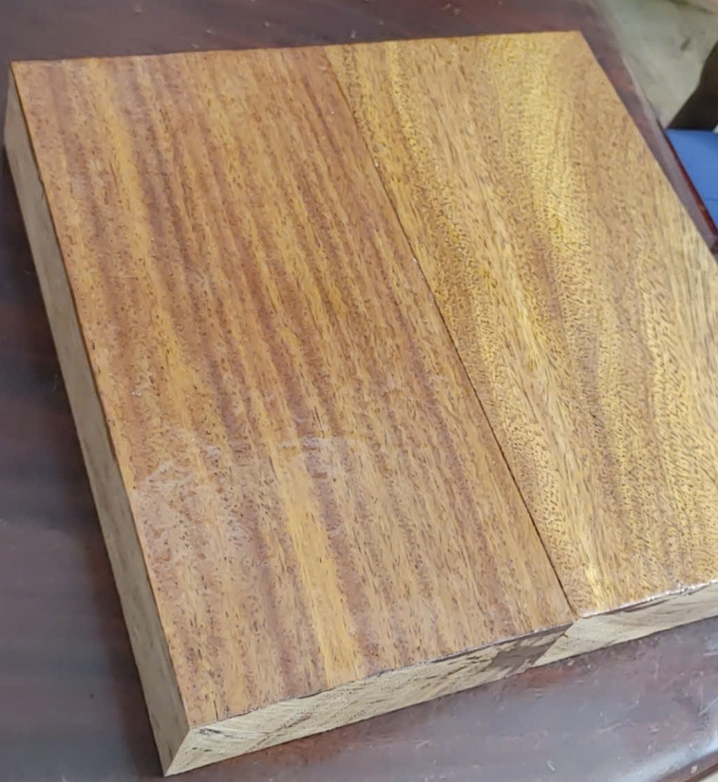

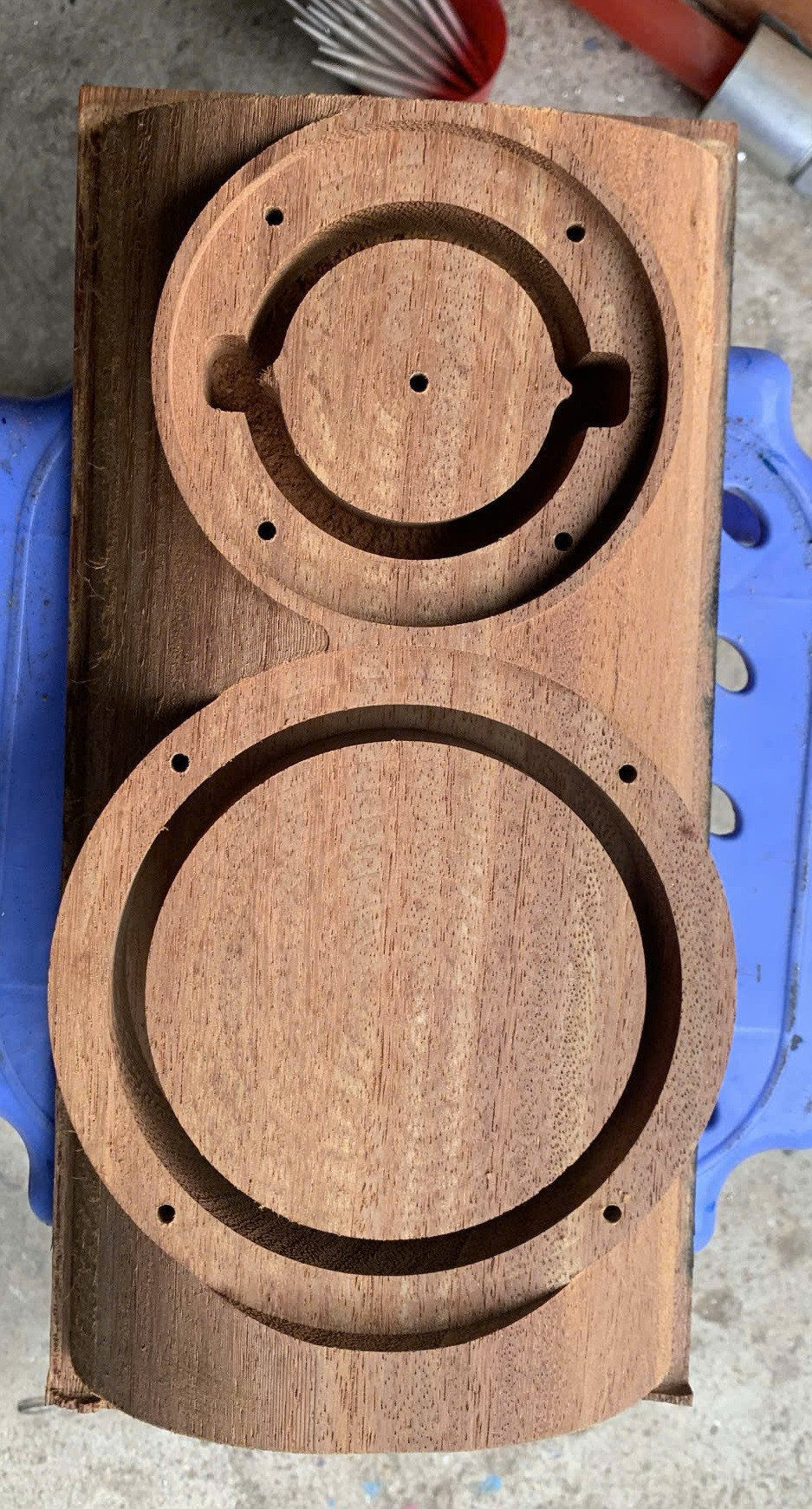

                In parallel with the "bamboo cutting board trick", I asked another brother who is a carpenter to find 2 pieces of hardwood for the front panel. After hearing what I needed, he sent 2 pieces of ironwood. According to him, these 2 pieces of wood have been treated and have a long waiting time - about 5-6 years, they will not have any cracks or shrinkage anymore. The work continues
                Click image for larger version  Name:	1ea2bda7-d9d2-47f8-a8d9-2986eb9720a8.jpg Views:	0 Size:	279.7 KB ID:	956450
                Because the thickness of the 2 pieces of wood I was given was larger than the original bamboo wood - they were up to 55mm thick, so the drawing needed to be revised.
                Click image for larger version  Name:	31312541-cbe5-4ebd-a32d-6cc5f07dd4e2.jpg Views:	0 Size:	117.7 KB ID:	956451
                Click image for larger version  Name:	660d9107-3aa5-465e-b820-5191277b116b.jpg Views:	0 Size:	88.4 KB ID:	956449

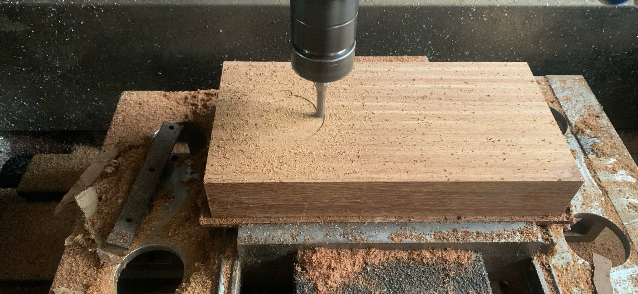

                The work of "sharpening" rough wooden panels is taking place again. After a high speed with many fibers, the speed was adjusted to a lower speed to get a more beautiful semi-finished product.
                Click image for larger version  Name:	8eb640b3-3cec-4d07-97d4-723ace1e20d3.jpg Views:	0 Size:	551.3 KB ID:	956453
                Click image for larger version  Name:	5848ec318b6d36336f7c.jpg Views:	0 Size:	378.1 KB ID:	956448
                Click image for larger version  Name:	e9c6b8b1dfed62b33bfc.jpg Views:	0 Size:	319.5 KB ID:	956447

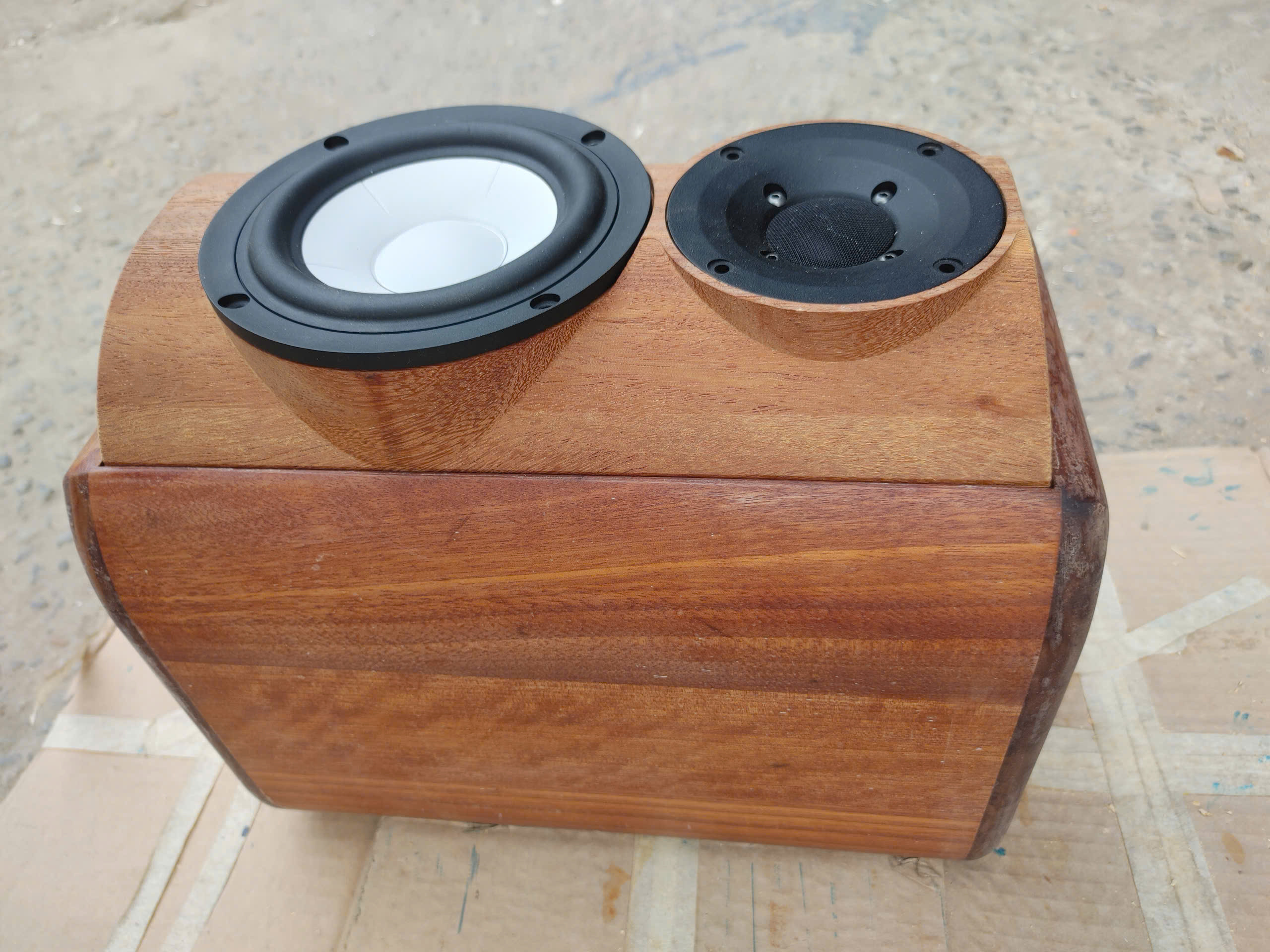

                This is the result right after removing the dust from the machine and placing it on the front for testing
                Click image for larger version  Name:	e5bba4420cf4b6aaefe5.jpg Views:	0 Size:	570.6 KB ID:	956452
                Luckily, they were a tight fit, waiting for screws and measurements.
                Click image for larger version  Name:	0f79f6c3-bff7-492d-a3d8-19760577aedf.jpg Views:	0 Size:	741.1 KB ID:	956454

                  Excellent CNC work on those baffles, and great colour match of the wood as well! The design is reminiscent of B&W woofer cabs, and I may borrow some design elements here for my own future projects.
                    Master of None
                    • Jan 2014
                    • 1661
                    The baffle is gorgeous indeed! I have never heard of ironwood before though, which is rather funny since it is a town in Michigan and I had to learn about many trees in my youth. Somehow that term never came up. None the less I'm looking forward to seeing this speaker finished and you can share the listening experience.
                    Painter in training
                      • 2132
                      Very nice ...... I hear ironwood is very hard on tools.

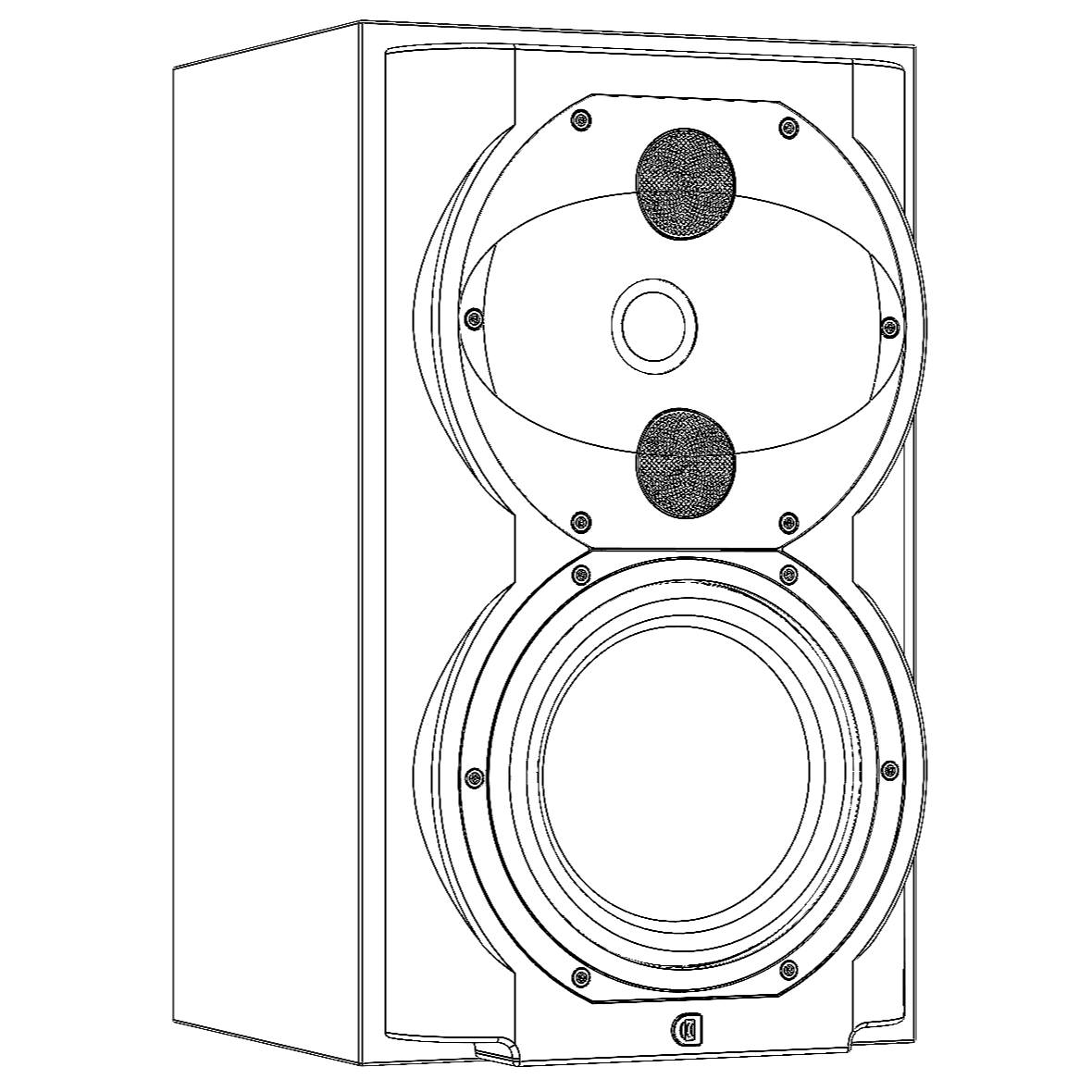

                        thank you. the idea of ​this speaker appearance comes from Kii three btx and Perlisten S4B. i am very interested in the control and dispersion of sound waves the tweeter produces. with this front panel, i hope it helps the Seas dxt perform well in dispersion of sound waves. i am happy to share the 3d design file if you are interested.

                          I paid for a new drill bit, which I will use every time I do wood CNC service at my local supplier. However I was told that ironwood still seem softer than bamboo. When CNC on bamboo wood, the CNC supplier broke a drill bit.
