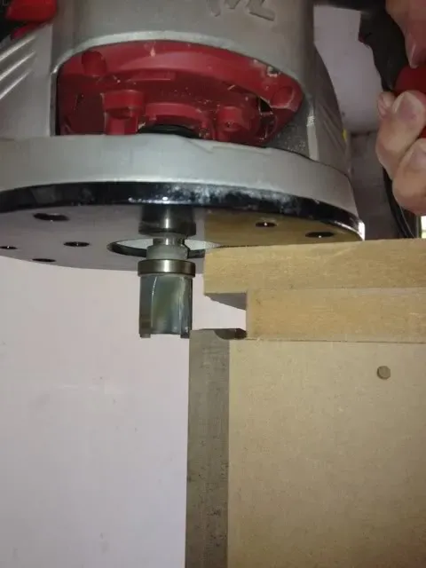

                                                                                    • 70
                                                                                    Originally posted by Mark_1042
                                                                                    Trimming Off Excess Material:
                                                                                    After all the panels were on, I trimmed off the overhanging material. This was covered in one of the recent build threads, but the overhang on the front/back edges can be trimmed off using a straight cut bit. I used double sided tape to position a strip of 1”X2” on the front and back panels, and this allowed me to come down on the overhang with a 1/2” straight cut bit. For the extra material on the top/bottom edges, a flush trim bit can be used. I don’t have any picture of these steps, but I’ll try to get some and add them later.
                                                                                    Can you try and explain this process a little more? I'm not following, and am trying to figure out how this is done
                                                                                    • Mark_1042
                                                                                      • Apr 2012
                                                                                      • 151
                                                                                      Hi Ntruder,
                                                                                      I borrowed a picture from another build to show you what I mean. In the picture below he's stacked up two pieces of MDF to put his router on - this gets the router elevated so you can plunge down on the overhanging material (or come across it) with the end of the bit. In the pic below a flush trim bit is being used - this is the safest way to do it because it keeps you from plowing the bit into the MDF that the router is resting on and gives you much better control, but you can also just use a straight cut bit which is what I did.
                                                                                      I used the method shown above to trim the overhanging material on the front/back edges. For example, to trim off the extra material on the corner where the side meets the baffle, stack the MDF on the baffle face and come down on the overhang with the end of the bit. I should also note that you don't really want to try to get it flush as it's fairly easy to take too much off - just get it close and use a sander to bring it flush.
