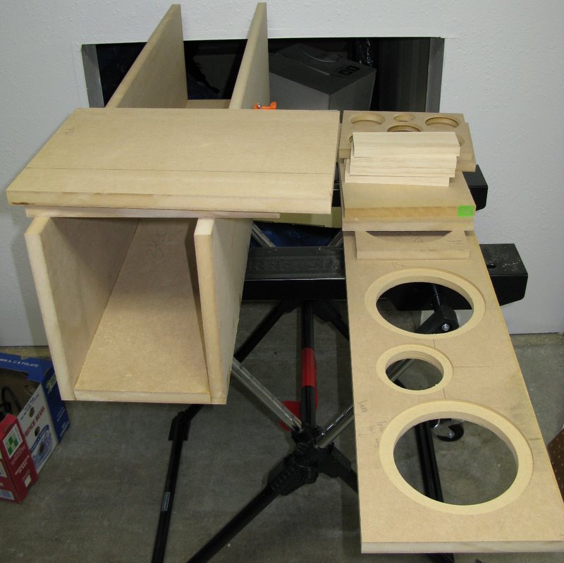

    Well, I have been working on this build for about two months now. It has been a series of firsts for me since I have only previously built a 20" cube sealed subwoofer. First time using a radial arm saw, first time using a router, etc. So far it has been a lot of fun with only a few mishaps (MDF being the victim).
    I started by spending a good afternoon making test cuts on pieces of scrap plywood to make sure the saw cut square. Once I felt comfortable with that I went and began ripping the sheets of MDF to size. I figured with my girlfriend's help we would have no problem doing full length rip cuts using my radial arm saw (wrong! - mishap #1). It turned out to be a little awkward and the saw blade actually became bound about 1/4 of the way through the cut. I gave up on that and just decided to make the long cuts with a circular saw and a 8' fence piece. This worked better, and since I made all the cuts with 1/2" excess it didn't matter much that I didn't set the baseplate of the circular saw at a 90 to the blade (mishap #2). I squared everything up on the radial saw and left 1/4" excess on one side of the baffle and the top piece that would be flush trimmed later.

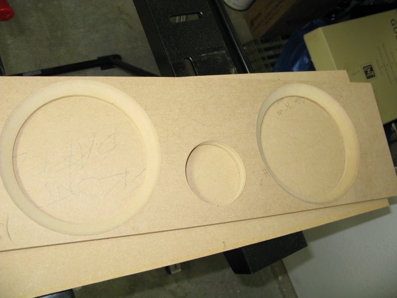

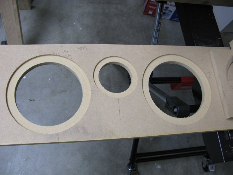

    I then went ahead and used my new Hitachi plunge router and Jasper circle jig to cut all of the speaker openings. I was pretty happy with the outcome at the time, but I will go into this a little further later (hint: mishap #3).

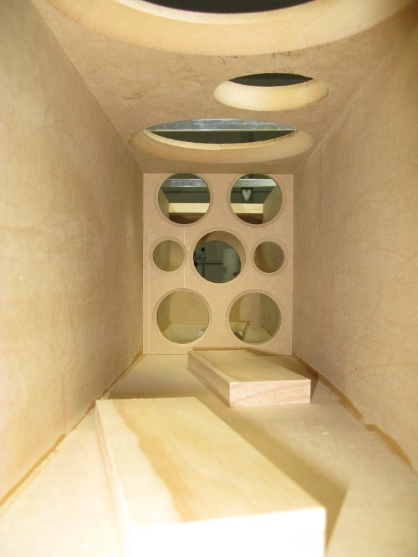

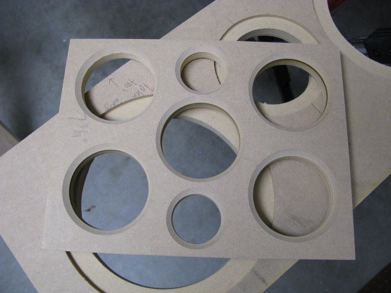

    I then transferred the holes to the inner baffle piece using a flush trim bit and did a 45 degree chamfer on the backside. No problems here. Hopefully this will help the woofer breathe. 8)

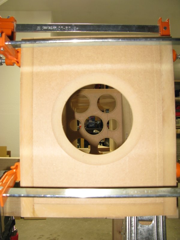

    Finally I used various hole saws and a 45 degree chamfer bit to create the mid brace. This along with some 1.5" wide pieces of pine will brace the cabinet. By the way... R.I.P. 2 1/2" hole saw from Lowes. MDF along with my woodworking skills seems to spell quick death for these things.

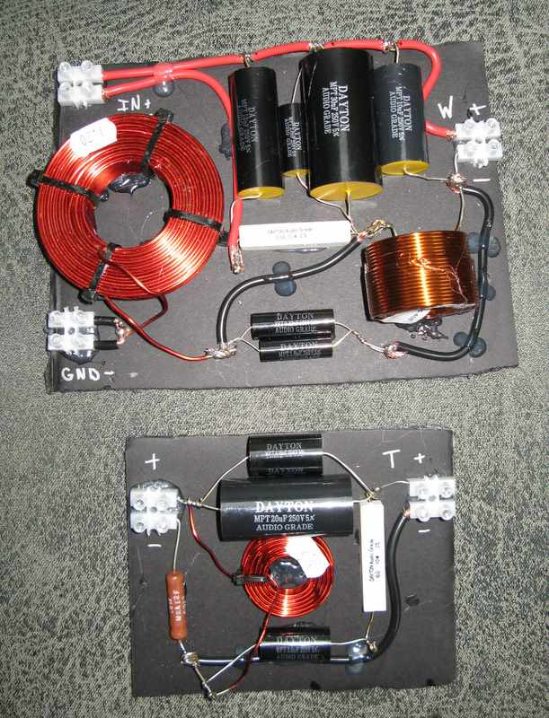

    Crossovers

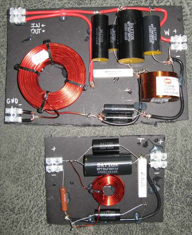

    At this point I took a break from the woodworking portion of it and decided to build the crossovers. I took two quarters of electrical circuits in college, so this wasn't too out of ordinary for me. One thing I did do is go out and get a Weller soldering iron to replace my Radio Shack one. It was a night and day difference.
    When I started the build I wanted to build a box without a removable baffle, so I built the crossovers on boards small enough to fit through the woofer holes. Don't worry, even though there are two boards per crossover they maintain the correct connections between the two boards as if they were on a single board. Since then I have decided to make the baffle removable, so it is somewhat of a mute point.

      Back to the box construction; I decided to dry fit everything to make sure I wasn't too far off anywhere.
      Everything came together beautifully!
      Pictures from the bottom of the box where the port will be located. I did a 45 degree chamfer around the hole to help me flush mount it. A roundover might have worked better, but I don't have a roundover bit at this point.

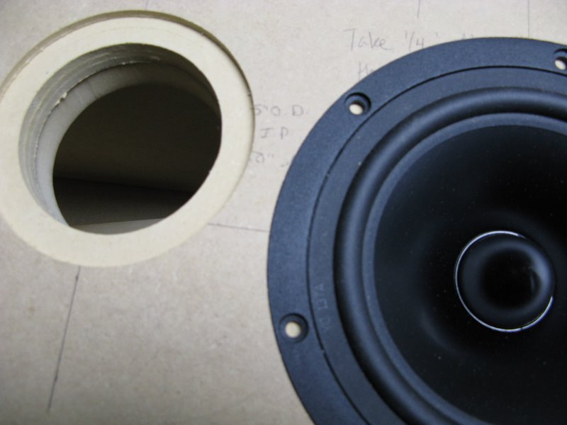

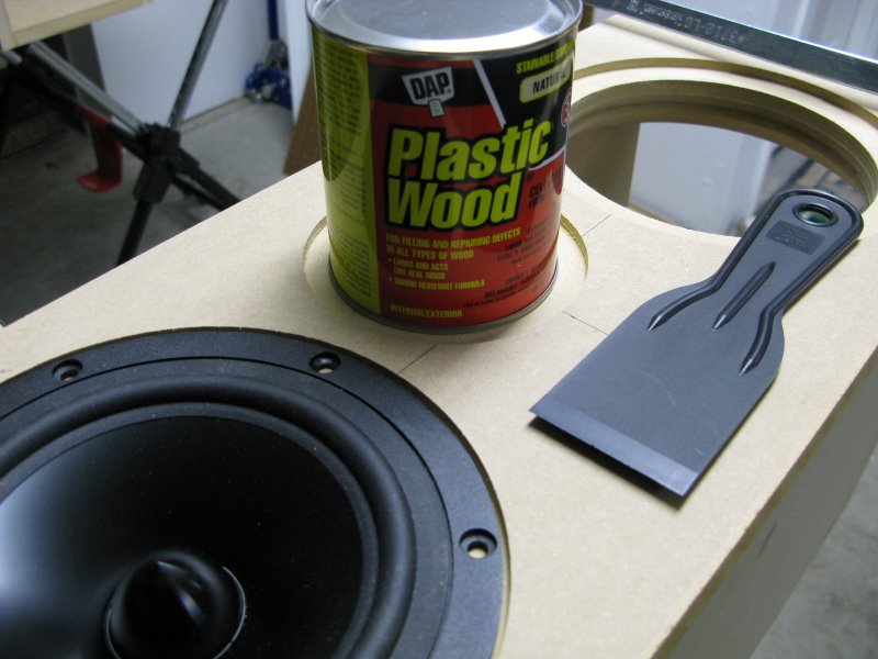

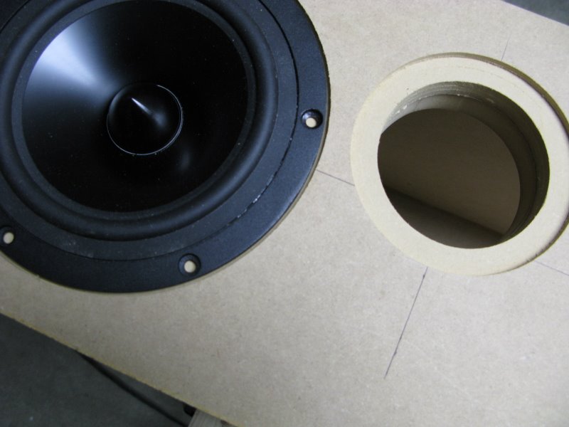

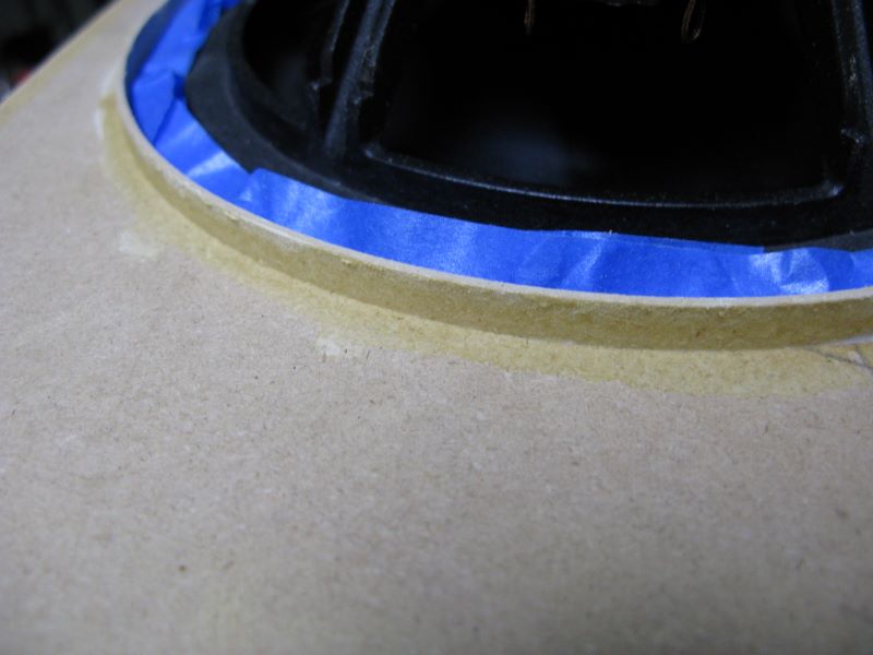

      Finally, on to the aforementioned mishap Blogs I decided to throw one of the woofers into the baffle to show my girlfriend about what it would look like. The woofer fit snug in the first cutout.
      Not so much the second...
      I am not sure what I did here, must have been 1/8" off when I selected the hole on the Jasper jig. Three of the four holes have this problem. :scratchhead:
      To fix the problem I went out and got some DAP Plastic Wood. It is a solvent based wood filler that I plan to fill the gap with.
      It may turn out to be mishap #4, but my plan is to locate the woofer centered in the cutout, apply blue painters tape to the surround, then build up 1-2 layers of electrical tape on top of that. The remaining gap will be filled with the plastic wood material. Once cured I should be able to pop the woofer out (hopefully the ring of filler material stays) and touch it up with some sandpaper. Worst case, I'll have to redo both baffles.
      I am going to tackle this project tomorrow morning. I'll post and update with how it turns out.

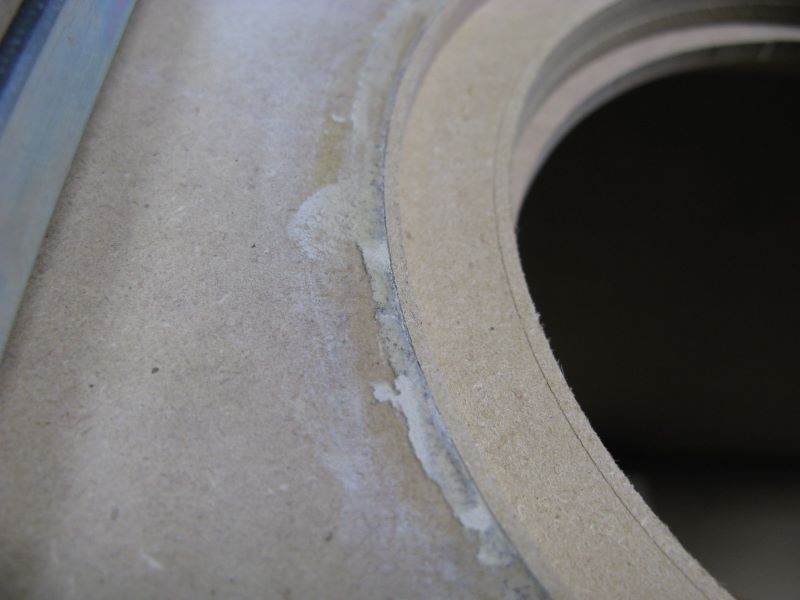

                    I think I was able to save both baffles using some thin strips of MDF. I'll post some pictures in about an hour once the glue dries. 8)
                    • fwrigley
                      • Dec 2009
                      • 21
                      Success. Both baffles were saved using MDF and wood glue by using the drivers to apply pressure to the MDF strips.

                      Here is a picture of the baffle I repaired last night. It still needs some additional filler.

                          My gap was about 1/16th around the entire cutout. The main reason I went to the trouble of filling it in was because the two cutouts were different. If they were both snug or both 1/8th larger I think it would have been fine. If you paint the baffle it will fill some of it in anyway. I am undecided at this point whether I am going to paint or veneer the front.

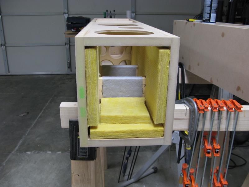

                                Insulation

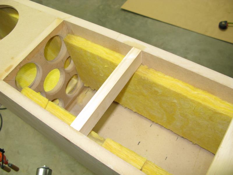

                                Tonight I added OC703 insulation to the boxes. 2" thick on the backwall, 1" thick on all others. I wrapped the braces in wool felt. I am not sure this will do much, but since I had some laying around I figured it wouldn't hurt. From doing a tap test the wool felt does attenuate the sound somewhat.

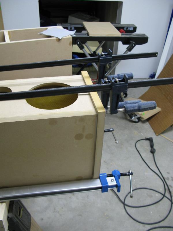

                                Once that was done I glued the top of the box on. I left a little excess on each edge and will flush trim it later.
