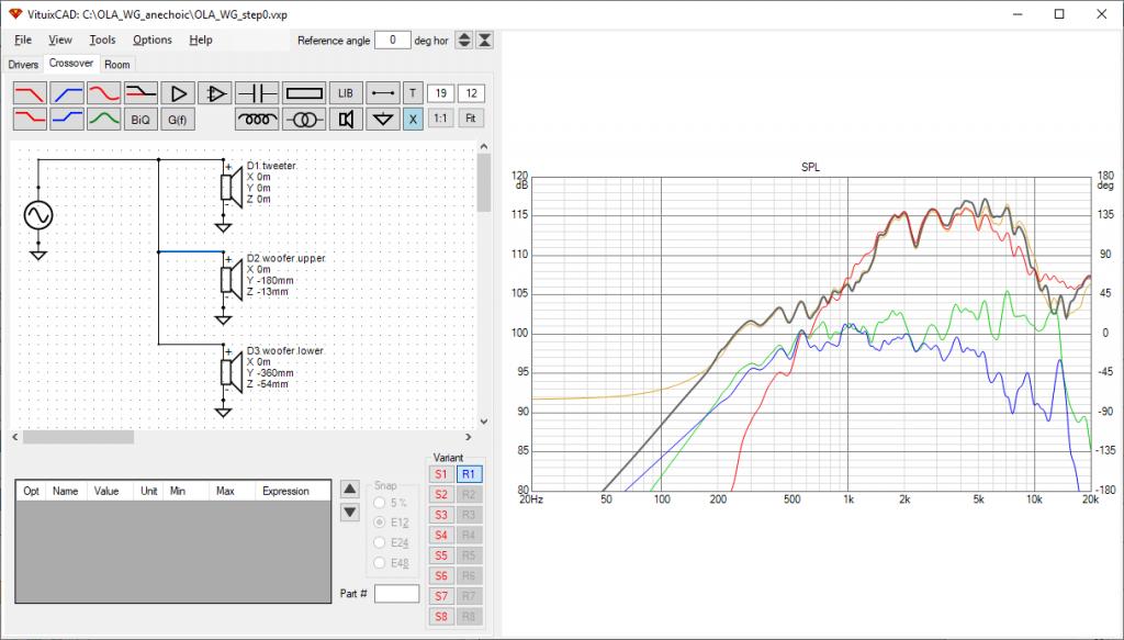

      I don't have the time to do a flow with screenshots today, but I'll try to describe process I've used for latest 2.5 way (it does differ a somewhat from Kimmos VCAD preparation doc)
      *I'm measuring all drivers on design axis at 1m without moving the microphone as driver spacing is relative small (for this project mic between the mid and tweeter in vertical axis as that's where the ear height is sitting on the couch)
      *I first set the amplifier output - in this case it was 1Vrms, so it was safe to measure tweeter without any protection capacitor. Best to play a test sweep with a midwoofer before connecting tweeter for test fo safety..
      *Then I set the microphone gain, so that the loudest driver (usually the tweeter) does not clip the input
      *Then measurements are started for tweeter - 0 degrees horizontal and then upto x off axis (best is until 180deg as VCAD expects)
      *Then I shorted the lower woofer and connected upper woofer for measurements and repeated the 0deg and all off axis. Shorting the other woofer helps to work a bit against it becoming a passive radiator.
      *Then I shorted upper woofer and measured 0deg and all off axis
      *Then connected Tweeter and upper woofer in parallel (lower shorted) and measured the summed graph. This one will be used for setting the Z coordinate in VCAD later
      *Then connected Tweeter and upper woofer and lower woofer in parallel and measured the summed graph. This one will be used for setting the Z coordinate in VCAD later
      *As a last measurement step a nearfield measurement is done on one woofer and port is there is one.
      With this all the measured data is collected. Now as VCAD has the nice 'Convert IR to FR' tool I use that to gate all the above and export the frequency response files as Preparation doc also guidelines.
      In VCAD under options one should now make sure that the "Listening distance" parameter is set to 1000mm as we measured at 1m and this is where we want to check the simulation match with measured curve.
      Next step will be to enter the tweeter data (freq. resp and impedance) and set the "Delay" vlaue on drivers tab so that the tweeter phase approaches 0degrees at 20kHz.
      NB! the same delay value must be used for upper and lower woofer later also.
      Now also the upper woofer data gets entered and the Y axis set to whatever is the real physical distancce of tweeter center to upper woofer center on front panel. This results in a summing curve. It is time to import the "Tweeter and upper woofer in parallel" measurement result as an overlay. There will be a small mismatch between measured and simulated curve. To fine tune it the upper woofer Z axis coordinate should be used for best match.
      Once above is done I add the lower woofer data and Y coordinate. Again it results in summing curve of the 3 drivers in parallel. Again an overlay will be loaded - this time the "Tweeter and upper woofer and lower woofer in parallel". Now a Z coordinate of lower woofer is adjusted until the match is as good as possible between the simulated and measured curve. Maybe upper woofer coordinate needs a small nudge to one or the other direction too.
      Below is an example image of the 3 driver summing and the overlay curve. Good match is found down to 250Hz. After achieving this there is higher confidence that the simulation will match reality.
      I will then continue pretty much step by step as the preparation doc describes for Merging the low end nearfield responses, baffle step simulation and 1m far field measurement. Once done I will replace the short gated response files for upper and lower woofer with merged data. Tweeter data is correct as is already.
      After this it is off to designing the Xover itself.
      PS. Please see also Kimmo's recommendation below that is to measure each driver on it's own axis instead as recommended procedure!
        • 698
        Attached a wrong screenshot.. this one is the one I meant

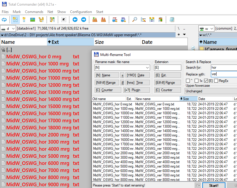

                            As a shortcut, if one was taking vertical measurements, can one not simply copy-paste (in Windows explorer) and just re-name the copied files with opposite direction indicator (i.e. change all the "+" to the "-", and vice versa? This should only take 2 seconds and will remove the need to take extra measurements of the second Mid. And follow this by specifying the correct driver location (i.e. Mid 1: x=0,y+75mm and Mid 2: x=0,y=-75mm in my example above).
                            I hope I'm not wasting anyone's time by asking such elementary questions. Most respondents here have actually built/designed speakers and have that practical knowledge. I, on the other hand, have only designed one simple 2-way, and thus can only approach this from a theoretical perspective. The genesis of my inquiry came from me researching the benefits of an MTM design and the importance of center-to-center spacing (between the mid and tweeter, and between the two mids) - and the overall ability of the MTM design to create a (relatively more) uniform response (compared to a typical two-way) in the verticle plane, or its ability to purposefully create a large frontal-lobe (with suckout/cancellation above and below the lobe) to minimize floor and ceiling reflections.

                            • kimmosto
                              • 723
                              Sure, that is the fastest method to produce perfectly mirrored vertical data. I haven't tested which file utility would be easiest for this. Also VituixCAD could have sign swapping for vertical angles, but value might be quite low.

                                  • 698
                                  I'm using Total Commander for such things (also free version will work), but perhaps there are easier tools
