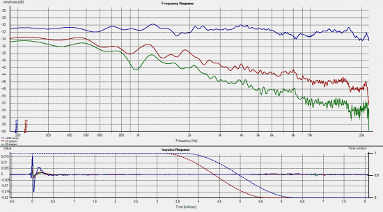

    Measurements of Kef LS50

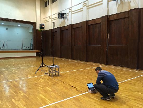

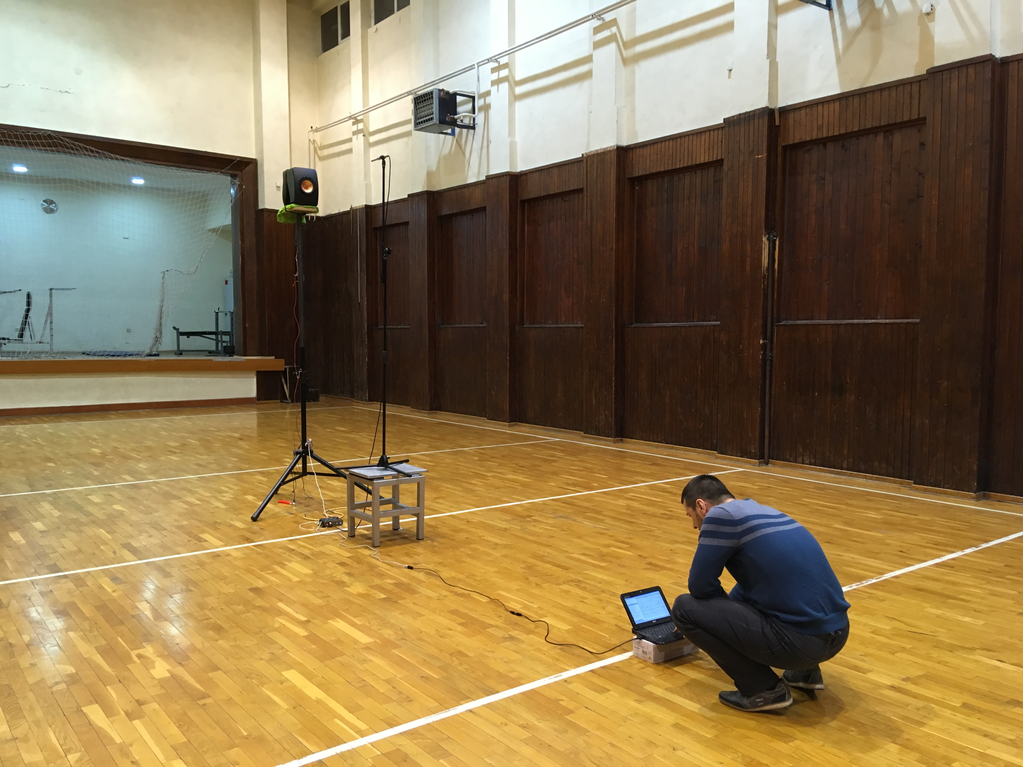

    On axis and roughly 30 deg off axis. Calibrated Behringer ECM8000, M-audio FastTrack USB, Holmimpulse. Gate is good to about 85-90Hz.
    Measurement conditions
    Click image for larger version  Name:	IMG-2671.jpg Views:	1 Size:	2.02 MB ID:	944798
    Midwoofer and tweeter

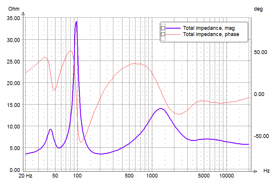

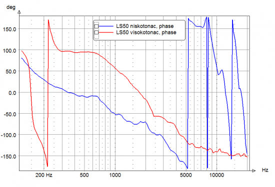

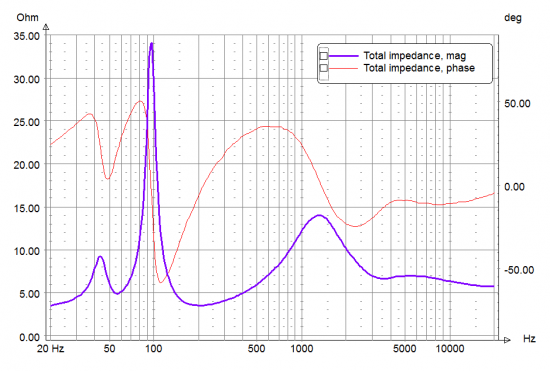

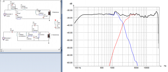

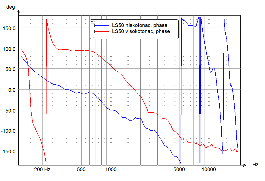

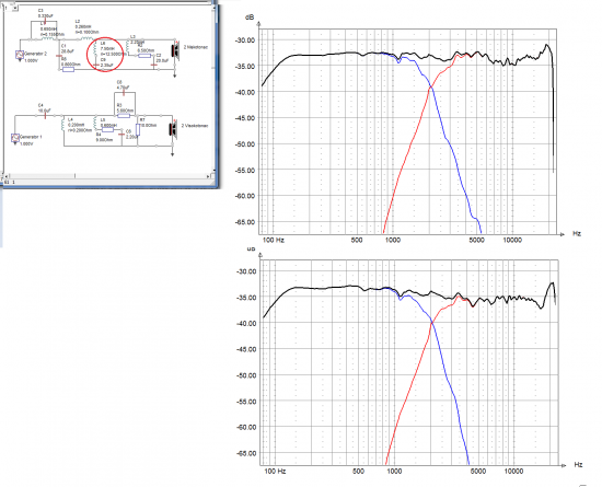

    Simulation of Kef's factory crossover> frequency, impedance and phase response

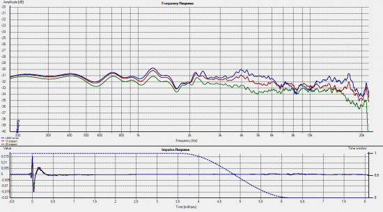

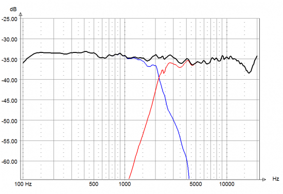

    Other LS50 measurements for comparison:

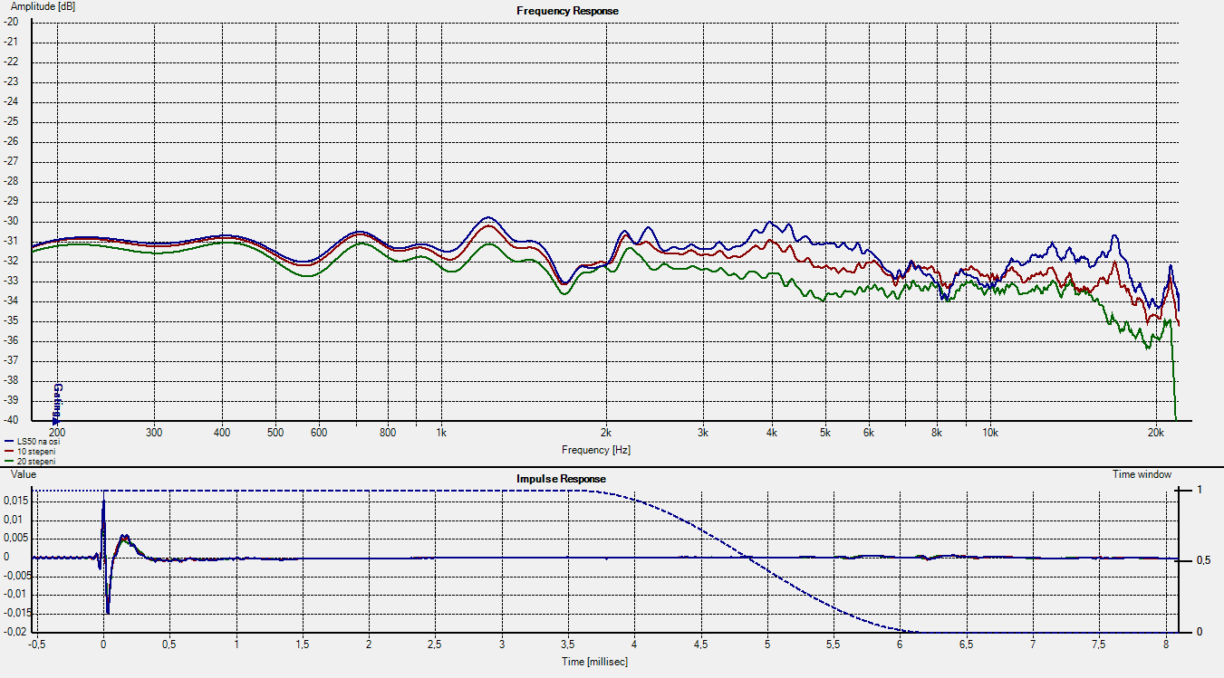

    Playing with it for an hour: on axis and 30 deg off axis

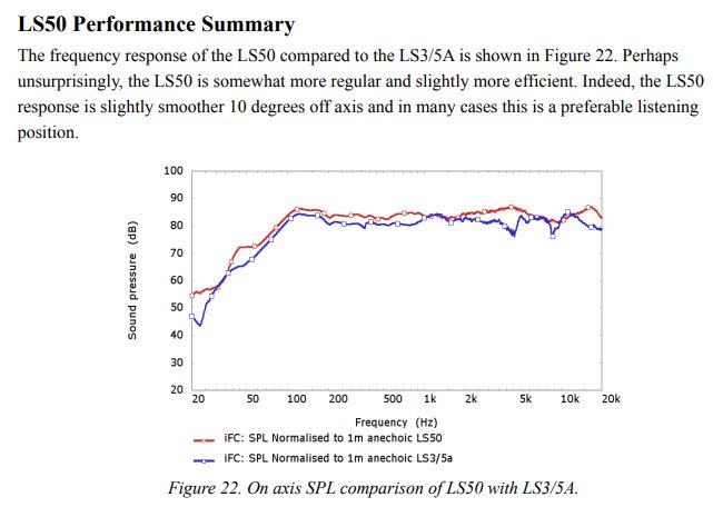

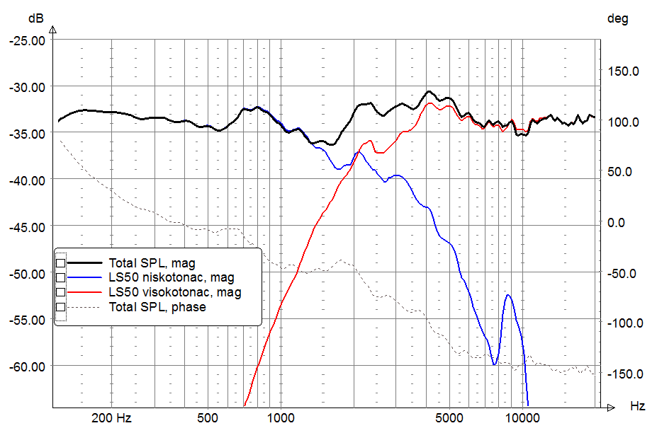

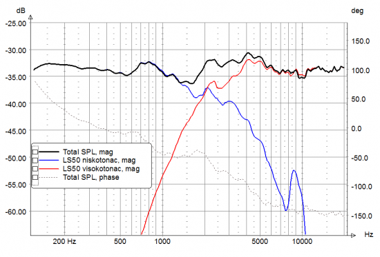

    Very interesting and thanks for sharing. I've found that speaker very interesting, especially after hearing KEF-s presentation about the R&D behind it in AES event some years ago.
    The LS50 whitepaper attached below shows it a bit smoother, but in all likelihood they have used wider averaging and the scale difference plays a role here too.
    Click image for larger version  Name:	LS50.jpg Views:	1 Size:	39.7 KB ID:	864194
    But it's very much likely that with tuning and maybe adding a bit of complexity to the xover you can get even better sound out from that speaker. Commercial design will need to compromise some things especially in that price range.

      Yup, scaling is definitely different and it is possible that they've measured prototype for this whitepaper but in mass production there are tolerances up to 10%. Even with that i see the bump between 500-1000Hz dip at 1.5kHz and peak at 4kHz.
      Listening to the factory crossover for some time i have to give them credit for it. It doesn't sound half as bad as it measures. You can hear that it is not linear but to what extent would be beyond me if i didn't measure it.

        As usual, i'm posting .txt files that you can convert to .frd or .zma if your simulator needs it. I derived frequency files with about 10ms gate time. I didn't merge it to get low frequency response of woofer (under 120Hz) because i'm not interested in it. In the .zip file that is available for download from my DB account there is another .zip file that can be uploaded to HolmImpulse if you are not satisfied how i extracted sim files so you can do it as you see fit. All measurements are done from about 108cm on axis and approximately 30 degrees off axis. It is not good as 0-180 in 10 degrees increments but if you cross it over between 2000-2800Hz you won't get into trouble. Any fine tuning i recommend to be done by measuring and listening of your drivers.
        If there's anything that you want me to do (other than measuring TS for woofers because i'm not doin' it ) feel free to ask.
        Few comments:
        In Kef LS50 they've seem to done around 8dB baffle step compensation for midwoofer. That sounds like a lot but surprisingly it doesn't sound that bad at all. I guess that it doesn't go much low so it kinda evens out. Tweeter level is set, as can be seen, a 1.5-2dB higher than midwoofer. Again, i'm surprised that it isn't perceived like overly bright. You can hear it being louder but it doesn't make you want to turn the volume down - quite strange actually, unlike any metal dome i've listened so far. Also, good thing i've prepared and measured both cabinets because there are few measured differences between drivers. You'll see.
        So, that being said, feel free to share what you've achieved with this or with your LS50's. I know i will.

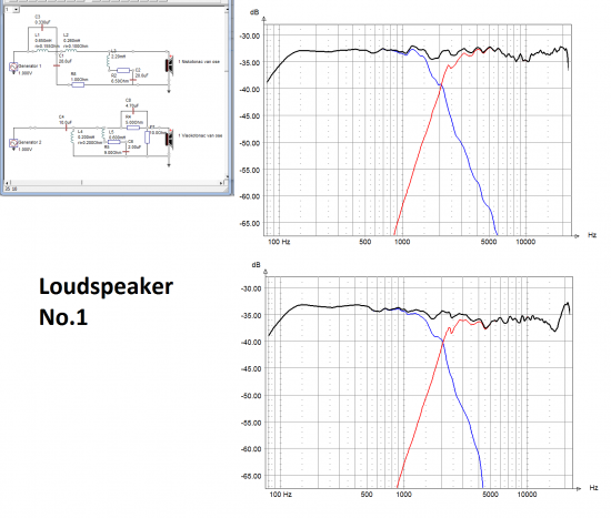

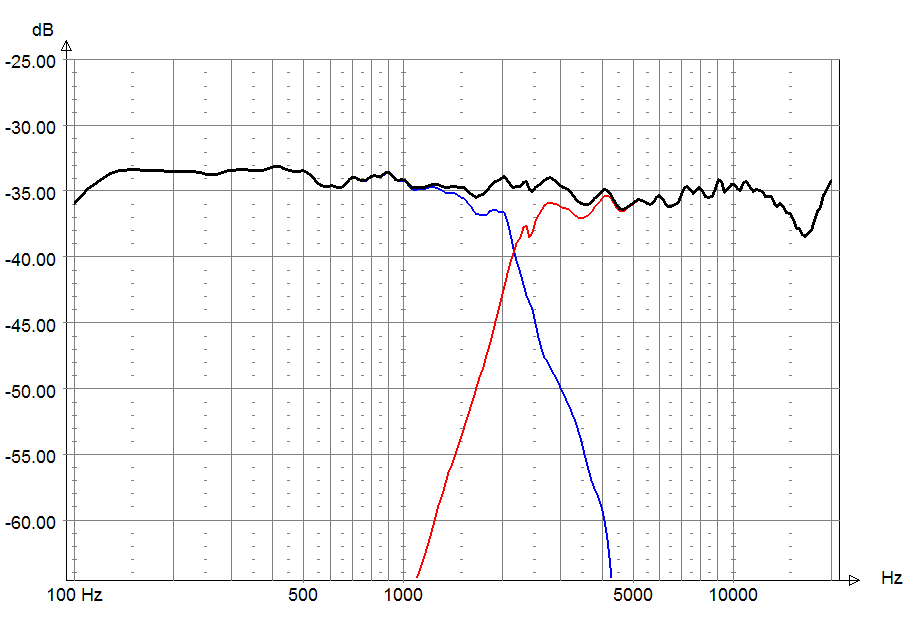

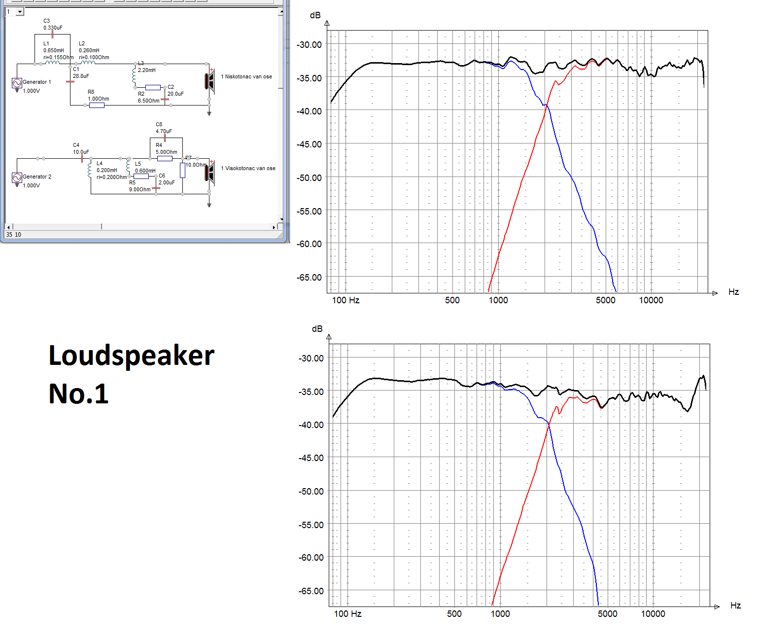

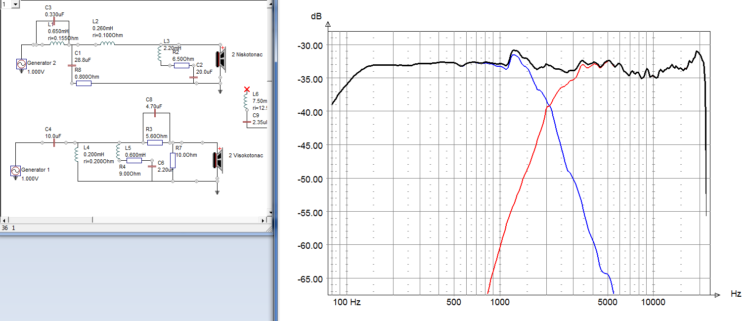

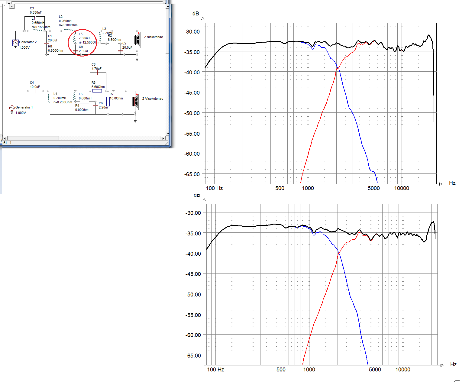

          I've been listening for a few days this crossover:

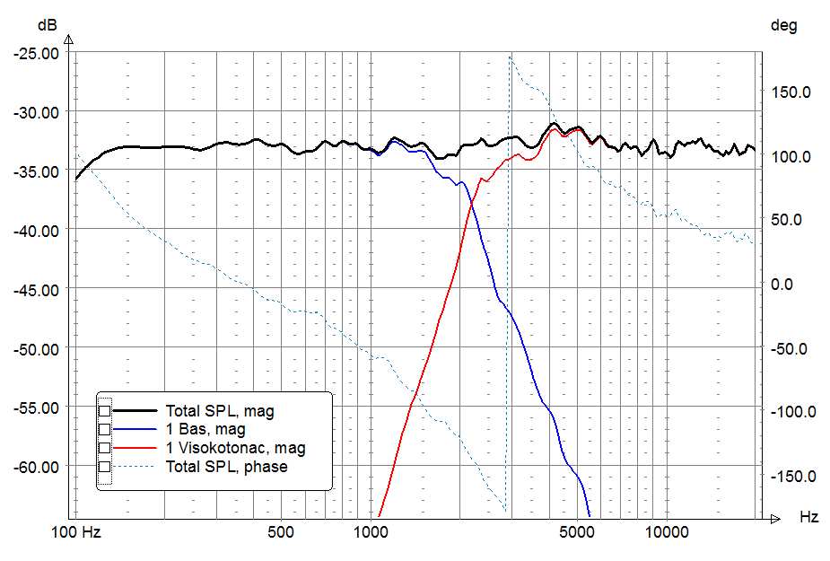

          Loudspeaker No.2 has few slight changes in crossover and one significant:
          The surround on that midwoofer didn't get enough coating so its resonance is quite visible. I decided to solve it with LC filter. 2x4,7uF in series and 7.5mH/Rdc=12.5ohm. 2.2uF will also work but i ran out of 2.2uF capacitors and i was eager to listen to it. The coil is Jantzen, catalog number 000-1541 and can be bought at HiFiCollective for about 3 euros a piece. Its outer diameter is 26mm and it is 15mm high but without it the response looks like this and that was unacceptable:

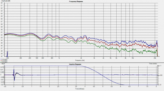

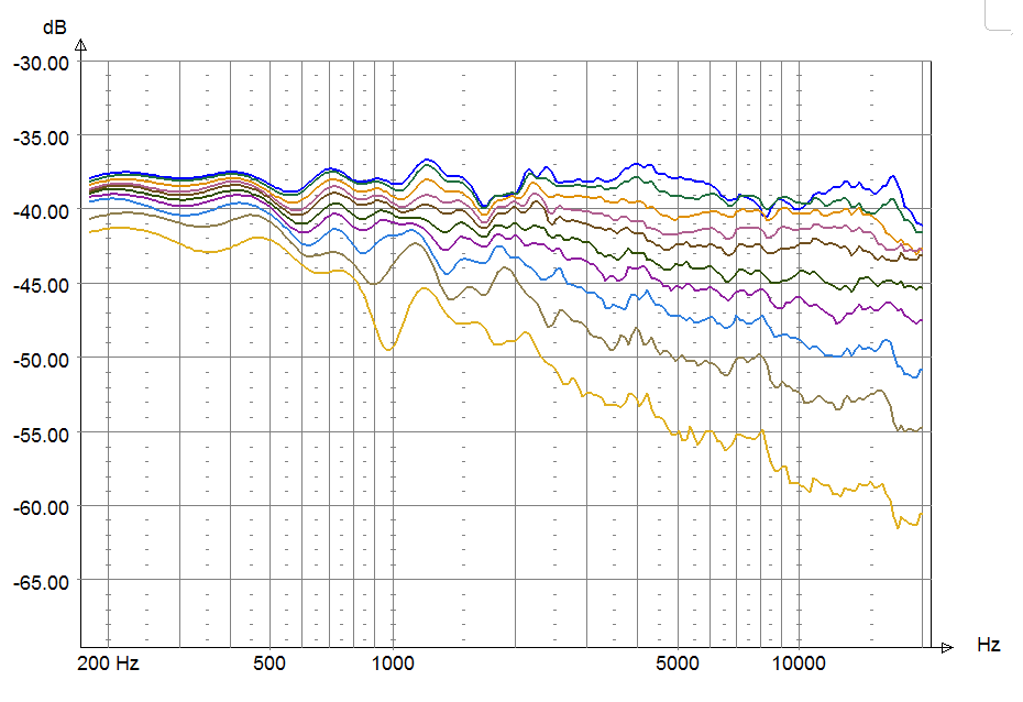

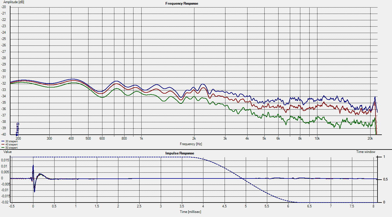

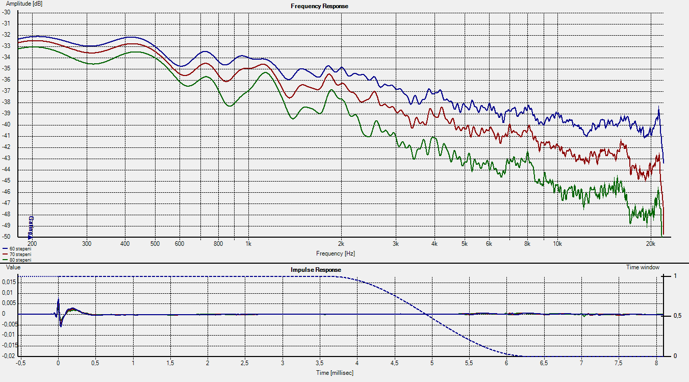

          So, last night i've made some measurements of modified Kef LS50. Bare in mind that this is 1dB grid.
          0, 10 and 20 degrees
          30, 40 and 50 degrees

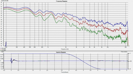

          60, 70 and 80 degrees

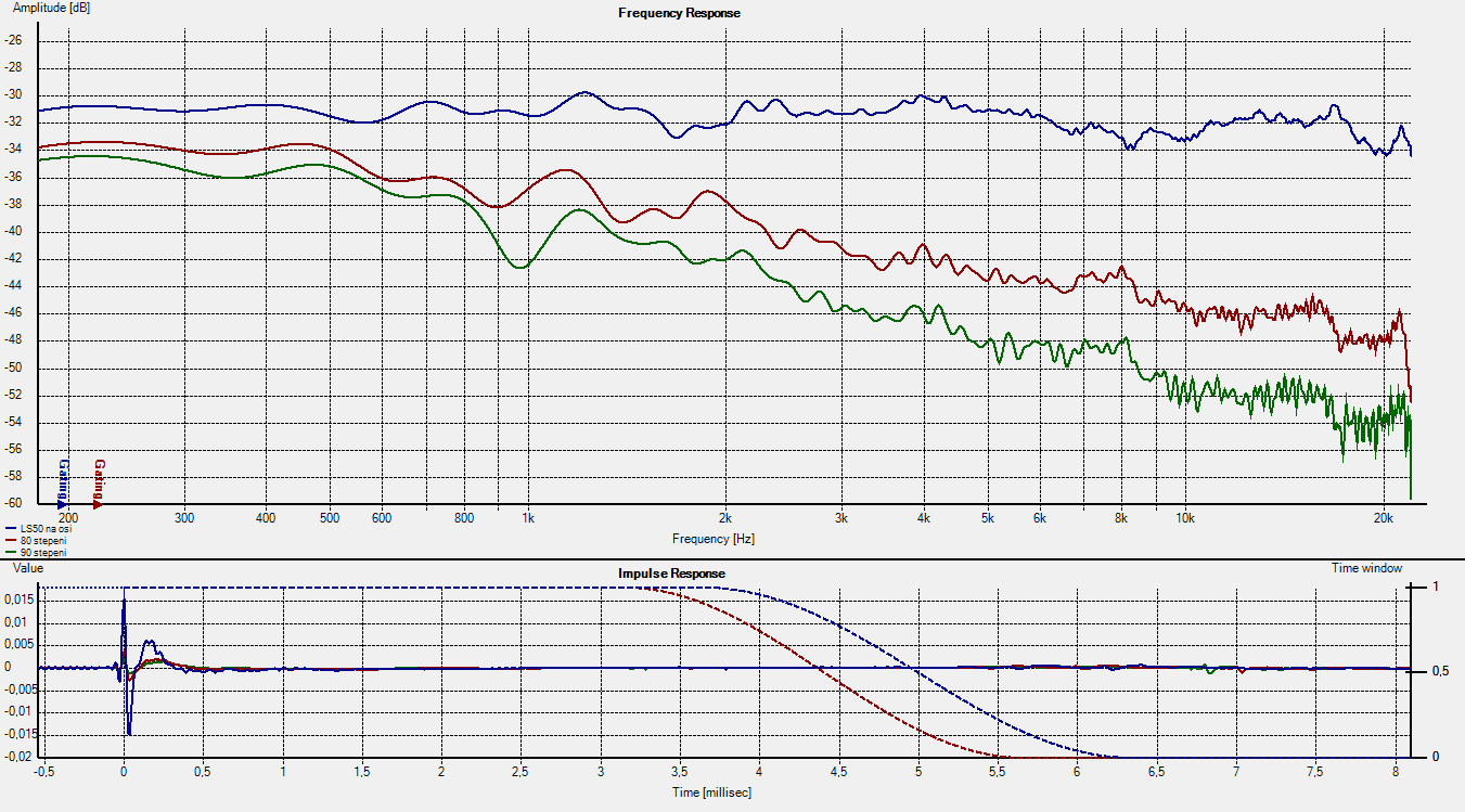

          Here I had to make the grid 2dB to be able to see the level of 90 degree against 0 degrees
          So 0, 80 and 90 degrees
          Tangerine phase plug obviously works like a charm. There will be some tweaking by ear but all in all, I'd say that's it.

            • 698
            A very nice result indeed. You've taken a good speaker and tuned it to max and at least on screen it looks very good measurement wise and probably sounds good and well balanced as well.
            Thanks for sharing!

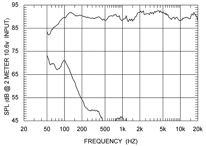

                Yes, LS50 yells for a real woofer crossed around 150Hz, not just a sub.

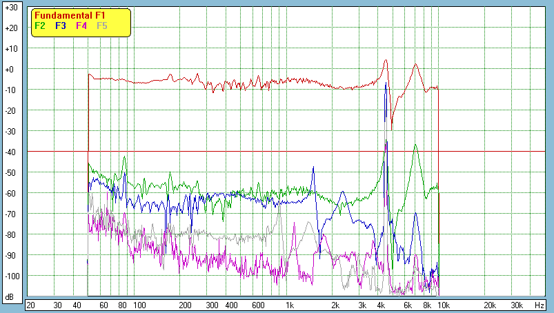

                https://www.soundstagenetwork.com/index.php?option=com_content&view=article&id=941:n rc-measurements-kef-ls50-loudspeakers&catid=77:loudspeaker-measurements&Itemid=153

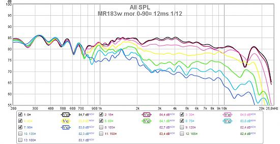

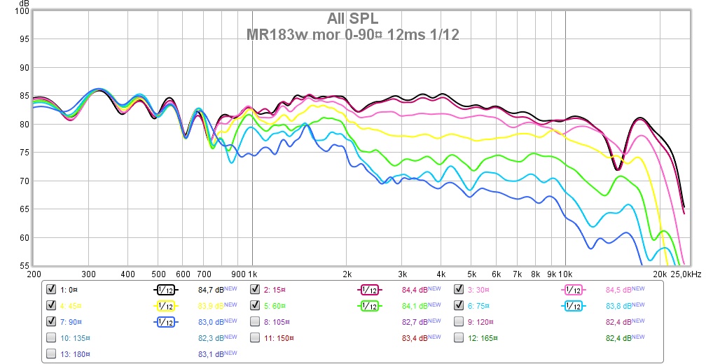

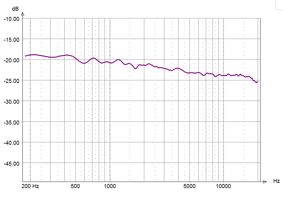

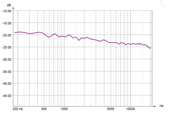

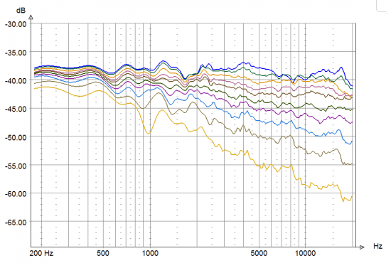

                  Here is horizontal radiated power at angle of 180 degrees (+/-90 degrees in regard to on axis):
                  And here are individual curves:

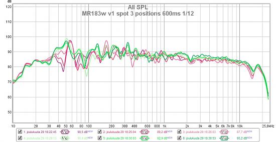

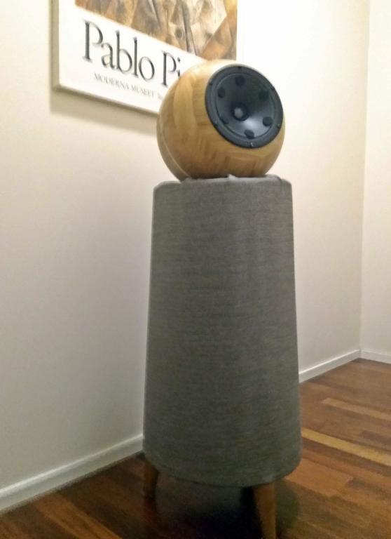

                                            A mid-size coaxial with an integrated subwoofer is a very nice combination for hifi! With some dsp'ery it can have smooth room-response 20-20kHz and gives the benefit of distributed subs. Extremely tight and controlled, even punchy bass and prescise imaging.
                                            I cloned the Gradient 1.4 and made it active with Hypex FA123 board. Woofer is SB 29NRX75-6, coaxial SEAS MR18. The project is here https://www.diyaudio.com/forums/mult...ml#post5591356 Measuring and setting W-M xo was painful indoors during the winter. Now they are serving my daughter, I guess I must call them finished!

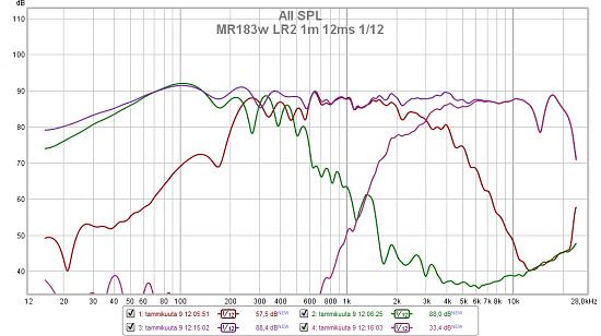

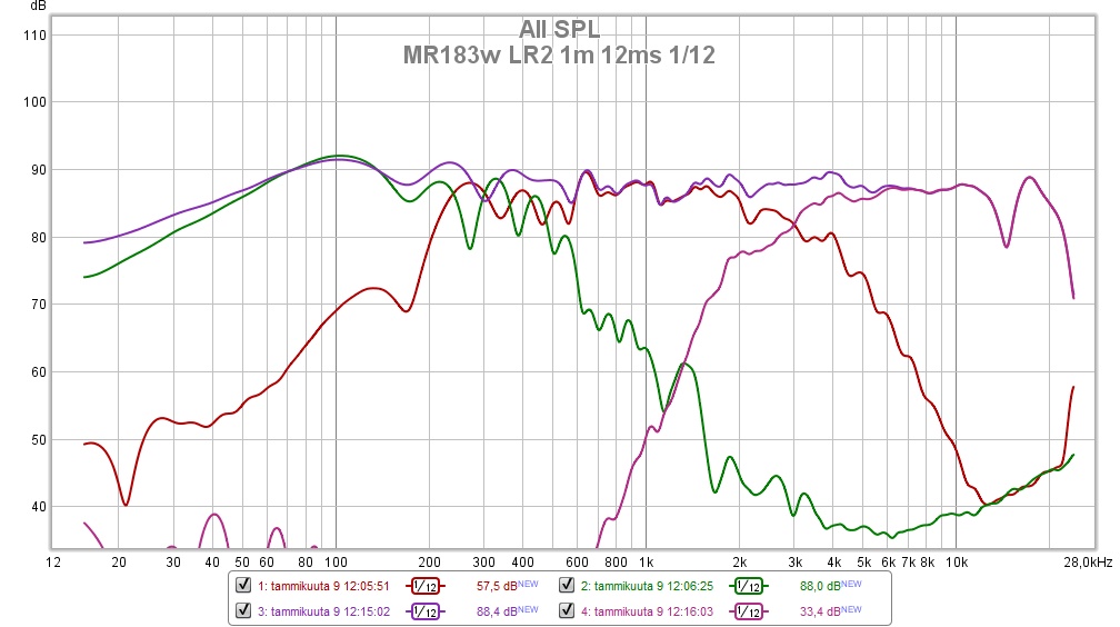

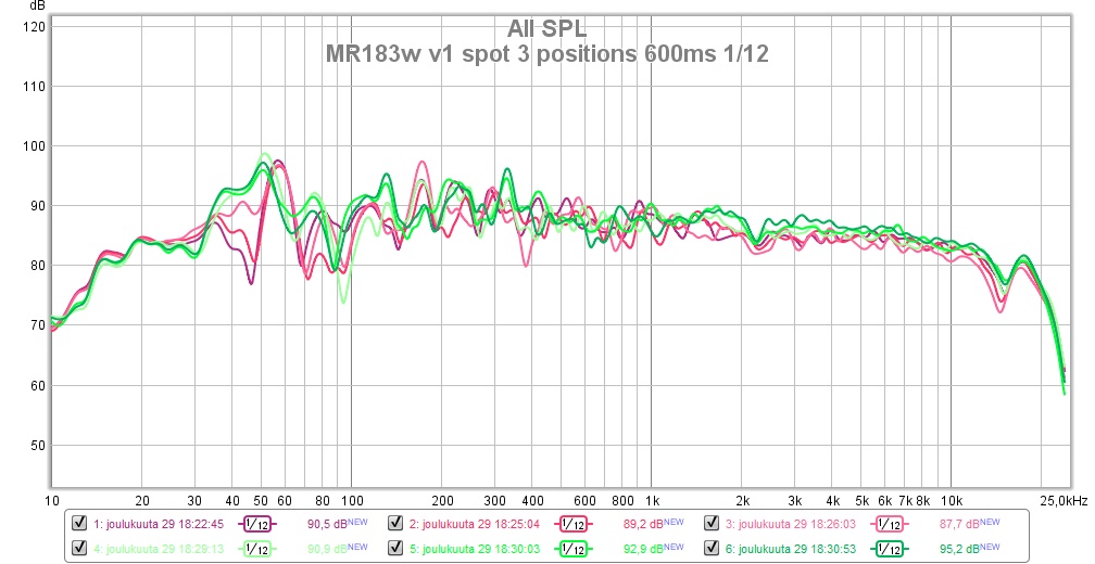

Name:	mr183w v1 spot varipos 600ms 112.jpg
Name:	mr183w lr2 mh 1m spl all ind 12ms 112.jpg
Name:	MR183w stand mor 0-90¤ 12ms 112.jpg

                                              Very cool Juha. I will have to slog the 9 page DIY thread later. Is that the Magnesium tweeter? I once asked Madisound if a umm, "replacement" was available for say a damaged C18, but no luck. If Aluminum, good too (thanks), just that I think the Magnesium has the best very top end dispersion of the family, the bane of many a coax. Actually my only critique of the R series KEF is what I thought (my perception of a factory R series tower) was a slightly closed in top. The Q had this too though...
                                              Originally posted by Zvu
                                              Mms of RSS210-HF is highish for me so i probably wouldn't let it past 150Hz.
                                              Hi Zvu, this seems intuitively correct, that I believed it myself many moons ago, given so many practical examples of big heavy "slow" bass subs. But it's actually the inductance that plays a key roll here and despite the highish Mms, the Daytons low inductance and stiff aluminum cone (thanks mass!) push the resonances out of the usable audio band, so they can be used quite high. I actually used a HF in a 2way with the DXT (@ 1.8k) for a contracted project! . DSP for sure.
                                              I agree with you, the Minidsp stuff is really hit or miss. I usually stay clear except for prototyping. The Fusions on the other hand, are stellar and absolute bargains. We'll see with the QC issues, had some firmware drama with a couple units, since resolved.
                                              cheers
                                              Manufacturer
                                              • Juhazi
                                                • 239
                                                The tweeter is a spare part for SEAS T18REX/XACG which is not listed at SEAS at all, they are custom models used by several Finnish speaker brands and diy people.
                                                I destroyed one of the MR18 textile tweeters and borrowed the alu from my other speakers using that T18. The alu has less distortion and different response above 10kHz, because it sits differently in relation to the cone. I can't hear the difference... Hifitalo has those spares, email them in English!
                                                My 10" high Le woofer is sealed box downfire and crossed 300Hz LR2 (acoustic). Bass sounds amazing, I can't hear the transition between drivers at all in any circumstances! LR4 might be a different story.
                                                • Zvu
                                                  • Oct 2013
                                                  • 436
                                                  cheers
                                                  Hi AJINFLA,
                                                  I'm not worried that it will not play up to 500Hz and measure good. I'm wondering about how will it sound at lower volume because I've found that lower mass woofers are more responsive and are better with micro dynamics at low level listening. I generally get best results when i let midrange do all the midrange it can. At 150Hz cone movement of Kef concentric is minimal so it will not affect the highs, everything from 150Hz and up comes from a single point, lobing between woofer and midrange is practically non existent and 9gr cone does all of midrange which means a lot when listening at low volume.
                                                  How did you deal with 3rd and 5th harmonic with your 1800Hz cross over ? It looks sinister:
                                                    I applied a notch and low pass filters .
                                                    What you show is an unfiltered driver. Of course as you say, if the Dayton is prohibitively expensive, there may be better choices there. I have some Wavecore SW215s (49g mms) arriving tomorrow, which will be my first experience with brand. On your side of pond, the Reckhorn D165s seem to be a bargain, so 2x might be an option for you at reasonable cost vs a single 8.

                                                      I suspected the Alu, but your picture almost made tweeter look white like the Magnesium. Isn't that what Jorma (RIP) used in the 1.4?
                                                      One thing you can see in the KEF/Tangerine vs the Seas (old school coax) is the "pinching" around 8k. I usually apply a narrow-ish notch to help mitigate the excess sound power in this region (the KEF seems to have this inherently, though a bit broad). Helps take some edge of sibilant tracks. Luckily, even drywall starts to be absorptive at these frequencies, so the room/position/taste matters here also.
                                                      cheers,

                                                        Yep, the Gradient 1.4 has MR18 cone and C18 Mg tweeter, perhaps some custom job with surround and spider etc. Gradient has been using mainly SEAS drivers for many decades.
