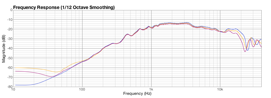

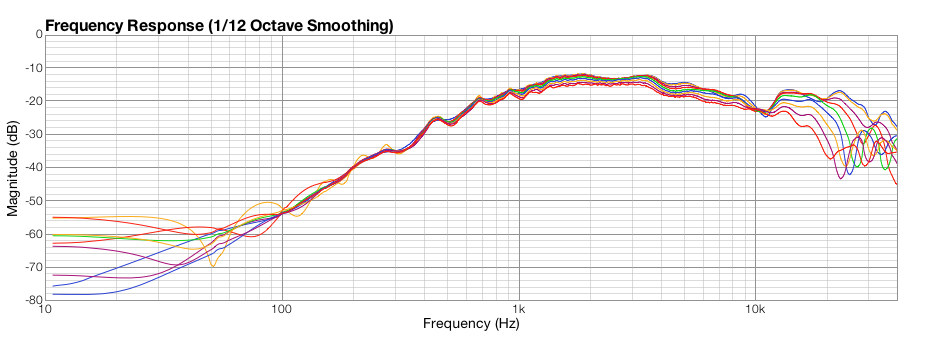

    I did get the Millenium Excel tweeter mated with an H-65 waveguide- results weren't bad, but they weren't everything I'd hoped for, compared with the results using the Scanspeak D2608/9130.
    First, here's a series of curves taken at 5 degree intervals from 0 degrees to 45 degrees
Name:	Millenium Excel WG Curves.png

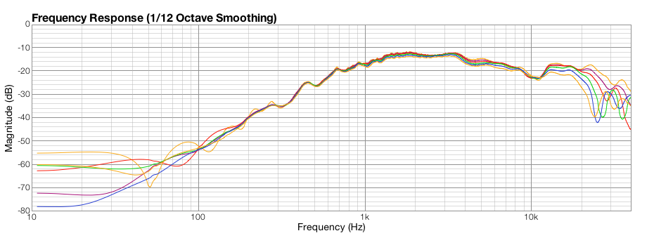

    A little confusing, but one which is clear is that there's something going on with the behavior at about 12 kHz causing a dip and deviation from pattern control.
    Trying to make a little more sense out of this, I plotted some different regions- first, the curves in the 0 to 30 degree range:
Name:	Millenium Excel WG Curves 5-30.png
    I also plotted three curves in the 25 to 40 range:
Name:	Millenium Excel WG Curves 25-40.png

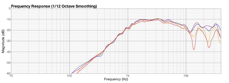

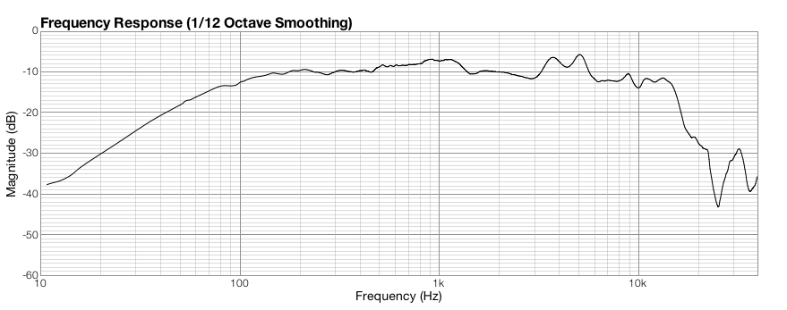

    Note quite my predetermined idea of perfection, but look at what the Accuton C13N looked like in a H-65 waveguide:
    Makes the Millenium Excel results look rather splendid in comparison, huh?
    Well, I think I'm going to go ahead for now and try working with the Excel, beef up a couple of waveguides, and get a new test panel ready.

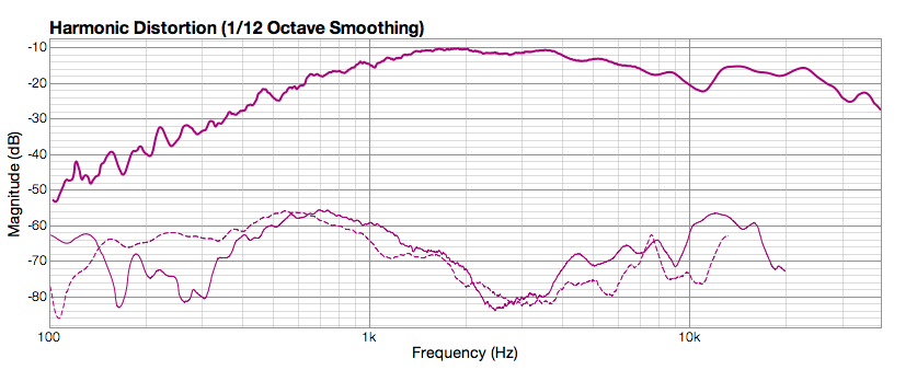

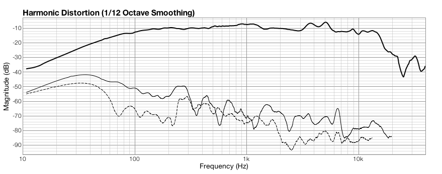

    I did do a basic distortion analysis on a sweep, with some interesting but not surprising results- the distortion is lowered in the 2-5 kHz area compared with direct operation, by nearly 10 dB.
    As this would be right at the lower crossover point in the Modula Xtreme application, can't hurt, can it?

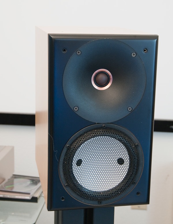

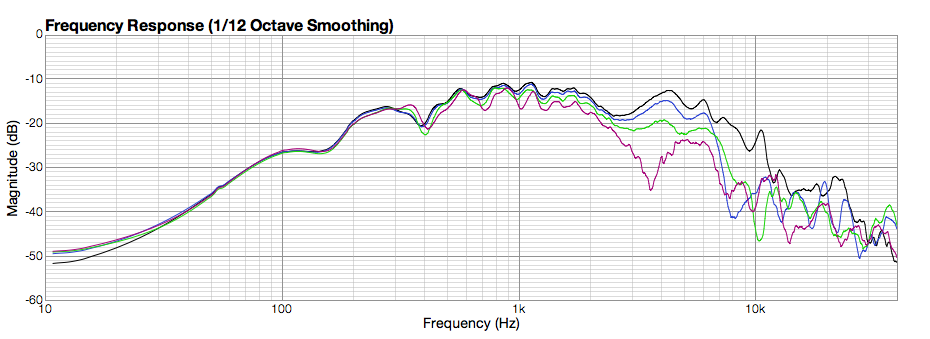

      C173-T6-90 in test cabinet
      Just to see what we have to work with if the 0.5 cu ft enclosure is used- same enclosure used for the Excel WG testing, and the WG is mounted. A series of curves from 0 to 45 degrees
      Not much filtering on this measurement and floor bounce and other room effects are visible, as well as the limitations in dispersion from a 4-1/2" diameter cone!

      Updated to include pic of test cabinet

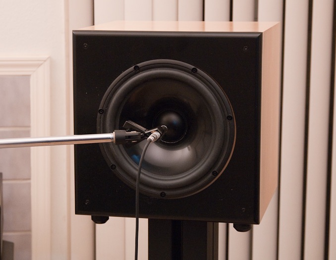

        More testing in progress...
        It's all very well to model interesting ideas, but the proof is in the measurements.
        More testing underway, and it's looking pretty interesting. Will also have that sample Z curve for the 26W/12867 poster soon.
        This is a 1 cu ft PE sub enclosure, in case anyone is curious. Nice cute little size. One might almost say "petite". Not the thing folks that like rubenesque bass might be looking for, but with good potential for a relatively compact high output system. NOT a sub, but with two for the woofer part on each side.

          That 10-11k dip near axis, disappearing off-axis, looks suspiciously like the on-axis dip in both my large WGs and Earl's Summa WGs...except yours is higher in frequency and extends further off-axis. Notch depth is about the same. Higher frequency makes sense since yours is much smaller, broad off-axis, dunno. Earl says it is a resonance across the mouth caused, ironically, by an accurate implementation of an axi-symmetric WG.
          He suggested two solutions, one is an asymmetric HxV profile, the other is modifying the mouth profile to break up the on-axis symmetry. I haven't gotten to it yet, but was going to try some felt pads on two opposite quarters of the WG mouth...got felt?
          Paul
            • 15305
            Yes- have felt and a few ideas, as well- figure I'll just proceed with upgrading the waveguide construction, make new baffles for the final set, and then experiment after I get that configuration together. A lot else seems to be falling into place, so I'm going to keep heading down this path for now.

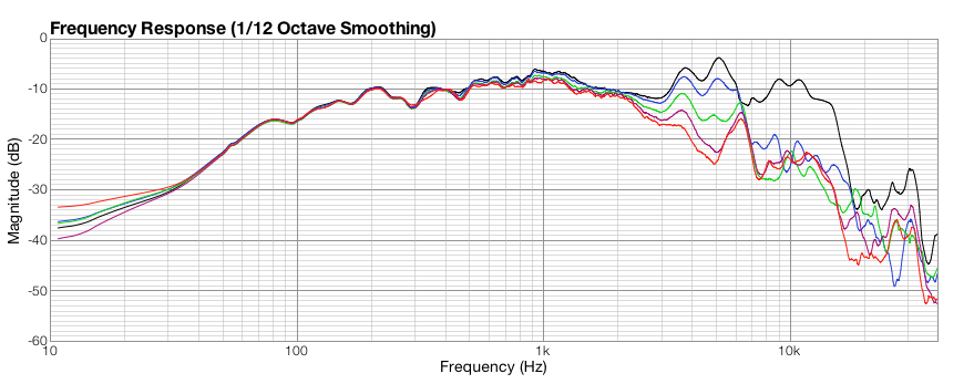

                    • 15305
                    NE180W Private Investigations...
                    The new Vifa's have a number of people intrigued... especially when they're called full range drivers. Not that I see it likely this crowd would use them that way....
                    First, a 6" nearfield plot which is the quickest thing to do that will resemble an infinite baffle measurement in an open area or dead chamber; gate is 200 msec. -10 dB corresponds to 90 dB at 1 meter.
                    Click image for larger version  Name:	NE180W-NF.png Views:	3221 Size:	41.5 KB ID:	854406
                    This is a sealed box test, no port.

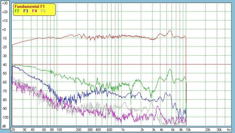

                    Next, distortion under the same measurement conditions- actually, the same data. Due to being a 4 ohm driver, the output level is about 3 dB higher than the typical 7" 8 Ohm midwoofer, so keep that in mind if comparing to other measurements, which may be at lower output levels with the same 2.83 VRMS drive.
                    Click image for larger version  Name:	NE180Distortion 90dB.png Views:	5195 Size:	57.4 KB ID:	854408
                    Isn't that nice performance from 300 Hz to 10 kHz? You don't see that every day in any kind of cone midrange, much less a 7" midwoofer. Far too often we see rising distortion above 800-1,000 Hz.
                    Last up, some curves on and off axis, 0 deg, 10 deg, 20 deg, 30 degrees, 45 degrees. This is on a 9" wide baffle cabinet, and of course, room effects are not avoidable.
                    Nice behavior up to 2500 Hz, about as high as you can expect for a 7" frame driver, I'd say. Certainly looks like it's workable with a 2-2.2 kHz crossover point.

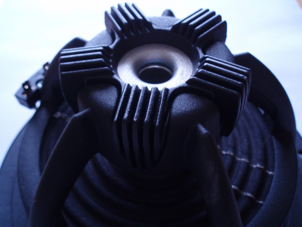

                        Wow, exactly the same results I got with a preliminary set I tested 8 months ago. I never wanted to post the results because I couldn't say if they would be at all similar to the production versions, but since they are obviously the same, here's some consistency data for all. I'd call it a good (but not great) cone and soft part design, with a class leading motor. Reminds me of an XG18 but improved.
                        Click image for larger version  Name:	Vifa-835045-FR.gif Views:	3309 Size:	12.7 KB ID:	854420
                        Click image for larger version  Name:	Vifa-835045-HD.gif Views:	3197 Size:	22.3 KB ID:	854421
                        I noticed they lost the heat sink fins. To bad, they were sexy. But if that's all they were, no real loss I suppose.
                        Click image for larger version  Name:	Vifa-835045_rear.jpg Views:	1157 Size:	94.2 KB ID:	854422
