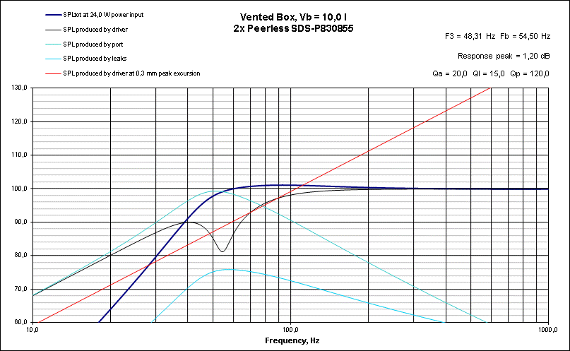

    For the mid driver I went with a Peerless/Tymphany SDS P830855-8
    The tweeter is a SB Acoustics SB26STCN-C000-4
    I went for a ported enclosure.
    Tuned at 54.5 Hz, with a f3 of 48Hz
    x,max at 12W for one speaker
Name:	VB Response Peerless SDS-P830855.gif

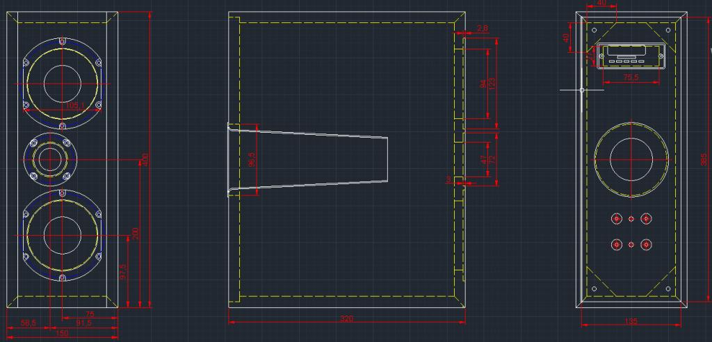

    Volume is approximately 10l

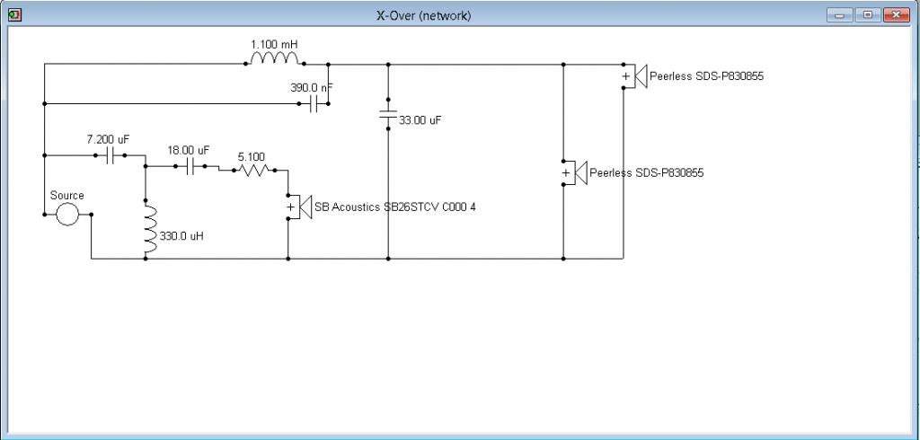

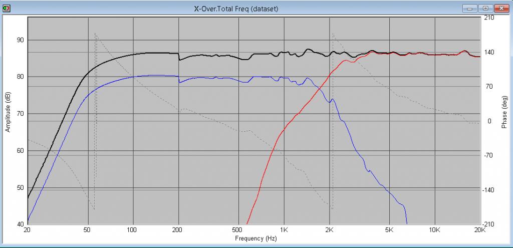

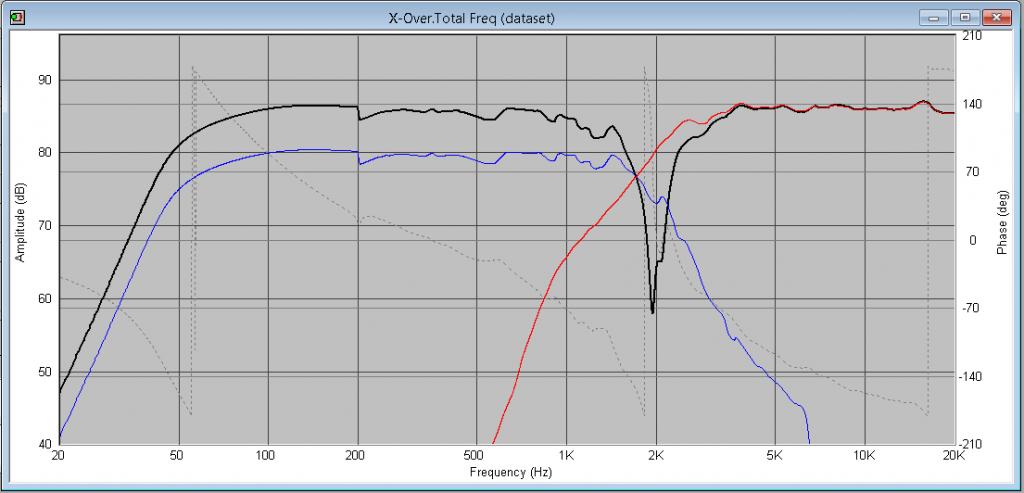

    X-Over:
    Crossed at around 2100Hz.
    Freq. responce:

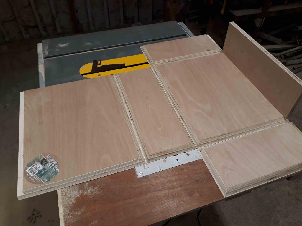

      I already started to build the enclosure.
      I did an 45° cut on al the edges expect for the back pannel that wil be removable.
      The enclosure will be build with 15mm multiplex.
      Will not add braces. Expect if someone tells me it is best to do so.

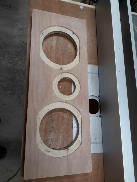

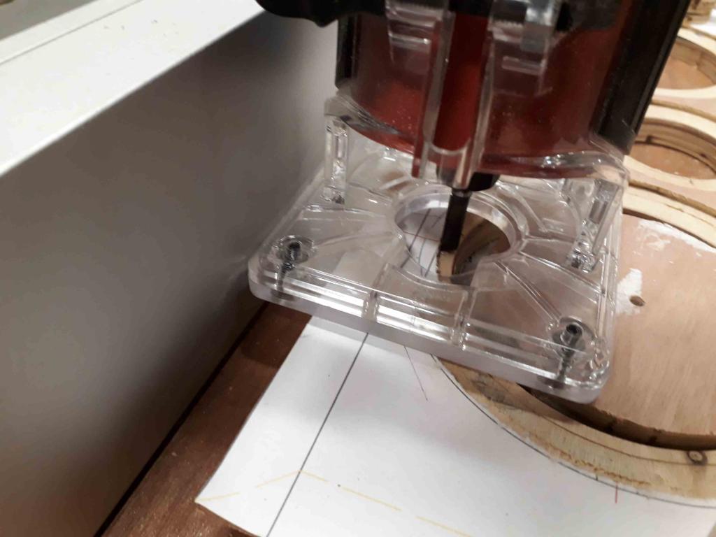

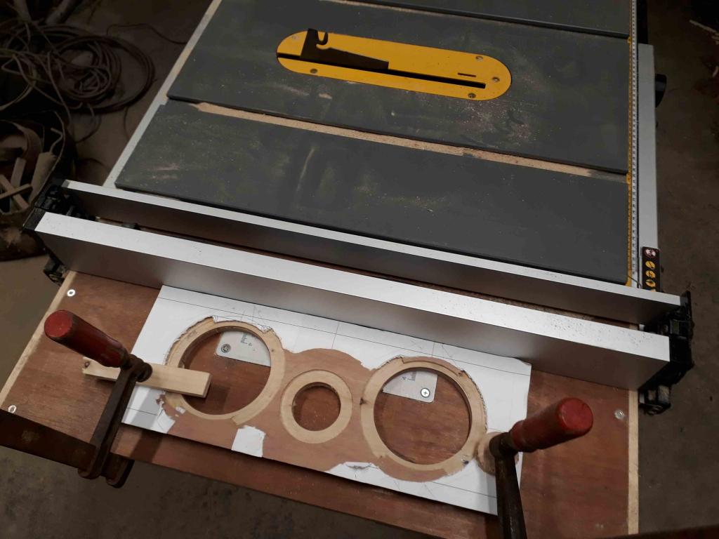

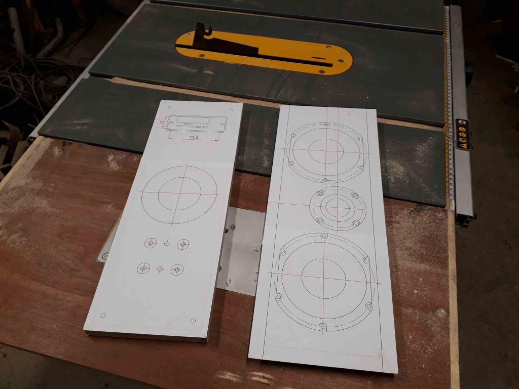

      For the routing part I always draw the front baffle in a CAD program and print it on a 1:1 scale and gleu it on the wood. So I know the placement of the drivers, port, terminals, ... will be correct.
      The Peerless/Tymphany drivers are not completely round, I like that because you can get away with a pretty small baffle.

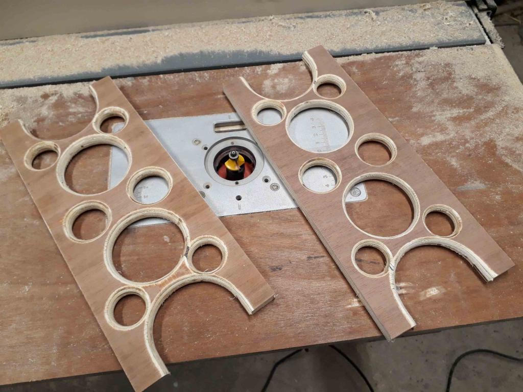

      But it is a pain for the routing part.
      First I did the round part as far as possible. Taking care I did not go to far.
      Then I routed a complete circle that just touches the straight edges of the Peerless drivers.
Name:	20181226_170752 (Copy).jpg
      Next I need to take care of the straight edge.
      I clamped the baffle next to my fence of my table saw. So I knew it was in line.
      Then I adjusted my fence so my router just touches the complete circle.
      Next I started routing next to my fence of my table saw, with great care because I did not want to go to far...
      I am happy with the end result. One Tymphany/Peerless driver doesn't fit. The outher circle is just to small, that is next on my to do list.
Name:	20181226_202254 (Copy).jpg

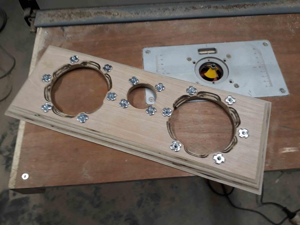

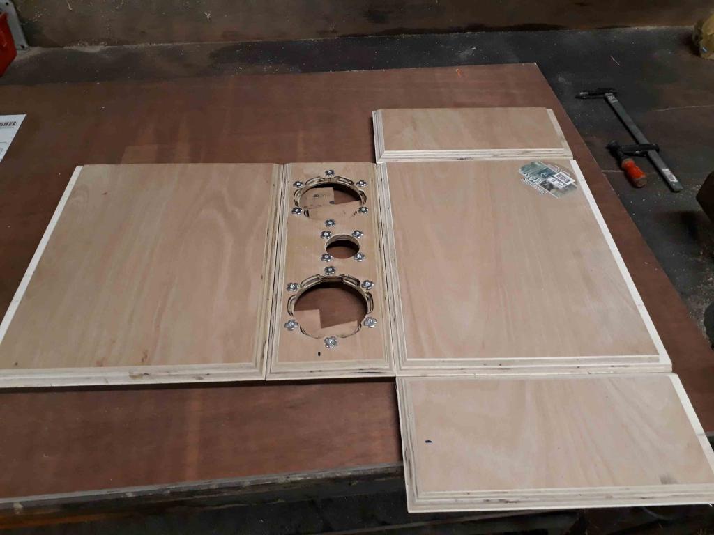

        Next I had to chamfer the inside of the front baffle.
        Some room for the speakers
        Also hammered the M4 inserts in place for the tweeter and mid drivers.
Name:	20181228_110537 (Copy).jpg

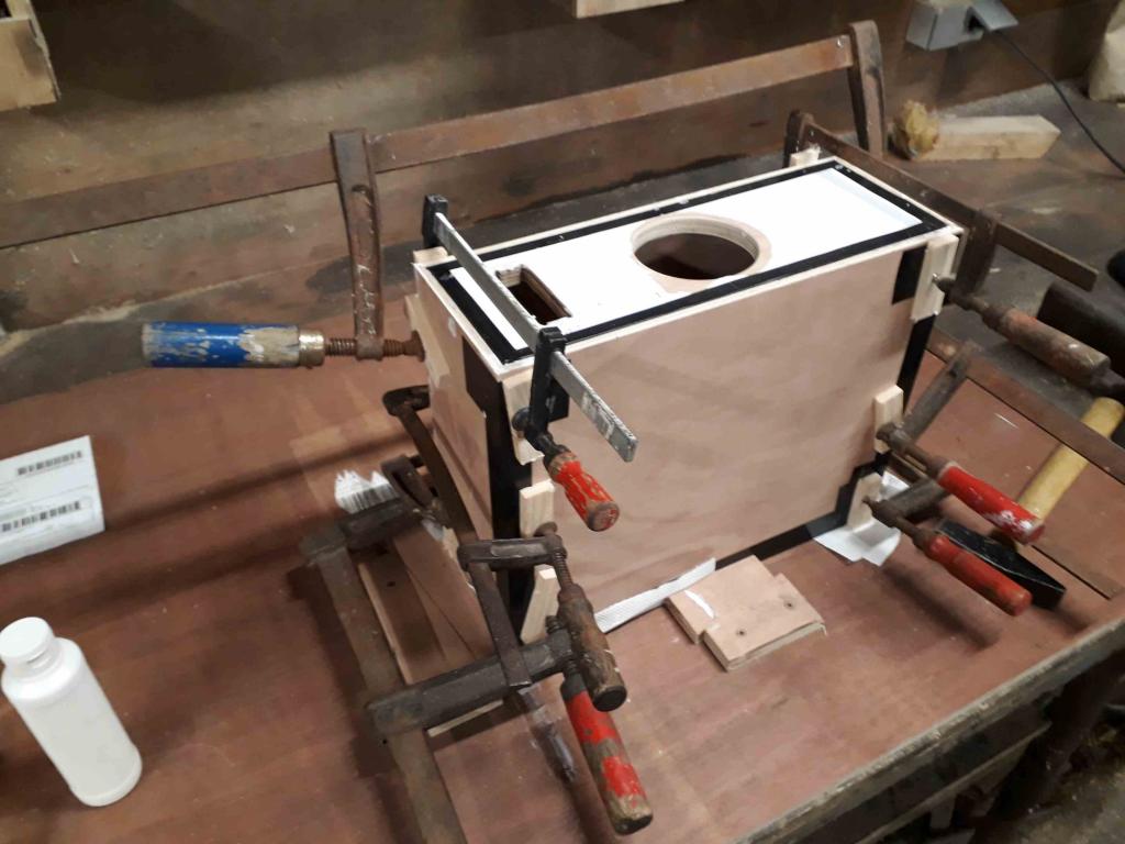

        Then I gleud it al together. At the back I tape it so I can fold it nicly together.
        An other advandace is that the wood gleu can only go to the inside. Of course only where you can tape it before folding it together.
Name:	20181228_150808 (Copy).jpg
        I clamped it together. I also like to use wedges I screw to the table.
Name:	20181228_153712 (Copy).jpg

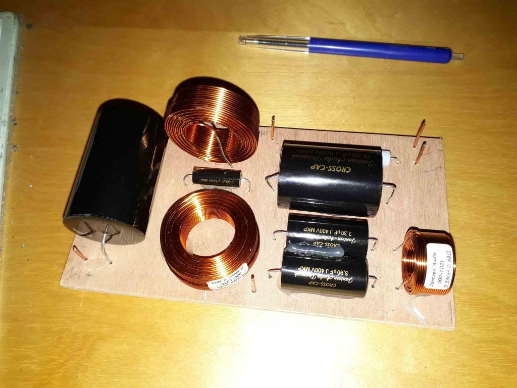

        When the gleu was curing I soldered the X-over together.
        The wires sticking out wil be soldered to mid drivers and tweeters.
Name:	20181228_194355 (Copy).jpg

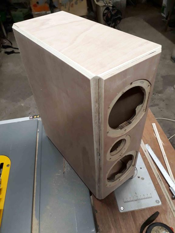

          Today I removed the clamps after approx 24h curing.
          Then I added chamfers to the front baffle with the table saw.
          15mm at the vertical sides from the front baffle and 7mm for the other edges.
Name:	20181229_124240 (Copy).jpg

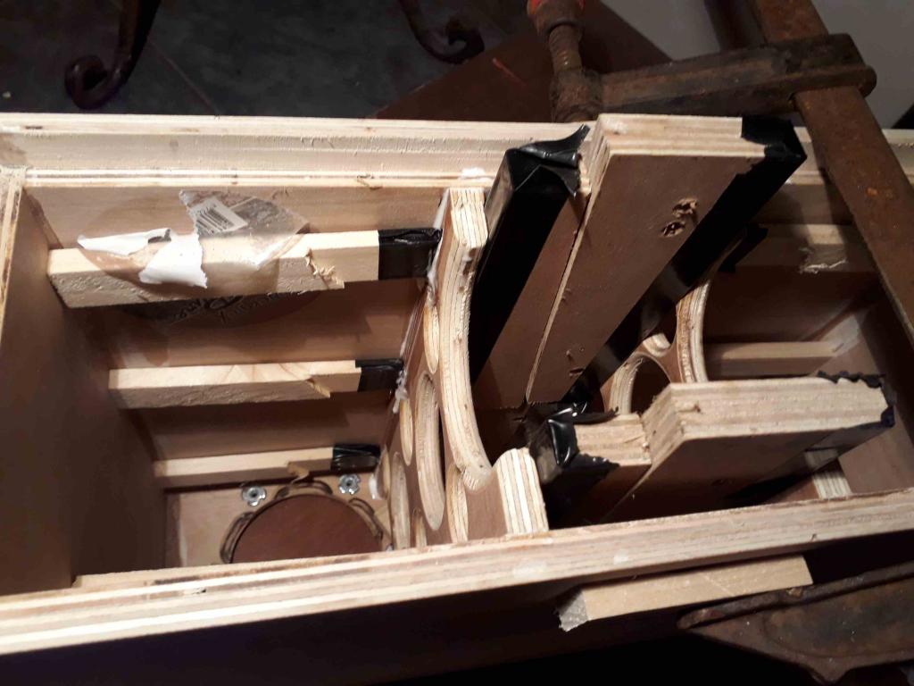

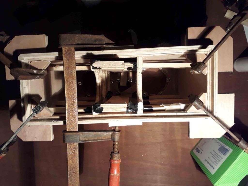

          I realised I best had to add braces in the enclosure.
          Sad I had to find that out at this point when it was gleud together.
          So I made 2 'brace panels' (don't know if this is really English...)
          I did this in 12mm Multiplex, that was what I had laying around.
          Also added a fillet at al the cutouts
Name:	20181229_160331 (Copy).jpg
          Then I had to figer out how I would get it in the speaker enclousure.
          At the side I did a 20° cut aprox 5mm from the side (at the shortest side).
          So now I could gleu it in place.
          When gleuing I pushed the braces to the outside, with wedges.
          This way with the 20° cut I put pressure to each side I am gleuing.
          Because I don't want to push the enclosure open, I added a clamp at the top
Name:	20181229_185223 (Copy).jpg
          Also gleud little corners in place that will hold the back pannel in place.
          This all will cure for aprox 24h
Name:	20181229_190111 (Copy).jpg

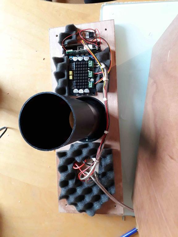

              Second: I got it running but it will need some little modifications.
              The day after I removed the clamps and wedges and to my own suprise the braces stayed nice in place.

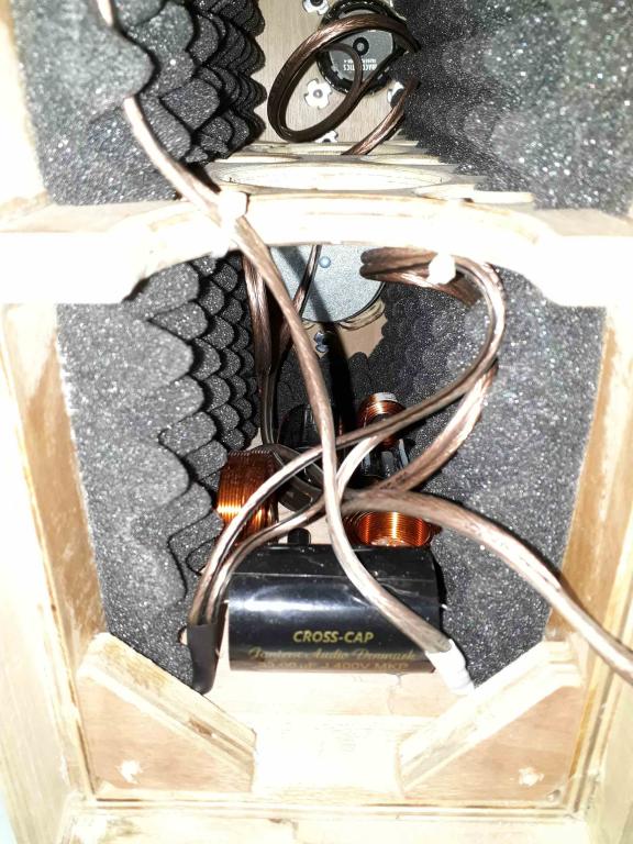

              I sanded it a bit and added acoustic egg foam, everywhere I could.
              I placed the amp on the back panel because that way I take it all out and it is pretty easy to work on.
              And there was more work than i though =D
              The amp is good enough, you only have a bit noise that you hear if the volume is (almost) completely down.
              I think you will always have this with class D amps (correct me if I am wrong), at least with an amp of under 10USD
              Than I have a little fm-radio, bleutooth an aux module. The fm radio isn't that good, maybe add a decent antenna, now I was trying with just an aux cable. I bought an antenna with an aux connector (bit to short), therefore there is an aux connecter on the top.
              The aux is good without extra noise.
              Bluetooth is an other story, there is a high pitch noise when I use bleutooth... But if I power the little module with a isolated power supply from the amp the problem is solved.
              I was trying this with a battery just for the module. I will order an SIM2-1212 so I can use the same power supply from the amp but that way it will be isolated.
              Then I have a 'blop' when I turn my power on, I tried to add a 1uF (High pass filter of aprox 10Hz) at the input of the audio amp without succes.
              The chip used on the amp board has a standby mode that will work better but it isn't accessible on the amp board...
              Other idea's for this problem?

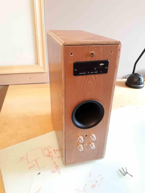

Name:	20190102_124239 (Copy).jpg
Name:	20190102_124501 (Copy).jpg

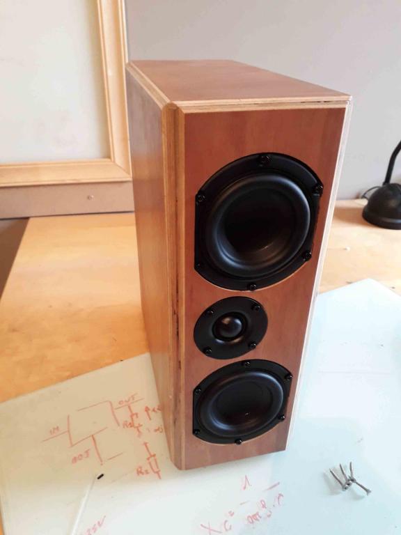

              I also added clear wood varnish and this is how they turned out.
              This is how they look. I am happy with the look and the sound. I have to say they are a bit bigger than I expected.
              I'll probably add a handle on top to take it around a bit easier XD
Name:	20190102_124644 (Copy).jpg
Name:	20190102_124715 (Copy).jpg
