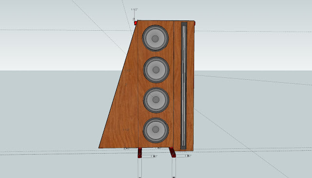

    I wanted to share some details of a speaker system I put together for my basement listening room and home theater. I've been reading here and at other speaker building sites for many years but my participation was essentially all vicarious. I followed along and built systems on paper and in my head but work and other projects always kept me from actually building anything.
    Along the way, I bought drivers when deals came along that fit into various projects I had in mind. I have accumulated a nice collection. I bought a pair of BG RD-75 drivers when a pair was available used. I became interested in the RD-75 when it was a hot topic on the old Bass List. Many plans then were formulated around the Carver Amazing series which used a 60" planar magnetic driver manufactured by BG I believe. It used high Q 12" drivers in an open panel dipole to achieve good low bass response.
    When someone from TC-Sounds offered some 15" aluminum cone drivers with specs suitable for dipole use at a great price, I bought 10 of them. Of course, after I bought them, I read many threads about suitable drivers to pair up with an RD75, and 15" woofers were rarely on the short list. I was not deterred.

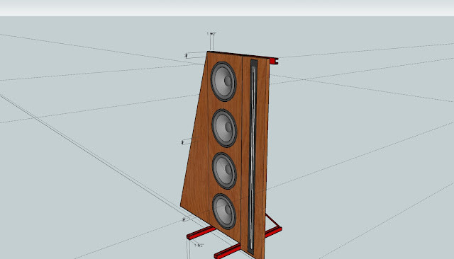

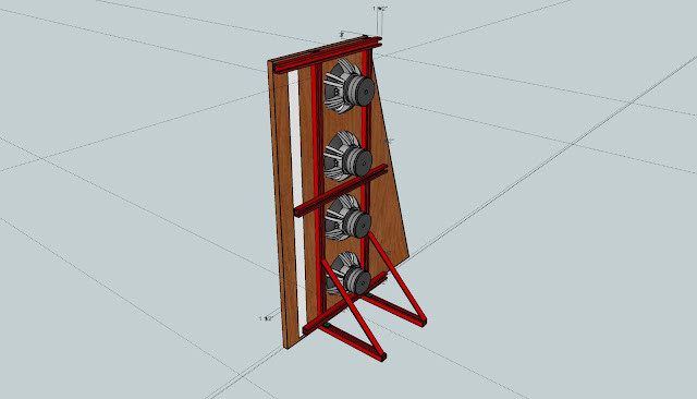

    My first plan for these drivers was to create a modular panel arrangement attached to a metal frame. I did a sketchup design using unistrut components. I had never heard of unistrut but saw it mentioned in a comment someone made on this forum. It looked like an ideal modular system to provide the frame for a modular speaker. That way, I thought, if I was unhappy with any component, I could put a line of something else in its place. If the 15" woofers proved unsatisfactory, I could swap in an array of smaller drivers. If the RD75 was superseded by something better, like say an array of Neo10s, I could substitute. As it turned out I didn't use any unistrut components, but it was a good idea. I kept it much simpler. More details to follow.

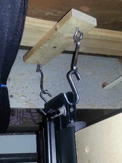

    So I decided to do something similar to see how it sounded. My basement ceiling is only 79" high to open joists. A picture is worth a thousand words.

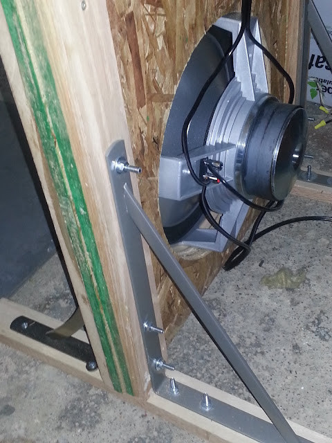

    I hung it from a cross piece that could swivel that attached to another piece that spanned between the joists and could move side to side. So I could adjust the toe-in and the width of the drivers.

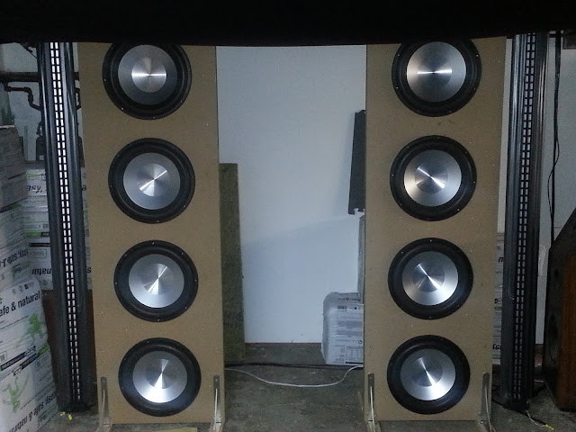

    With the 15" woofers, I decided to mount them on a flat panel, 24" wide and 75" tall. I wanted the panel to be stiff so I used two sheets of OSB and one of MDF. I cut all the holes for the drivers with a Jasper jig, then I glued them together with PL premium and used a whole bunch of screws to clamp them. I also glued and screwed some 3/4" oak along each side for additional stiffness.
    I bought some oak stair tread to use as a base. The oak stair tread comes in 4 ft lengths and is 1 1/4" thick if I remember right. Very stiff stuff. I didn't want these heavy panels falling over so I made the base pieces 24" long and used some heavy duty shelf brackets to bolt them to the panels.
    I didn't care what these looked like since I planned to use them behind black grill cloth and an acoustically transparent screen. So no paint or special finishing.

    The bags of cellulose insulation are temporary attempts at bass trapping. The floor is just bare concrete. I have my projection screen hanging from chains and I swung it up and clamped it to the ceiling to take the picture.
    I set the crossover at 400 Hz then used the auto eq function built into the DBX Driverack PA. It uses pink noise to set the eq automatically and has several house curves you can choose from. I expected to see a boost needed at low frequencies due to the open baffle. Instead, the auto eq made significant cuts, like 9 or 12 dB all the way down to 31 Hz where it then boosted the output by 9 or more dB.
    In measuring with REW, the bass response was good down to about 35 Hz where it then dropped off. I did probably hundreds of measurements with REW and tweaked the eq and amp levels. For music, it really didn't seem like I needed deeper bass. There was bass in abundance. But for movies and to insure I didn't overdrive the open baffle woofers, I dragged my Velodyne ULD-18 down the stairs and incorporated that into the mix. I crossed at 50 Hz to the Bass panels.
    The sound quality is just amazing. Prime listening distance seems to be about 10 feet away for best stereo imaging. The most striking impression is that the musicians seem to be in the room. Victor Wooten on bass guitar sounds like he has his Hartke bass rig set up right over there. Vocals sound totally natural. I don't notice anything missing on the high end. Where a cymbal is prominent in the recording, it sounds like a cymbal.

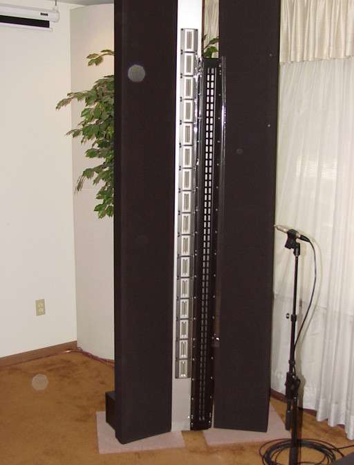

                From BG RD series product information:
                Large rooms with high absorption,high playback levels, or long listening distances usually require a somewhat higher crossover frequency (at least 300 Hz second order high pass crossover). In an average or small sized room with low absorption and shorter listening distance, a 150-200 Hz crossover point may be used. At least third order crossover is recommended for this application
                Distortion levels and best crossover frequency must also be dependent on baffle width. It would seem my minimalist baffle (pipe insulation) would be a worst case. Again, from the BG literature:
                In dipole or open baffle situations, low frequency extension and SPL output is largely dependent on baffle size and geometry. To achieve a sufficient low-end response, a minimum baffle width of 12" is recommended.Generally speaking,a baffle with irregular or sloped side(s) (e.g.trapezoidal) will yield a smoother response due to the spreading out of baffle edge diffraction effects
                Jon, you mention Fuzzmeasure and Praxis for measuring distortion. I don't have a Mac and Praxis is very expensive. Any familiarity with other options? REW has distortion measurements. Is that feature in REW worth exploring? It might be interesting to compare distortion figures using different crossover frequencies and baffles. Holmimpulse is another measurement program that measures THD. I have downloaded it but haven't used it yet.
                An interesting tidbit that I didn't know about the RD75 from the BG literature: It is a replacement driver for the Genesis 1.1. I wonder what low end crossover frequency they use between the RD75 and the array of 12" servo woofers. The youtube video gives some nice closeup views.

                                                  That tweeter line should be fine.
                                                  You may want to download The Edge software and use it to determine baffle width and driver placement, whether the baffles are single piece or assembled from modules. IIRC, Edge will show the baffle peak(s) as well as diffraction.
                                                  With a conventional WMT horizontal format, the tweeter line can be switched from inside to outside just by swapping channels.
                                                  Paul
