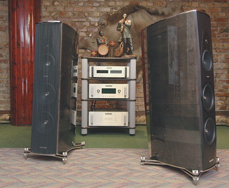

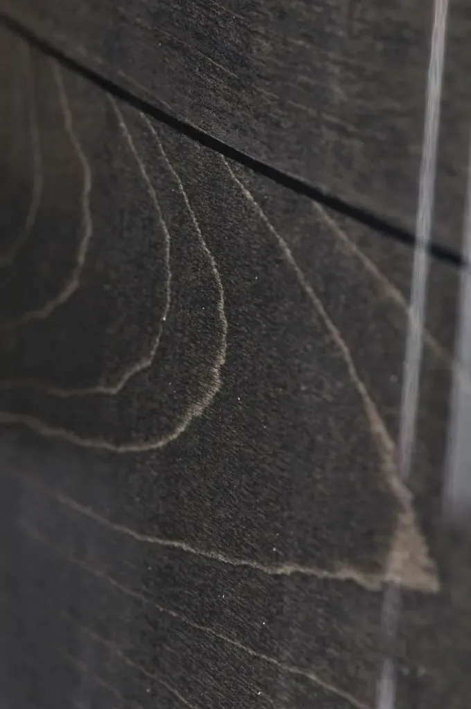

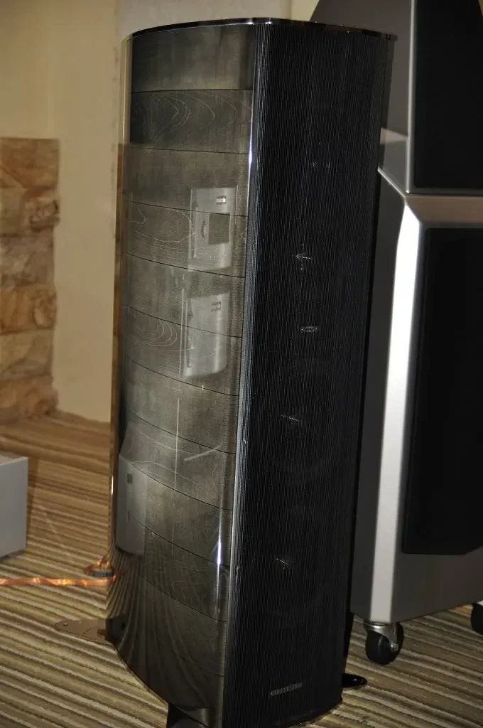

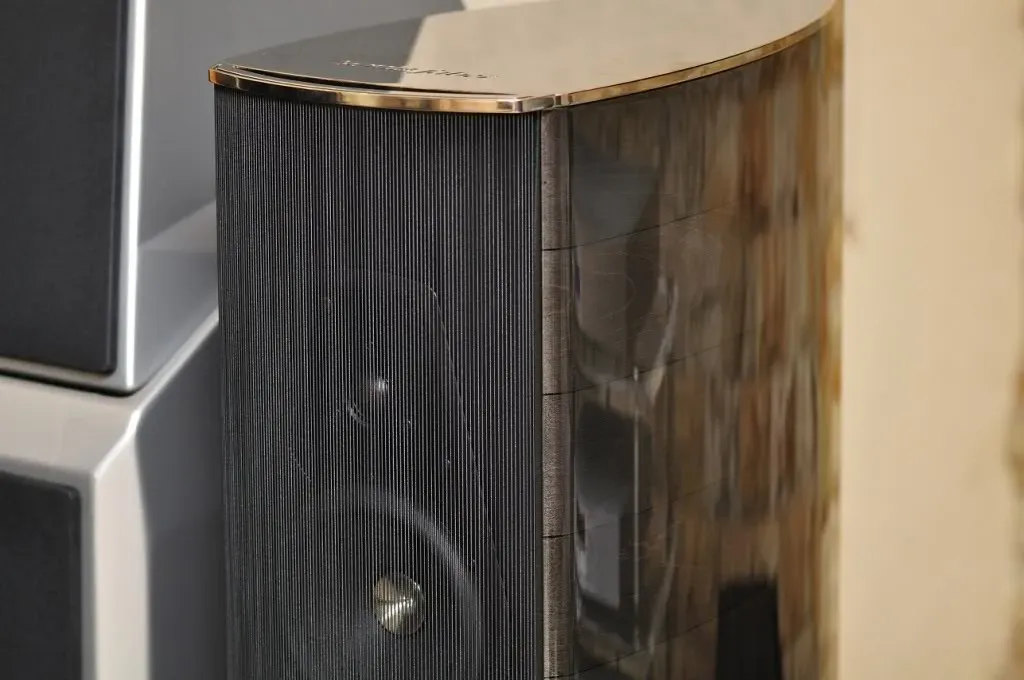

    How do you attain a finish like this?
    Is this just ordinary poly finished like you would finish a newly painted car, IE, sand, polish, wax?

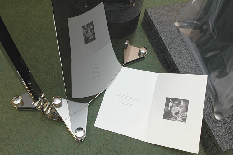

    Ah, what the heck, one more.

    • BigJim_inFLA
      • 203
      I would say many coats of lacquer, sand, buff, polish, wax.

        Do a search on "piano black" finish. This isn't black, rather a dark stain, but the steps to the finish are the same. Sand, buff, polish, wax, yes, but lots and lots of it!
        HAve fun,
        Frank
        • JonP
          • 692
          Basically a clear "piano black".... highly polished clear coat over stained wood rather than black lacquer. Looks nice.
          Seeing those again reminds me I had been thinking of how to duplicate the "screen of threads" grills.... another cool look.
            You have to stain the wood black and then sand it down some to keep the woodgrain light like that, but then yeah after that it's all the same as a piano black finish. You could make it easier by getting it clear coated at a car shop, or you can do it the long painful way by many coats of lacquer and hours of sanding and polishing.
            • looneybomber
              • 194
              So in my case, I would like to do veneered sides (not that black tint, but normal cherry wood) and piano black front and rear.
              Would it be best to lacquer or poly the whole thing, or do I need to use one on the wood and the other over the paint?
              Will lacquer provide a better shine than poly?
              What about acrylic urethanes that a lot of folks use in the automotive world?
                The automotive clears are likely to take more abuse and still be able to buff them out. Most wood finishes are soft and generally not incredibly thick so it's easier to get a scratch deep enough to damage the wood it self.
                I'm pretty sure you can use any of them over wood or paint though.
