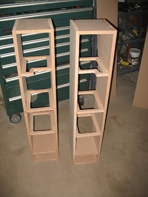

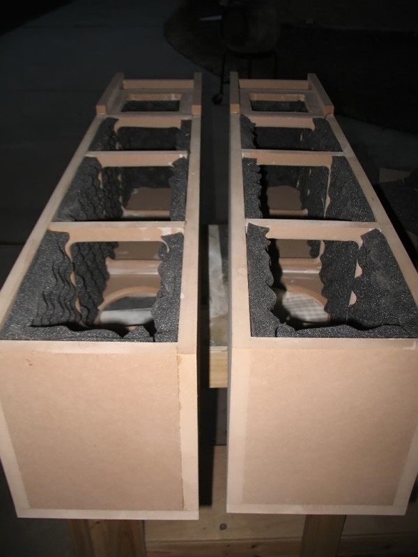

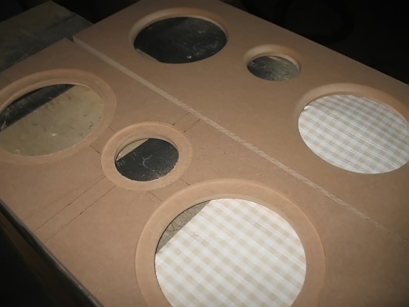

    I built the speaker according to the plans on the accomplished thread with the exception that I made them 1/2" deeper to gain some volume so I did have to make them so tall. Originally I built them sealed out of curiosity and not having PVC. Since then in trouble shooting mode I have ported them with a 3" port 11" long with elbow ported out the back. I also removed the damping material off the sides little by little until all of it was removed? Bass response improved but now they bottom out very easy and still have the staging problem, if thats the correct term?
    IMG 2365 - Start of the build. Bottom part will eventually hold the crossovers.

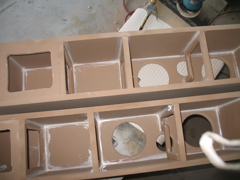

    IMG 2368 - Showing the recess and the back of the hole rounded over.
    IMG 2403 - Showing the caulk added for strength and sealing. Back support added for removable panel to house port.

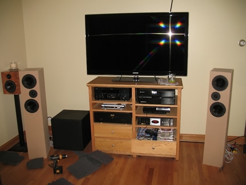

    IMG 2428 - Setup in the room. Unfinished and in testing stages, bubinga veneer awaits..

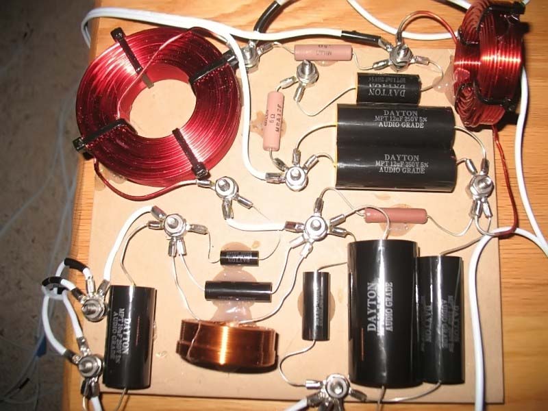

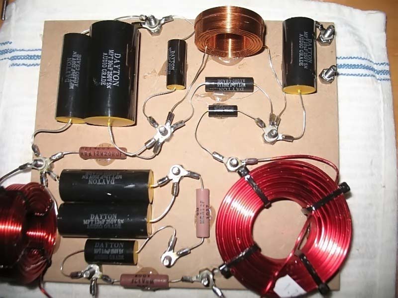

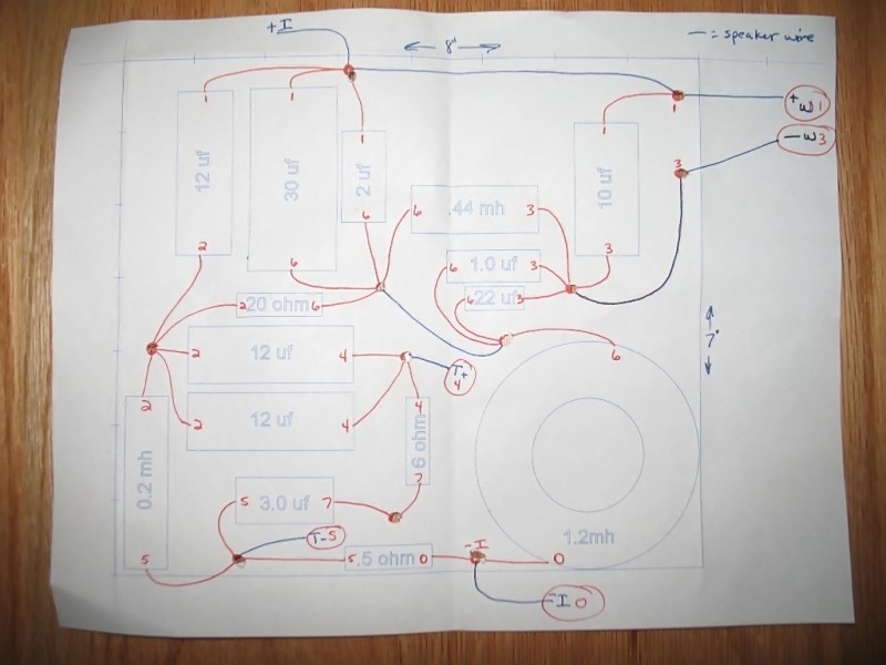

    IMG 2378 - Crossovers, stainless 10-24 bolts were used and ring terminals. Supra 15 awg wire going to the speakers.
    IMG 2395 - Close up of crossovers.

    IMG 2415 - Basic PE foam.

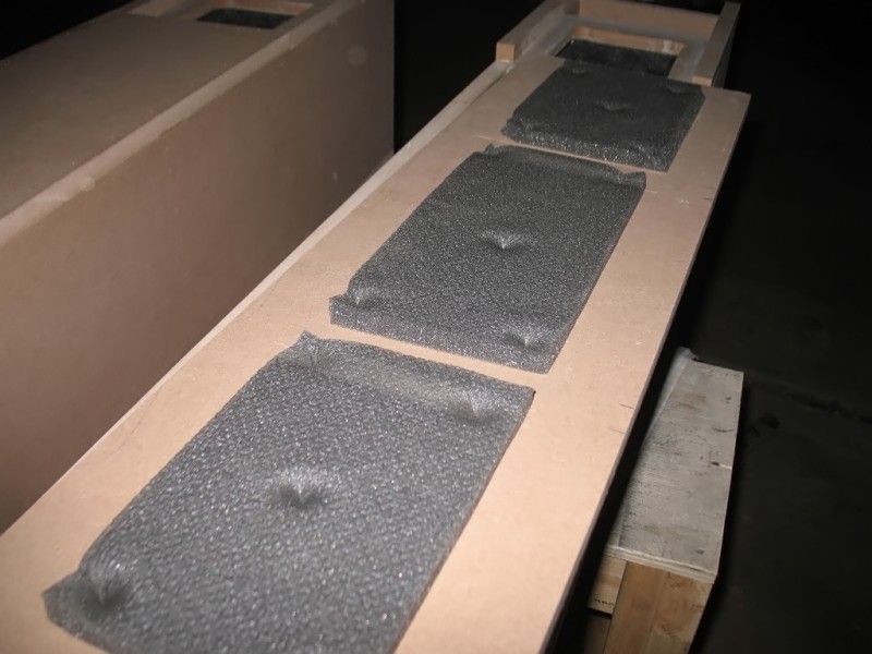

    IMG 2416 - Sonic bearer foam.
    Since the pictures were taken the foam off the sides of the walls was ripped out.

        On your crossovers, you are going to be MUCH better off soldering all of those connections. There are SO many places where you can have a bad connection with crimped ring terminals all screwed together. I'm not saying this is where your problem is, but any way you can minimize bad connections, you're going to be better off in the long run. One of the main things I've learned (the hard way) in manufacturing is to reduce the number of electrical connectors...they only lead to trouble.

          The total lack of any acoustic treatments in the room is shocking, and explains the problems with the high frequencies.
          Improper room placement of the speakers (asymmetrical boundary loading, speakers too close to the back wall, etc) along with the lack of acoustic treatments explains the sound stage issues.
          Are the crimp-on connectors and all the nuts and bolts made from nickel plated brass? They better be because iron/steel connections should never be used a crossover.

            Thanks for the comments, I will keep that in mind. I soldered the ring terminals to the components after they were crimped on. Probably a little overkill but better safe then sorry. When I did my Topaz's about 10 years ago I used the bolt method and they are still holding up solid. To me it just seems like a more solid connection.

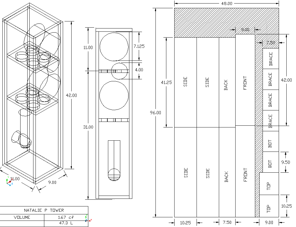

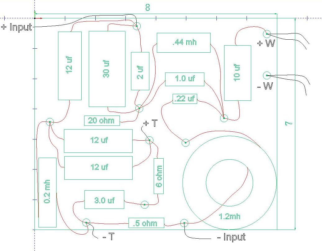

              It basically the same as the attached pic used from accomplished thread.
              I enjoy music and one day hope to have a dedicated room for listening to audio with all the bells and whistles. However, for now I gotta put everything in my living room and have to keep it toned down.
              The nuts and bolts are all stainless.

                  Your bracing looks good. Mine are 65 liter, simiar to yours.
