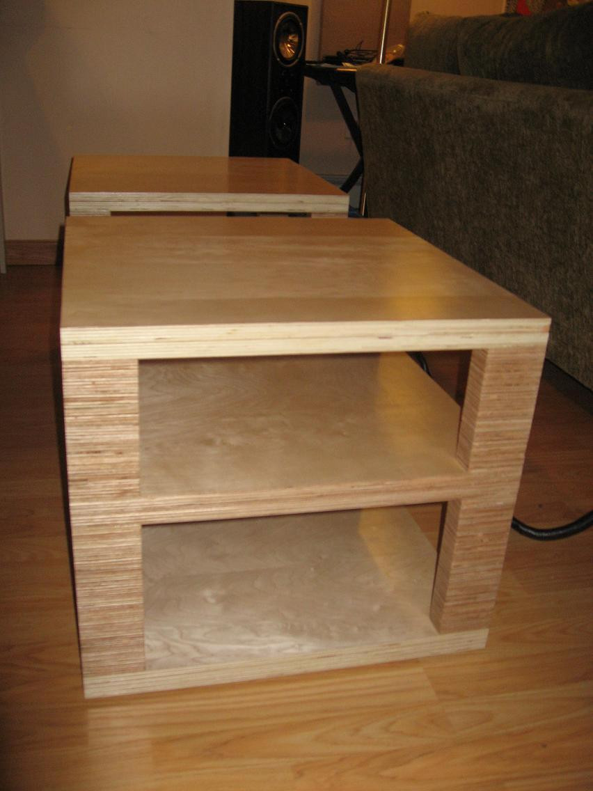

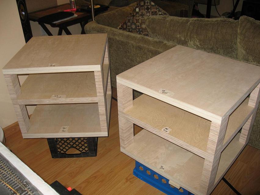

    Here's my newest project:
    I based this design off of:
    Credit is due to the original designer whom I don't know the name of.
    I built two so I'm able to stand my Modula up between them. TV will be mounted to the wall so it should give enough shelves for my components.

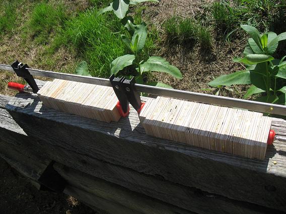

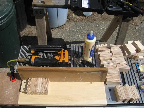

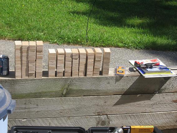

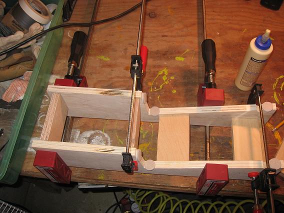

    I've attached some build pics. The risers between the shelves were made from 1.5"x3" of 3/4 Baltic birch stacked glued and brad nailed. I realized afterwords that it would have been easier to laminate strips of plywood then cut them into small pieces to save on time and make things more accurate.
    I plan on finishing with a clear coat but am not sure how or which one to use. I tested some polyurethane on a small piece and I didn't like the caramel color it left. My Natalie P's will be built of BB as well and finished in a clear finish so I want it to match. The only problem is they're being built by my pops in Wisconsin. I'd also like the clear coat to be hard and durable because the exposed edges are brittle and i don't want them to chip. Ideas anyone?
    That said I'd like to ramble on about some of the things I've learned as a novice wood worker. These are things that I'm sure everyone is going to go "well yeah" or "DUHH" but here we go.

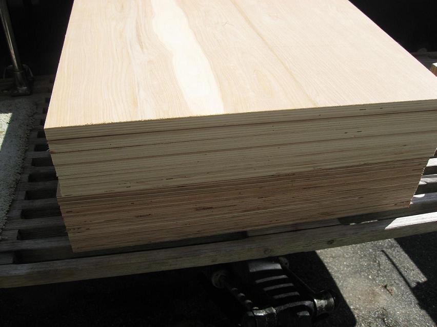

    1)Cheap plywood is just that, cheap plywood. It's got more voids than Emmentaller. And isn't very structurally sound to boot.
    2)Excess glue equals excess sanding. Holy man my arms are sore.
    3)You can never have enough clamps.
    4)Speed square and large squares should be your best friends.
    5)You can't sand somethings square.
    6)Wood putty works wonders, if it matches and if it stains well.
    Anyway, I'll post some more pictures of the finishing process when I get there.

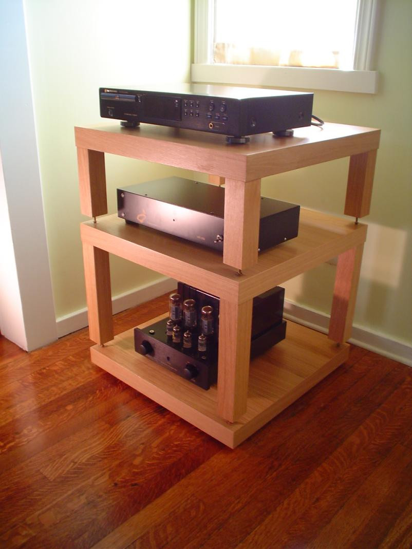

      Here's more inspiration for my interpretation:

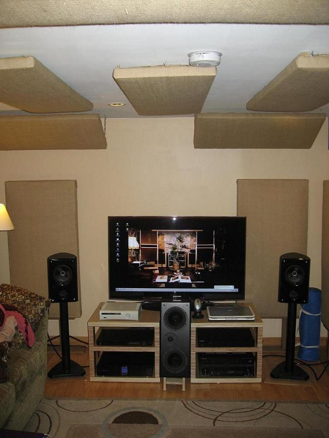

      I'm considering putting the Dayton spike feet on the bottom to help with isolation and to give it a cool look. Otherwise I'll end up just putting one piece of "riser" on each corner. Input?

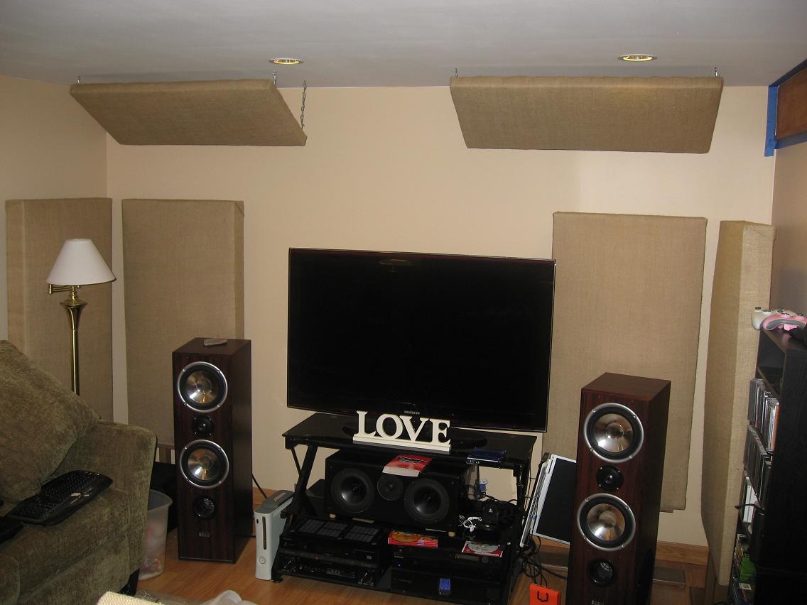

      I guess I built this for two reasons, first to match my new coming speakers and second to isolate my components from one another in hopes it will help with how my whole system sounds. Attached is a picture of my current setup. See the laptop wired to the side? Lol, yeah I'm trying to go for a cleaner look.

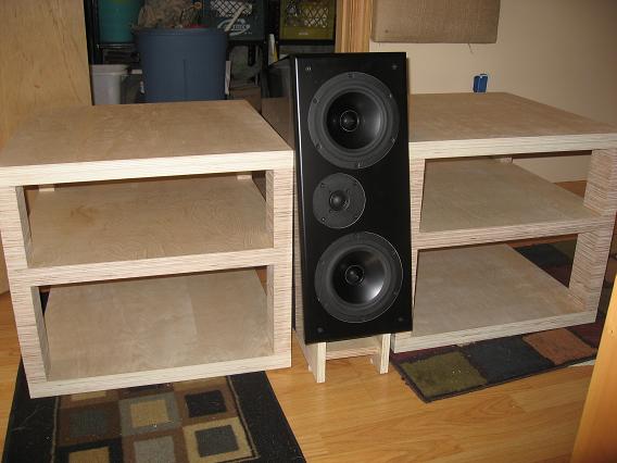

        Update

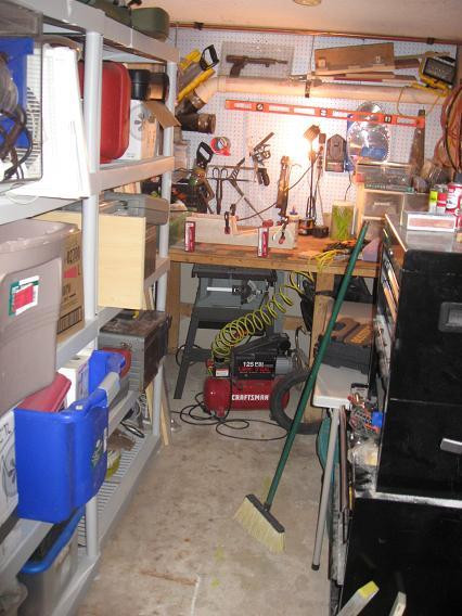

        Final sanding is done and I threw together a stand for my CC. Also some shots of my "shop". Yes it is a storage closet. Haha, I make do and play outside most of the time.
        Does anyone have advice on what clear coat to use? I may just leave them as is but am concerned about durability.
