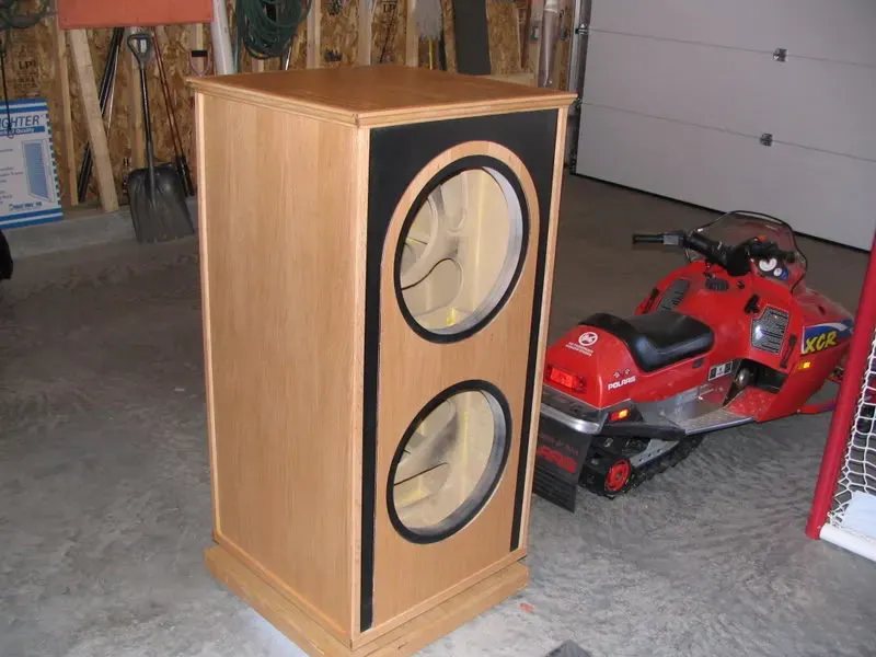

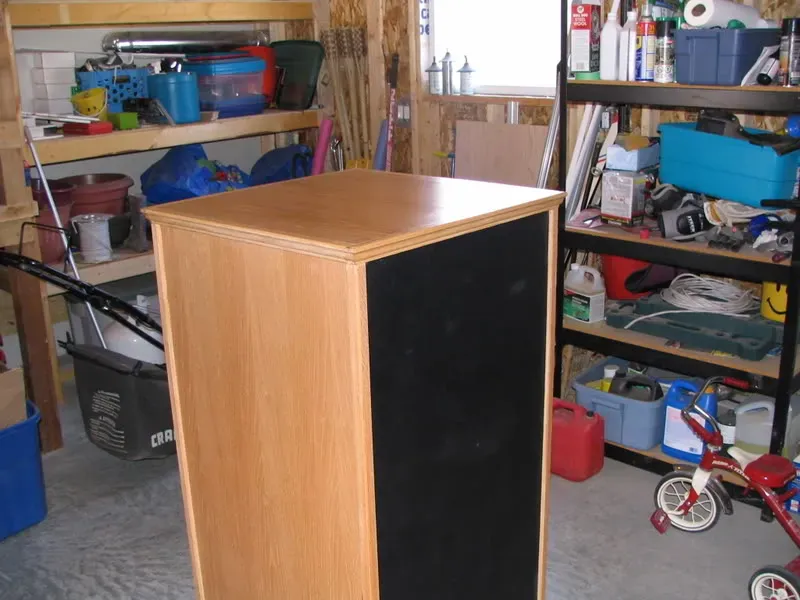

    I'm wondering if something should happen next? I've sanded, stained, wiped off stain, now should I put a coat of some type on top?

    Does that fit through your door? :E
    ~Brandon 8O
    DriverVault
    Soma Sonus
    • Bent
      • Sep 2003
      • 1573
      Hehehe, yes - the sled beside it is a mini-Indy, not full sized.
      I built a enclosure for two 15" Soundsplinter RL-p's in a sealed config, double 3/4" mdf with 1/8 oak veneer core ply on most sides, some trim, etc. It's my second subwoofer project and my first attempt at making something look acceptable.
      It's 24"x24"x50"
      • gmed
        • 221
        polyurethane. I personally like the wipe on.
        tough finish that will protect against moisture better than lacquer.
        • Bent
          • Sep 2003
          • 1573
          Brian mentioned Old Dad's in another thread - does it leave streaks? or do I sand it with fine grit sandpaper? (4/0 steele wool?)
          pardon my ignorance, this is new to me
          • gmed
            • 221
            let dry 24 hours in between, fine sand, then apply another coat. I used about 6 or 7 coats. I use wet-sand paper, not steel wool. wipe off with damp cloth, then apply the poly with special cloth that will not leave any lint behind.
            try not to use coarse sandpaper since it will take off most of the finish. Keep in mind, you're applying it by cloth, not brush, so layers are gonna be thin.
            Also, the instructions on the can are pretty good. I would use a sanding sealer before the poly though. It will bring out all the grains and it will help you attain a smother finish.
            the instructions below will help you. I would just use the wife on instead of brush on, since almost anyone can apply the wife on the first time.

                • Brian Bunge
                  • Nov 2001
                  • 1389
                  No, the Old Dad's does not leave streaks. And only use the Minwax stuff if you cannot find the Old Dad's locally. The Minwax looks like plastic. The Old Dad's does not.
                  These are the recommendations for the Old Dad's:
                  1) Sand with 220 grit sandpaper and wipe off with a tack cloth.
                  2) Using a lint free cloth, wipe on a thin coat of poly.
                  3) Let dry 4-6 hours and then apply another thin coat.
                  4) Let dry overnight and then sand lightly with 600 grit sandpaper, wipe with tack cloth, and apply another thin coat.
                  5) If you want to add more coats you can repeat step 4 every 24 hours.
                  I get the best results with at least 5 coats, but then I like a nice semi-gloss finish. I've got some small cabinets with red dyed birds eye maple veneer that has about 10 coats of semi-gloss on them. Maybe I'll finish them one of these days and post some pics.
