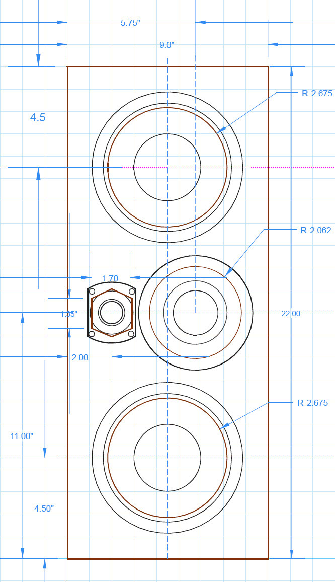

        RS180-based WMTW design in-progress
        Jon Marsh is currently working on a WMTW "center" design that uses RS180's, an RS52 and a Vifa D26NC55. He's also doing a HiVi D6.8 option. All of these are designed to fit into a pre-made PE 1cu/ft MTM box. This should be an outstanding 3-way design(s).

          Originally posted by technimac
          Jon Marsh is currently working on a WMTW "center" design that uses RS180's, an RS52 and a Vifa D26NC55. He's also doing a HiVi D6.8 option. All of these are designed to fit into a premade PE 1cu/ft MTM box. This should be an outstanding 3-way design(s)
          I don't think we've discussed this on the forum, but Jon's WMTW so called "center" will be a speaker that can be used for any channel = main, center, or effect.
          Jon's plan is to use 5 of these for his HT.

                Originally posted by Bent
                Thomas, is The crossover Topology such That it will perform admiraly either on it's side, or on end?
                (I used a Tablet PC to type This)
                The center (horizontal orientation) will have a slightly different XO.

                There will certainly be a no BSC XO build option.

                                                                          Alright! I moved into a new place and finally have space and the will to finish out my HT setup. I have a secondhand amp and my mains (Design here: http://www.htguide.com/forum/showthread.php4?t=27055) so I need some surrounds and a center channel. (Only 5.1 for now ) I was thinking of doing...
