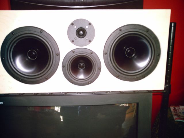

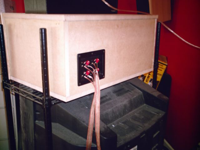

              • dynamowhum
                • 260
                I love this WMTW
                I built the WMTW my first full range speaker project. I built an IB sub first and my old center just could not keep up. I can not praise this unit enough wether it is dialog or special effects or music. I am now in the process of building the Natalie Ps. You wont go wrong building this thing. That being said this thing is big and heavy about 70lbs. The picture is with it on top of my 32" hitachi crt
                What size room do you have? If you have a small room this may be a project overkill. Do you have all the tools? Your first build will cost more if you don't have them. There are all sorts of odds and ends you will have to come up with along the way. In short you can make this DIY or DYI Do Yourself IN. With carefull planning and asking questions here this is a very doable project.
                Your right about not noticing the bass cause your center suxs just like mine did.Cheers
