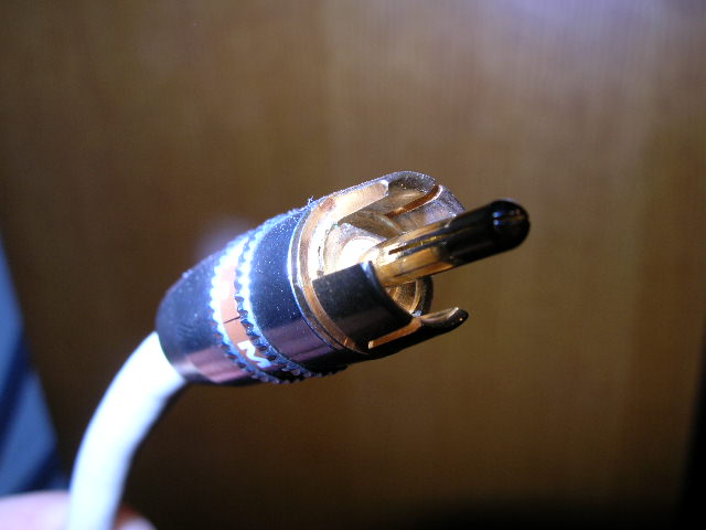

    I want to make a subwoofer cable with a RCA connector and a 1/4 mono plug. I am planning to use a old MonsterBass™ 300 Subwoofer cable and use the one of the RCA on it and cut an end off and solider a 1/4 mono plug on the other end. Now the question is what a good 1/4 mono plug that will fit on this cable and should I even use the monster cable or get a different cable? I all ready have two of these cables one is in great condition that I dont want to chop up but the other is not even being use and has 1 damaged rca connector anyways. Any Ideas what do you guys think. Here's a pic of the damaged RCA if you want to see.

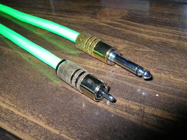

                        So here it is My finished RCA to 1/4 mono subwoofer cable. I got to say it did just what I thought, I now get a better single from my receiver. I no longer have to set my sub out to +5 or more to get good bass it is now strong and thick at -1 or 0 on the receivers sub output setting :B There is a nice improvement from what I had before using a rca monster cable subwoofer cable and one of these
                        Maybe I got a bum adapter or something but regardless the case I'm never going to look back. And a Thanks to Owen Bartley for the Techflex idea. I had some left overs from my PC project that I would have never thought of using for this.
