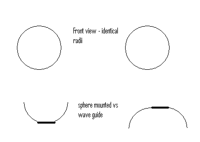

                                          Is diffraction on the baffle edge less of a concern after using a wave guide?
                                          I've been working on a design where a neo3 tweeter is basically suspended in space on the face of a half-sphere.
                                          If I put a wave guide on it does that obviate the hemisphere baffle?
                                          rough sketch attached

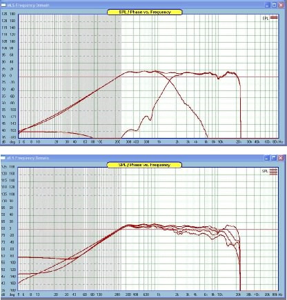

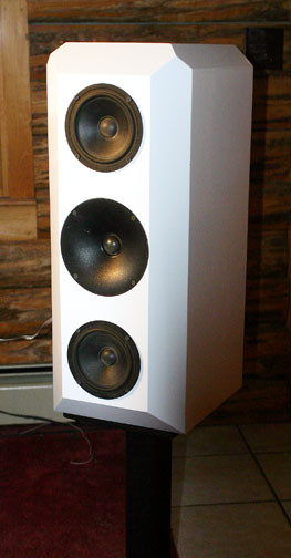

                                                  Not sure if this is of interest or use to anyone reading this thread, but here are some measurements I obtained from an MTM with waveguide-loaded tweeter. The top graph shows, both woofers, tweeter, and their sum, all at 1 meter on-axis. The bottom graph was obtained at tweeter height, and 0, 15, 30, and 45 degrees off axis. There are 5 dB separating each horizontal grid line. Ignore the low end rolloff because the plots do not include any nearfield woofer measurements. The overall downward tilt of the response was done on purpose.

                                                  The speaker, and a close-up of the modified MCM waveguide, are at the following links. The crossover is passive.

                                                  The drivers have been around quite awhile. It's a ScanSpeak d2900-9300 textile tweeter, and two Vifa 5.5" P13WH-00-08 woofers. The excessive woofer separation is a result of the fact that I modified a cabinet I had originally built for another purpose rather than starting from scratch.
                                                  I posted this on DIYAudio but triggered no interest. Since this seems to be a kinder and gentler forum, I thought I'd risk giving it one more shot.
                                                          Depends on who you ask. Earl Geddes certainly thinks it should be a concern.
                                                          It won't hurt to have a bit of round over of the baffle edges on your monopole, so why not.
                                                          Don't be so sure of that . Hey, good job. MTM's aren't my bag, but heck, you had the enclosure with cutouts already, why not give it a shot.
                                                          Congratualations on the new job, and hope your real estate changes are completed smoothly!
                                                          Thanks Jon. Not as new as it was 9 months ago . My real estate woes continue until I can find a decent tenant for my loft :banghead:
                                                          No more students LOL. The new listening space is quite a bit deeper, but only 1/2 as high. Most importantly, much further away from the neighbors, although I'm afraid the SPL capability of the new system might negate that :lol: .

                                                                              I had some posting in Jon's Isiris thread about my results with waveguides and Seas T29CF001
                                                                              here
                                                                              and here
                                                                              Now I made some follow up tests.
                                                                              I first planned to try the Vifa XT25 in WG but that is not very easy to do. The construction of XT25 is such that the front plate extends backwards to meet the surround of the ring radiator and if the front plate is removed it is very hard to do the same effect with WG. To leave the front plate in place would mean modifying the WG physically which I do not want to do just yet.
                                                                              So I tried two thing instead.
                                                                              First I inserted felt rings between the T29CF001 and WG to make the dome sit deeper in the WG throat.
                                                                              I hoped it will help the situation with the 8kHz and 16kHz dip. The result was basicly that the WG lost it's "magic" meaning the lower end gain was not there anymore. The response looked like a regular tweeter with extra dips in it
                                                                              The second attempt was with a Seas 27TBFC/GTV in waveguide.
                                                                              This worked much better.
                                                                              Here is a comparison of T29CF001 and 27TBFC on axis and 15 degrees off axis (levels intentionally offset)
                                                                              On the on axis response the dips are still there but a bit less severe.
                                                                              The off axis is even better with 27TBFC/GTV.
                                                                              The off axis for T29CF001 in WG
                                                                              And the off axis response of 27TBFC/GTV in WG
                                                                              For the last a graph of the 27TBFC/GTV in WG plus a first order electrical filter
                                                                              This gives quite perfectly the 4th order LR HP response for 1kHz crossover.
                                                                              If this tweeter could handle it - I do not know yet.
