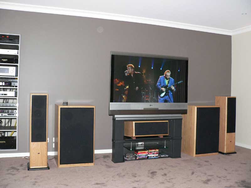

    Our new house is coming on well, and I thought I would post a few pictures of my new HT room.
    The room is 5W x 7L x 2.6H metres.
    It has acoustic insulation in the walls and the walls and ceiling are done with 2x layers of 10mm plaster board.
    The first photo is looking to the front of the room; the cutout to the left is for the audio rack.
    The second photo is the cupboard behind the HT and allows me access to the back of the equipment. As you can see I have fitted this off.
    The third photo is of the back of the room where I have allowed for 6x surround speakers. These will be mounted on custom built shelves yet to be made.

      I have custom built mains & centre speakers, and B&W 602’s for surrounds. I will be running 4x subs of which 2x are custom built, these are controlled by a Behringer DEQ2496 & DCX2496 to correct their in room response.
      Rest of the equipment is Rotel RSP1098 and RCD1072, Denon 3910 DVD, Elektra DAC and Benchmark DAC1, Elektra Theatre 7 amp and Elektra Reference amp.
      That’s roughly it at the moment.

          Currently using LG 60” (152cm) LCD RP, it will do until I find something better, as I have been concentrating on the audio side first.

                                                                    Okay just a couple of photos re progress of the new room.
                                                                    The new chairs still haven’t arrived, so using a couple of recliners for the time being. The rear shelves are installed still require finishing touches, the side shelves haven’t been installed as yet, later this week I hope. BTW those are B&W 602 speakers on the shelves.
                                                                    The rack still has a couple of other devices to go in, the main one being another power amp. The rear is still a mess as I started to make up custom leads, but wanted to test things out first, hence the use and mess of leads all over the place. I am afraid patience is not one of my virtues.
                                                                    Anyway you get some idea of how it is progressing.

                                                                      Hey Spearmint,
                                                                      Truly worth drooling over!
                                                                      Well done mate, can't wait to come over for a listen. The finish on your custom speakers is blending in really well, who would have though that those subs would look smaller!
                                                                      Nice work, if it sounds half as good as it looks then it must sound fantastic.
                                                                      Have you had time to dial all your subs in yet or are they still just delay and levels?

                                                                        Thanks for the kind words, it sounds quite good, although I am going to look at some room treatments.
                                                                        I have not done any room sweeps as yet, the subs are just level matched using the test tones and SPL meter.
                                                                        Still haven’t set up any of the computers, I was lucky to get as far as I have with the HT room, the wife has different priorities to me. :B

                                                                                      Great room Richard. I bet it sounds as good as it looks.
                                                                                      That appears to be Joe Walsh paying you a visit. Melbourne concert?

                                                                                        Thanks for the compliment.
                                                                                        Yes I did go to the concert although not to any of the filming sessions.
                                                                                        So far I am really pleased with the room, and have had a few guys over for some listening sessions, so far have had positive responses not only to the look & feel but also the sound. Had a bit of a session last night with a friend who plays bass and he was just so stoked with the audio.
                                                                                        Did some room sweeps today (subs only) and had a huge room gain centered at 29Hz, so had to pull that back 12dB on the front two subs and 8dB on the back two, from around 25~34Hz to tame the large node. Otherwise just requires some more fine tuning to get the rest flattened out.
                                                                                        Before I get too carried away with EQ I will move the subs to try and minimize or cancel some of the room gain. I have been looking into some room traps but the ones I have looked at so far available locally only go down to 50Hz.
                                                                                        It is amazing when you play with delays & phase how it affects the in-room response when using multiple subs, this is what I use the Behringer DCX2496 for it gives me total flexibility for each sub.
