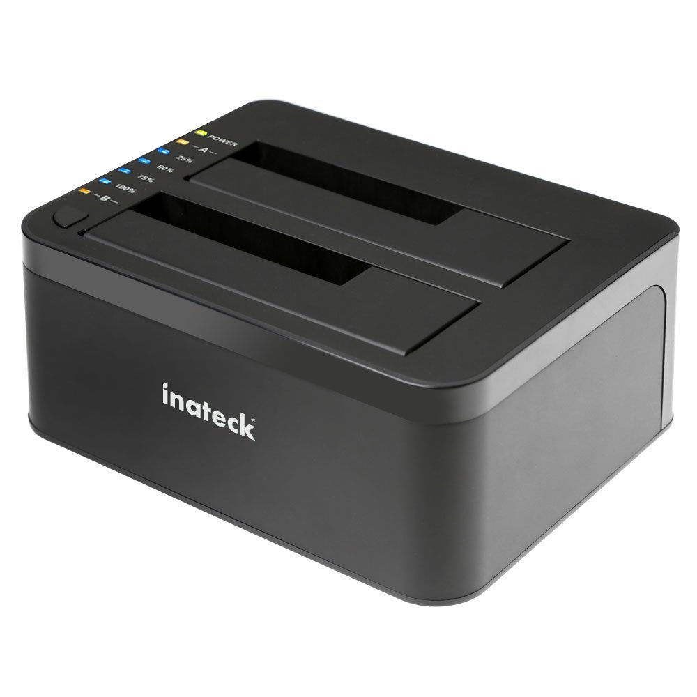

                    Also just ordered this fella for backups:

                        Jason, wasn't Inatech one of the company names in the movie "Office Space"?

                          It was spelled "Initech" in the movie.

                                          I posted a 2-bay (they also make a 1-bay) USB 3.0 docking station earlier in this thread:
                                          Discussion of HTPC systems and products, DVD drives, system configuration issues, personal computing and gaming systems of all kinds including internet applications, other peripheral devices, and game consoles.
                                          But there's a TON of HD enclosures that are just enclosures.
                                          I prefer those to the "all in one" drive/enclosures as they allow you to swap multiple drives in and out, they let YOU spec whatever hard drives you want and upgrade them whenever you want etc. Just far more versatile/flexible.
