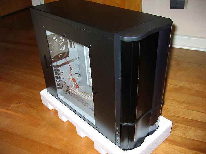

    THE CASE: COOLERMASTER - CAVALIER 3 CAV-T03
    There's a lot of goofy super-hero cases around that I didn't want. I was looking for something that was solid, not too expensive and didn't look like Spiderman designed it. I had to acquiesse on the see-through side, but anyway I think this is a great case for the money. I like the two case fans - the rear one is a 120mm..... The thing is really well built.

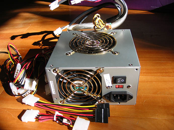

    THE POWER SUPPLY: ENERMAX-460w Dual Fan Power Supply Model: EG465P-VE FC
    Both Enermax and Antec make good supplies. So, I bought a 460 watt dual fan Enermax.
    It has an internal case temperature probe, all the SATA conectors, RPM fan connectors, plus it shuts the second fan down via the motherboard. All the connectors are gold and the shielding on the cable is well done and it seems really well built. I decided against the one with the external speed control pot and got the model below it.

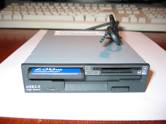

    Here's the rest of my parts - I really like the Floppy drive that reads CF cards with USB2.
    MEMORY: KINGSTON Dual Channel 1024MB PC3200 / DDR 400MHz Memory (2 x 512MB) KVR400X64C3AK2/1G
    DVD WRITER: TOSHIBA SDR5272 / 8x4x12x DVD±RW / 32x10x40x
    DVD ROM: LG 16X GDR-8163B
    MITSUMI 1.44MB + 7 in 1 MultiCard Reader Combo Drive

            Geez Fred, I hope my model isn't noisy, because it was one of the reasons I chose the ENERMAX EG465P-VE FC. The fans are temperature controlled and it's supposed to be a quiet unit. But who knows.... 8O
            Here's an except from a review: http://www.bjorn3d.com/read.php?cID=305
            "One such example of a high quality power supply is the Enermax EG465P-VE FC. One of the highlights of this 460 watt power supply is that it automatically adjusts the fans' speeds based on the temperatures it measures. The bottom fan's speed is based on the temperature measured by a thermal sensor inside the power supply. However, the rear fan's speed is controlled by the temperature read by a thermal sensor that is attached to a short wire that can be placed anywhere it can reach to monitor the temperature at that location. Apparently, Enermax is also claiming that this is a very quiet power supply, since the word whisper appears on every side of the box. Read on to find out if this power supply can deliver serious power while keeping its cool without making a lot of noise."

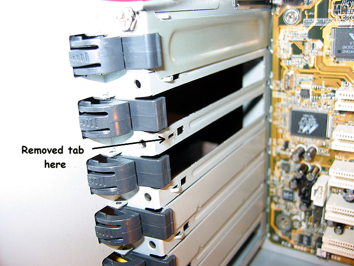

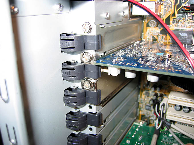

                I did have a small mod I had to make to my CoolerMaster tooless card slot system. The clip system holds the card in tight, but to keep the PC boards from moving up and down they have small tabs on each slot that the board fits between. They didn't consider the fact that there are a few double width board around and that the tab would stop one of these double width boards from seating properly. My NVidia card is a double width board. I simply filed one of the slot tabs down and it worked great. Of course I still used screws even though there not required.
                Here's a pic of the tab filed down and then one of the double width board in position.

                Here's where I filed the tabs down to fit the double card.
                Here's the video card in place.

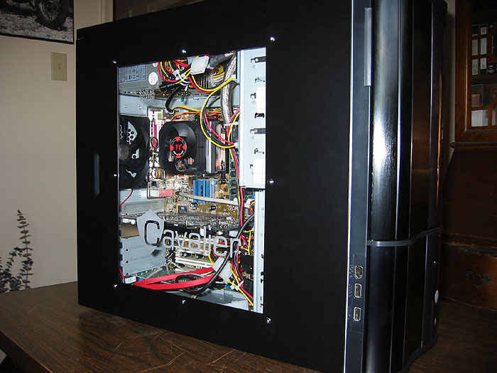

                Here's the finished side view.

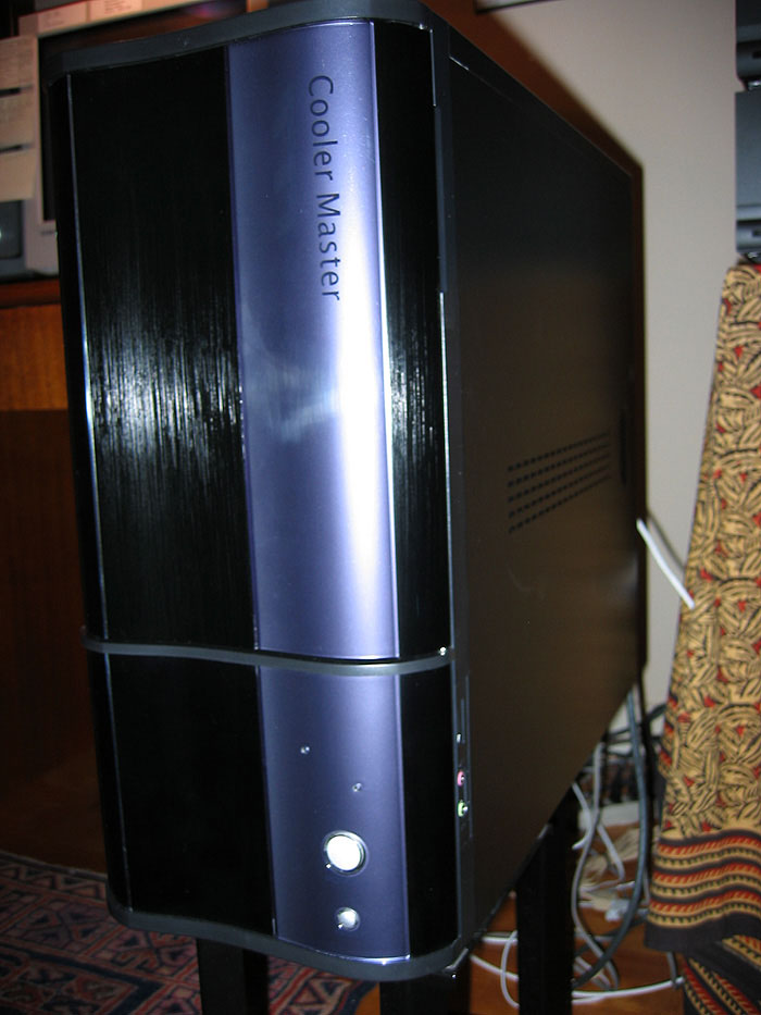

                Here's the front of the case. You can't see it, but the power and disk lite are a very cool blue.

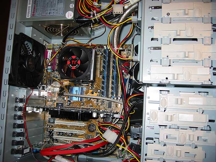

                Here's a pic of the insides..I better clean up my wires a bit.
