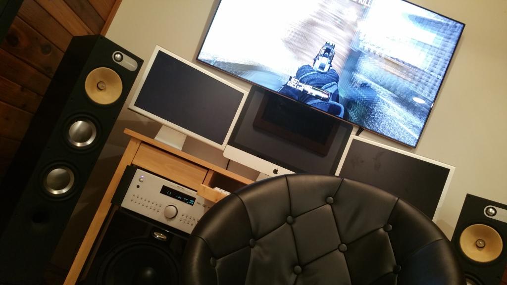

    Current configuration in my gaming/music room:
    Rotel 1055
    B&W 683 S1
    Velodyne DLS4000R 12 inch subwoofer
    This is very much a near-field setup with the 683's (see pic)
