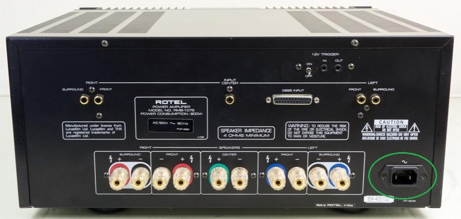

        If you look at the IEC AC power inlet on the amplifier, you will see that is only a two blade (ungrounded) receptacle, which explains the power cord having no ground pin, and even if you inserted a grounded three blade power cord, the ground wire would connect to nothing.

            Originally posted by madmac
            I have serious doubts that this unit uses only a two prong power cord ! It might not be the original OEM power cord. Check with Rotel on that one !
Name:	Rotel RMB-1075.jpg
