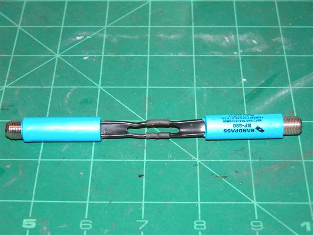

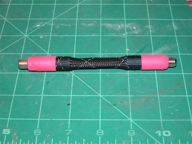

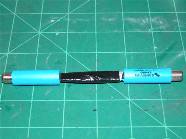

            Sure, all it was was using 2 x 75ohm to 300ohm Baluns transformers I had kicking around.
            Here I just soldered the ends together
            I had some mylar foil shielding I robbed from scrap Cables, and bound it with electrical tape.
            I wrapped it in expandable mesh and shrink wrap to finish it off.
            I think a person can buy a straight 75ohm to 75 ohm Baluns transformer (like the Jensen), however I had these sitting around, and I like messing around with DIY stuff :W
            Let me tell you, my Hum was wickedly loud!
            The "Bingtech Hum buster" :lol:
            Bing

                    Originally posted by GRCRYSTYK
                    I had a cable humm, and built a unit just like Bing's. Didn't work,....Not even a little.
                    The problem you had was you did not use true isolated transformer baluns, yours were a common ground type.
                    You can test if the balun is isolatated with a multimeter. Measure the resitances between all input and output pins. If there is no conenction found between input and output, then the balun is isolated and can be used to make the example above.
