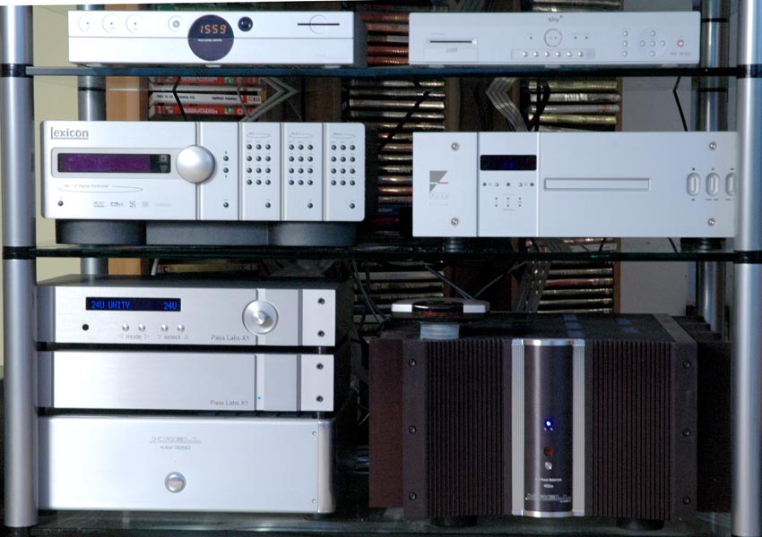

              I think I've seen your setup before, but do you have a picture of what we are talking about?
              I make sure the back of my cabinet is completely open, but other than that, I do not have a huge space for my MC12.

                Lex,
                Its open ALL around the sides, just sitting on glass shelves. The problem of heat my be that I have the fpb400cx on the shelf below it. There is a lot of space above the krell but the shelf the mc12 sits on is "warm", but the space above was only 1/2 inch, otherwise open all around.
                The repairman said the damage to the Power supply section was extensive and could not say what really caused it. He did said indications appeared at the "low voltage" end of the power switching. so it was not the initial arrival of current but after.

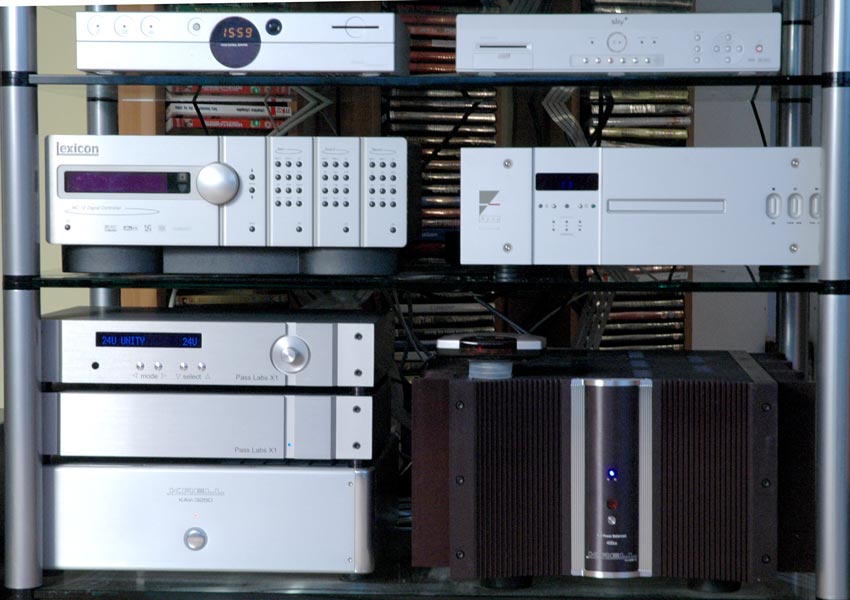

                  Lex,
                  here's an updated image with the Lexicon on a new shelf with plety of air space above and around it. I also moved it to be above the X-1 Preamp which creates less heat than the fpb400cx.
                  all things considered, I just think it was the luck of the draw that it happened.

                        • 27461
                        I like the current layout. You should have no system heat issues from that spacing. That is one fine looking system, that's for sure.
