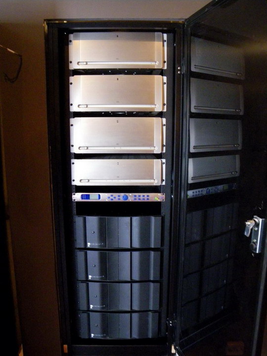

                      It does not have the space requierments set by Parasound, it is placed in a rack cabinet as unit # 3 from the top in the picture (unit #4 is now a A21 not a A52 and a A23 is comming in for the center speaker. The 4 other amps in the bottom are JBL Synthesis S800 for the subwoofers, the EQ has been placed in another cabinet)
                      However so does this cabinet have a pretty good circulation through a remote fan, the temperature at the top of the cabinet does never go over 40 degrees celsius.
