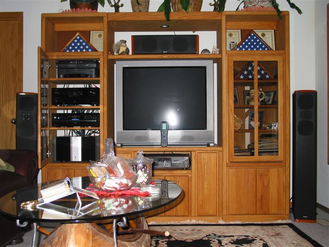

    How are most of you handling the heat issue with Halo amps? I went to a dealer the other day and he had two JC1 monoblocks sitting on the floor wide open with nothing obstructing the back top or sides. They were powered on but had no signal and nothing was playing. They were hotter then hell!I could not rest my hand on top of either one of these amps for more then a few seconds.
    My understanding is that the A51 is also a class A/AB amplifer and I'm concerned that heat will eventually kill it. I haven't made the purchase yet but will be auditioning one the week after next.
    The cabinet I will be putting it in has a hinged oak framed door with glass inserts. The dimensions are 12" H x 22 1/2" W. The cabinet is open in the back.
    Here's a picture of cabinet with the door open on the left and what it looks like with the door closed on the right. The A51 will take the place of the Rotel RMB-1095.
    I see several pictures of Parasound amps stuck in a rack with very little clearance between components. How are they handling all that heat? Are you guys using fans? Should I be worried?

    Unless you have adequate clearing (I think Parasound recommends atleast 6 inches) on top, and a few inches to each side, you should strongly consider the use of a fan. I use a Sharper Image spire fan that automatically turns on once my system powers up via a switched outlet from my line conditioner. I know others have had success using computer fans, or even fans specifically designed for home theater installation use.
    Ideally, you'd place your amp/s on amp stands on the floor. However, that sort of space is a luxury most people can't afford. Only demo rooms.

          The A51 placement guidelines in the manual call for 3" space around both sides and 6" above the top. The manual also advises do not to block the front of the A51 behind closed doors during use and do not stack with other components inside a cabinet unless you use a fan.
          I suspect the guidlines are conservative. Class A operation of the A51 is only the first couple watts and the heat sinks are massive. I have my A51 installed at the bottom of an open rack with about 8 inches clearance above and several inches of clearance on all sides. After driving my 88 dB efficient speakers for several hours at normal listening levels (75 dB calibration with 100 dB peaks) the A51 is only slightly warm to the touch. Certainly no warmer than my prior amp, a Rotel RB993.
          The A51 is a couple inches shorter than the 1095 which will give you more clearance in the same space. Side clearance may be a concern. I suspect that provided you leave the cabinet door open during operation and ambient temperature of the room is comfortable, the A51 should be fine. You can always try it in your cabinet and monitor temperature levels to determine whether a fan is prudent.

                  Do you think it will run hotter then my Rotel 1095? If it gets to hot I might just remove the front door.

                        Mitch, take a look at our Parasound picture thread here in the Club for some ideas. I rackmount my Parasound equipment with Parasound-designed vents inbetween the components for cooling.
                        As far as stuff at your dealer, remember that your dealer is going to be playing things LOUD and with as much power as he can put into it to entice buyers. So like Peter alluded to, I wouldn't worry about JC1's being that hot in your system, much less the A51. I have the A51 and A21.
