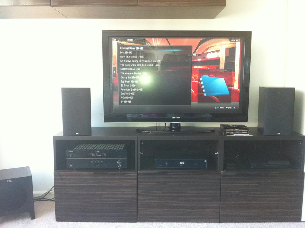

    I've had my setup for a couple of months with 2 x 685, 2 x M1 and an REL T5 Sub.
    Now its time to buy the CC. I haven't auditioned any speaker but from what I've read common sense choices are the HTM62 or another 685.
    There is one last variable to consider and is the space I have for the CC. As you can see on the pic I need to move the Cable Box and place the CC inside the cabinet. The HTM 62 will just fit but it´s rear vented while the 685 (a bit smaller) is front vented. Any views on how performance will get affected by this?
    Does anybody know how to get just one 685?
    BTW, I don't want to spend more on a CC than what I've spend on my fronts. The HTM61 is too big for the cabinet and a bit over my budget.

    dmiranda,
    First of all, welcome to the forum! :T
    You have a nice system. The center channel is definitely needed for the full HT experience.
    Now to your placement issue. I would strongly recommend, if at all possible, to not put the center channel in a box. If the entertainent center is deep enough, then move the TV back and place the center channel on the front edge of the EC. This will be a MUCH better option. Besides not being in a box, the CC will be better aligned vertically with the main speakers. A desired result.
    If it must be placed in the box, put the edge of the speaker outside the front edge of the EC. This will reduce the compression of the sound that is occurring.
    Hope this helps.

      Thanks for the advice htsteve.
      Unfortunately there is not enough space to move the TV backwards and fit an aligned CC. But I will follow your advice and try to place the CC as forward as possible inside the box. Thanks

        Looking at your photo I would suggest downmixing the center into your L/R mains (phantom center) and not adding a center. Unless someone is sitting way off axis this is likely better then a HTM62 or 685 on its side stuffed into the cabinet, and a lot cheaper.
        It looks like your mains are only ~55" apart, and should have no trouble filling in the center.
          I normally would agree with everything stuofsci02 would say, except for this. I personally never had luck with downmixing/re-matrixing channels. I could always tell a degradation in sound quality (similar to all those fake on-the-fly stereo into surround modes). And I'm not one who's against extra signal processing if it's for the better. In fact, I use Audyssey along side of a little manual EQ. But on the fly channel re-matrixing has never worked out for me regardless the brand of processor. Personally, I'd reconfigure your setup to accommodate a proper center speaker. Wall mount the display, sell the stand and get another, etc...

            Stuofsci02,
            That makes sense and its how I first though my setup would work. Unfortunately, I feel that usually dialogues don't have the same volume level as the regular front soundtrack. I thought that having a separate CC and the option to adjust the CC level would help this.
            Maybe I'm wrong and I hope I am. That way I can save $500 for something else. But I'm really getting frustrated with the problem I just mentioned. For example, I just bought LOTR Blue Ray extended versions and I have to turn up the volume for the dialogues and down for the battles. This happens with all movies. What can be wrong? Before someone else answers: yes, I'm completely sure I'm using the phantom mode, and yes I can hear the dialogues, but they are just not as loud as the rest (I would say around 20% too low).

              dmiranda,
              I like what emig5m suggested, wall mounting the TV. But mounts can be a bit expensive. So a two step process might be the way to go. First, get the center channel. I think this will definitely address your dialog issue. Soundtracks are designed for center channels, so not having one will be a detriment.
              Then later, buy a wall mount an move the TV up there. It not only will open up space on the EC for the center channel, but it will be a much cleaner look. Makes the room look bigger.

                dmiranda,
                How are you doing the center down mix? Is it through a reciever or BR player?
                I agree with emig5m that a reconfiguration of equipment to include a properly setup center is the best choice for sound. A center definately helps the dialog cut through the score of the movie, but centers are a sore spot for me. An improper center setup can really hurt the sound and I have seen rediculous center setups just so that the was a center.
                Also, as a previous 600 series owner, IMO the HTM62 and HTM61 centers aren't great. The 686, 685, 684 and 683 are all pretty good, but the centers leave something to be desired.

                • dmiranda
                  • Oct 2011
                  • 4
                  Thanks for the advice. I'm using the receiver (Yamaha Aventage RXA700) for the downmix. I'll try to get one 685 although it will be impossible to place it vertically even if I mount the TV.
