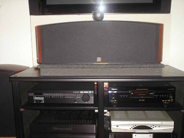

recently shelled out big bucks for an htm2d center along with 803d's and to be honest really not impressed with the dialogue at all....running them with marantz av and mm 8003's -- i have a pioneer blu ray bdp-o9fd and thought i would hear crystal clear dialogue with this stuff.... it has been a huge disappointment as the sound from the center is boomy and thick with often muddy dialogue .... the dealer who had assured me that the sound would be incredible and crystal clear is now blaming the acoustics in the room... although it is in my living room it is in an open floor area ( with the kitchen and dining room ) living room is about 18 x 15 with cathedral ceilings.... and the adjacent dining room is about 10 x 12 or so.... the center is on a cabinet that is esentially 3 boxes ( one housing the blue ray) that the dealer said is contributing to the boominess.... we tried putting foam in the speakers and tilted the center up a little to get the front off the box and we still have muddy dialogue.... any thoughts? thanks....
Dialogue Issues With New Htm2d Center-
The HTM2D delivers crystal clear dialogues here for sure. I've been using several other center channel speakers before, or even shadow center configurations, and the only speaker which ever satisfied me (and my family) for effortless dialogue intelligibility is the HTM2D.

is anyone familiar with the vanishing points which i have the speaker sitting on now?it is 3 points/supports basically which is supposed to de-couple the speaker from the cabinet? i would like to try the gamma thing but think it might sort of stand out and raise the center a bit too much as the tv is only a few inches above the speaker...Last edited by arube1; 18 February 2010, 08:31 Thursday.- Bottom
Originally posted by arube1is anyone familiar with the vanishing points which i have the speaker sitting on now?it is 3 points/supports basically which is supposed to de-couple the speaker from the cabinet? i would like to try the gamma thing but think it might sort of stand out and raise the center a bit too much as the tv is only a few inches above the speaker...
Try this. Unplug the sub, set the center speaker to "small" with a crossover of 80Hz, turn-off the EQ, and move the cabinet and speaker on top, out into the room 2-3 feet (even if you can't keep it there).
Or, plug the speaker cables into the top two binding posts only (removing the jumpers to the bottom two).
The HTM2D is essentially a small tower speaker on its side, and running it full range right up next to the wall is sure to make the sound thick / boomy / chesty.
If doing the steps above fix the problem, put everything back to the way it was and re-run the auto set-up, making sure to keep all of the microphone measurement positions within 1 foot of the main listening seat. If set-up properly, the Audyssey auto EQ in the Marantz will adjust the sound of the center speaker so that it sounds balanced.- Bottom
Originally posted by AV-OCDI can't tell for sure from the pic you posted, but it looks like your TV cabinet that the center speaker is sitting on is right up against the wall.
Originally posted by emig5mI would even try moving the crossover up higher to say 100Hz and setting all speakers to the same crossover (small/100Hz)... Really helped bring much more clarity to my system in surround sound/multichannel while even making the bass stronger. But I wasn't really unhappy before, mine was more about putting in that final touch. To me it sounds like his sound might of even been from the bass setting being set to 'both' sub and speakers. I tried the "both" setting for bass and it REALLY made the dialog muddy and unclear for me since the sub and speaker both where being fed the same exact bass info.- Bottom
thanks for the suggestions-- i do not have a sub and asked the dealer if getting a sub would help direct the bass away from the center ? still waiting for his response- he said he had to meditate on that.... also the cabinet the speaker is sitting on is directly against the wall and the center is maybe a few inches at most from the back wall...unfortunately the cabinet is fixed to the wall and can't be moved...the dealer told me to fill the cabinets the speaker is sitting on with foam to help reduce the boom in the voices...will try the cross over at 80 or 100 -- ...the equalizer is off i believe... thanks very much all..- Bottom
