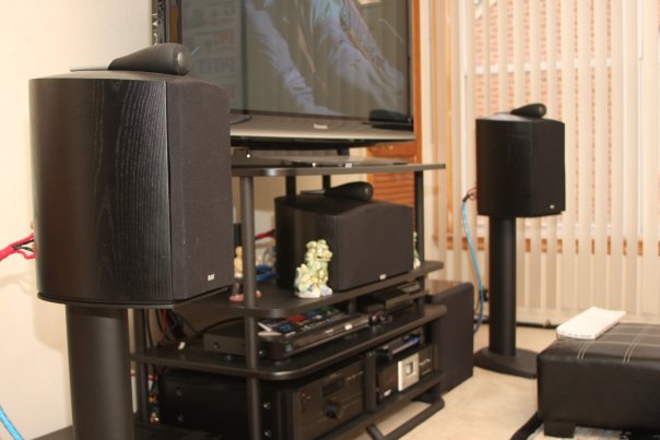

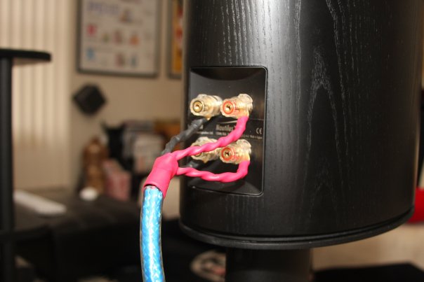

hi everyone!!!!!! i just purchased a pair of b&w 805 and having issues. i used to own b&w 603 s3. the 805's sound great. though, for some reason i know they could sound better. not sure what is going on. they are being powered by a rotel rb-991 and a rotel 1058 reciever. also using straightwire rhapsody ii speaker wire biwired. i have towed them in a bit, but, my imaging sounds different in a bad way compared to my 603s3. i feel like they sound kinda flat. so i started playing around with the crossover settings. first with 60hz (which the 603s3 were set at) and 80hz. at 60hz they sound quite clear yet lacking any bottom end. 80hz produces a bit more robust sound and kinda bloated. if you own a pair of 805's what do you have your settings at. i wondered if if was my rotel rb-991.......... just not sure :rofl: i listen to 2 channel about 30% and home theater 70%. 2 channel at the moment (using my mac mini in high res) sounds awkward some compared to my 603s3 setup. so, sometime this week i plan to hook my 805's to the rotel 1058 to see if it sounds better. i know i made a good purchase just having issues. ANY SUGGESTIONS???? :M

Also, consider trying out some other, perhaps generic, speaker cable, not bi-wired. Just try to eliminate some of the possible variables. Also, turn off all crossovers and tone controls initially, and perhaps use a simple analog source or basic CD digital in. Keep repeating a familiar passage or song and move them a bit, then repeat. Keep in mind I find the 800 line to be more difficult and amp dependant to drive. I thought all amps sounded the same, until I got into the 800 line and now notice how different amps can either shine or really flop.

This is just my recent personal take on things, but also remember you've moved up a fair bit in quality and cost and there may be some mental aspect you're trying to find too much improvement and if you don't always hear that great improvement, you start to look for reasons. Good luck and try to enjoy finding the holy grail of audio with your new 805S units. By the way, your setup looks great with those massive "hoses" coming out of the back of the speakers.- Bottom

found out that my Rotel RB991's gain had to be increased on my Rotel RSX-1058. i used a radioshack SPL meter to diag. the problem. 100% better. man, anything i write here on my new b&w 805s would be an understatement. super happy on my purchase. thank you everyone for the advice!!!! go B&W!!!!!!!!!!!!GO Revel!!!!! (powered by ;x( Anthem)- Bottom
