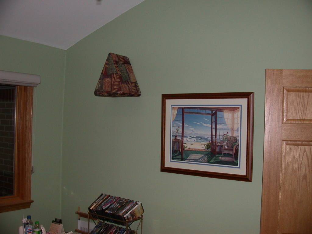

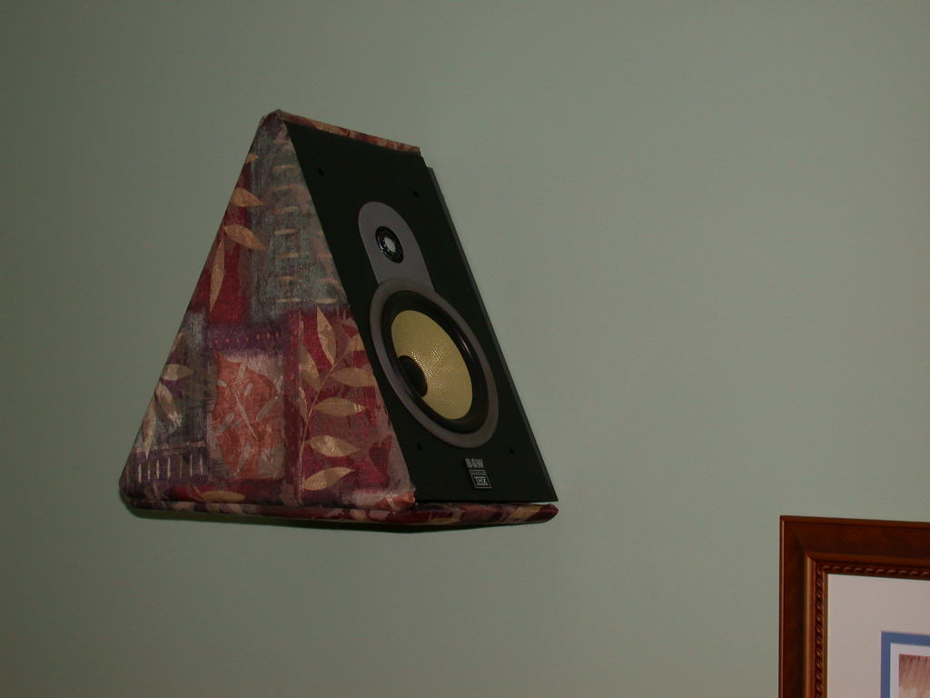

    Interestingly, I've had both the 705 and SCM8 as rear speakers. As one might suspect, the 705's were more detailed and had more focused bass (newer technology), but the SCM8's cover a lot of space (big soundfield) with very nice performance. They have their differences, but these should sound pretty good together. They are not miles apart.
    If I understand correctly, the SCM8's would be on the 'back wall' opposite the 705's up front. Don't get the SCM8's too close together, since they do cover a lot of ground.
    One thing that might help with WAF is that you can replace the fabric with something that would be pleasing to your wife. All you need is some fabric and a good staple gun. Or maybe some fabric glue. I preferred staples, easier to deal with if we changed fabric later.
    Back when I had the SCM8's, I took pictures of the them on the side walls after recovering. These are attached. Sofa was also on the back wall.
    Hope this helps.
