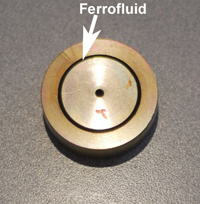

    Well I have a pair of B&w p6 speakers that have began to loose their "sparkle". DId some reading and found the ferrofluid issue. I took 'em apart and the former fluid has gone crusty.
    So rather than paying $145.02 per tweeter (quoted direct from B&W) I tracked down some ferrofluid (less than $20 for 1 oz shipped) and am awaiting its arrival.
    My question is: Has anyone attempted to replace the ferrofluid? Seems pretty ridiculous to pay over $300 to correct the ferrofluid issue.

          here is a picture:

            you can replace the ferrofluid, and it is readily available here in the states, but if the current fluid has gone crusty as you said it may be stuck to the VC and will cause rubbing, but, if it is not stuck, you can clean out the old and replace it. To clean out the gap just roll up a piece of masking tape back on itself so the sticky side is out, run this in the gap until you get all of the debris out, you can wipe down the VC's with cotton balls.

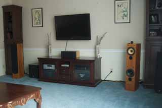

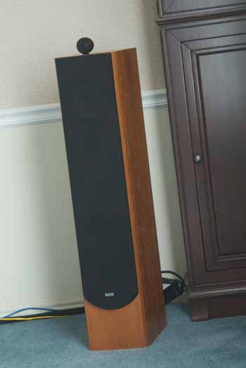

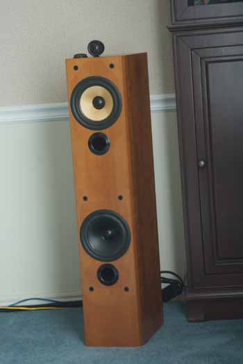

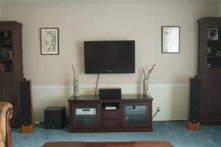

                Here are some requested pics...
                B&W P6's
                B&W DM 303's
                B&W LCR3
                Rotel RSP 1066
                Rotel RMB 1075
                Panasonic BD-55 Blu-ray
                Apple TV
                ... and some audioquest cables
