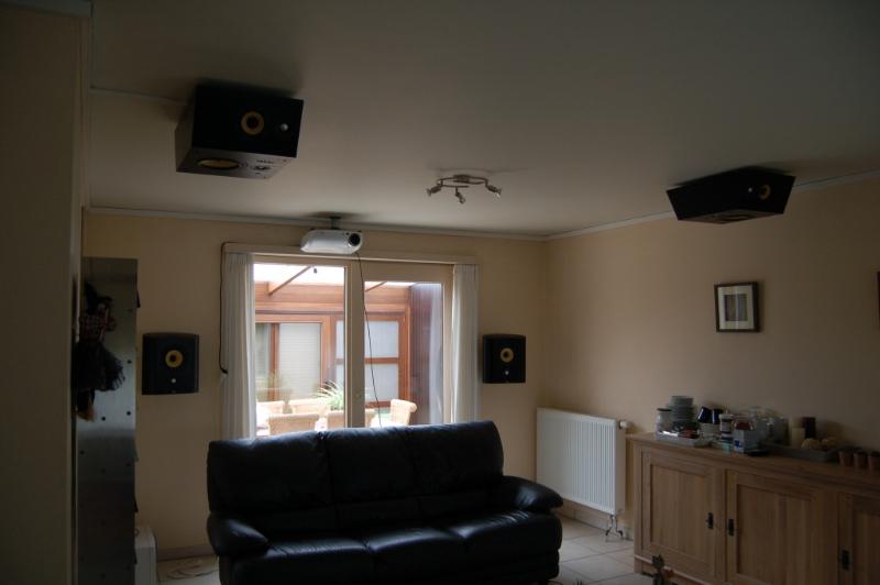

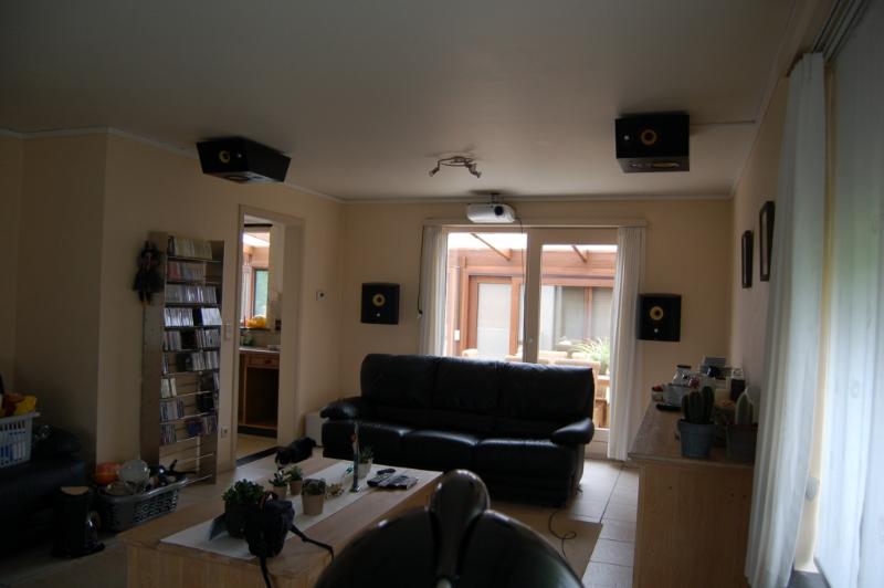

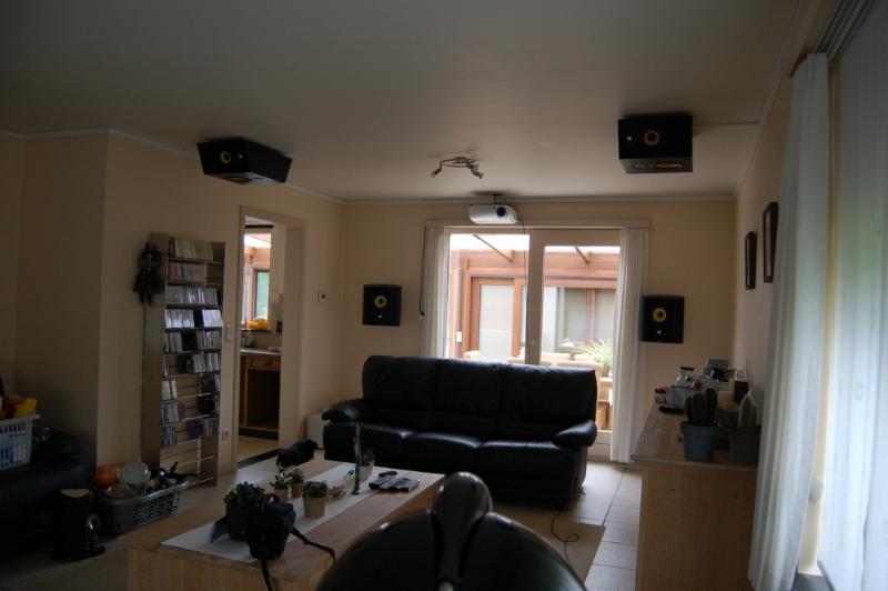

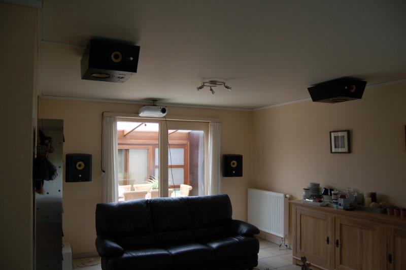

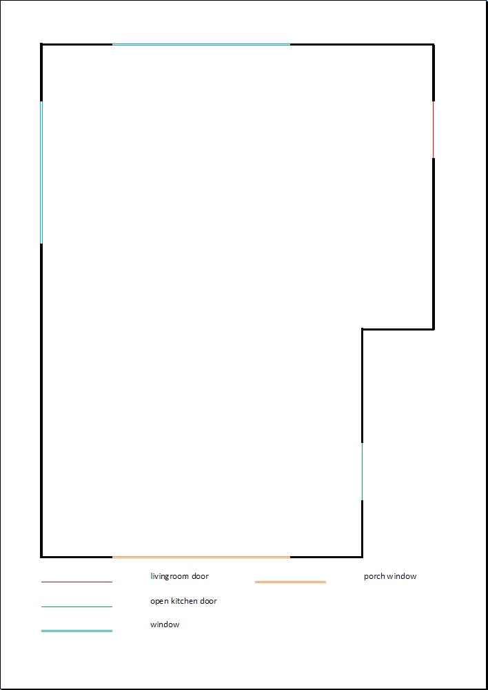

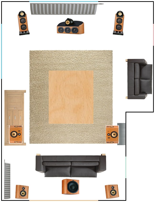

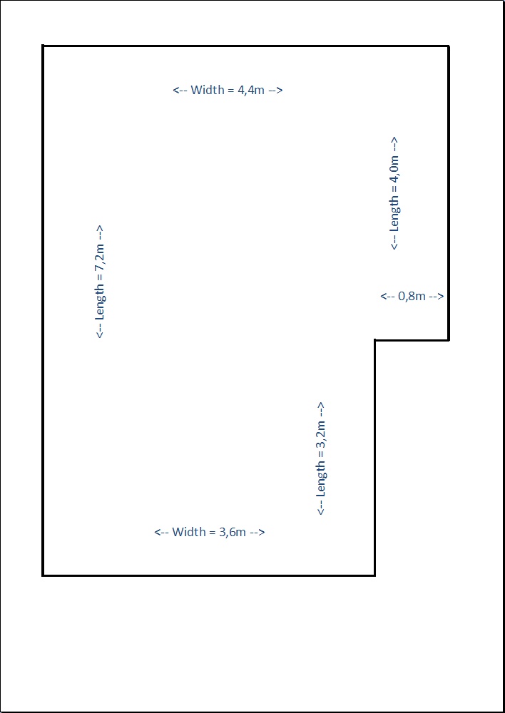

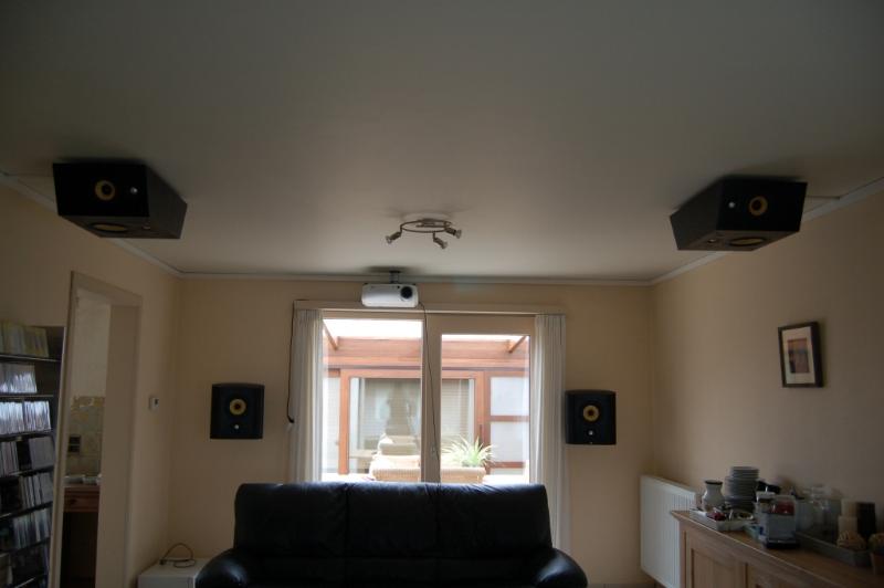

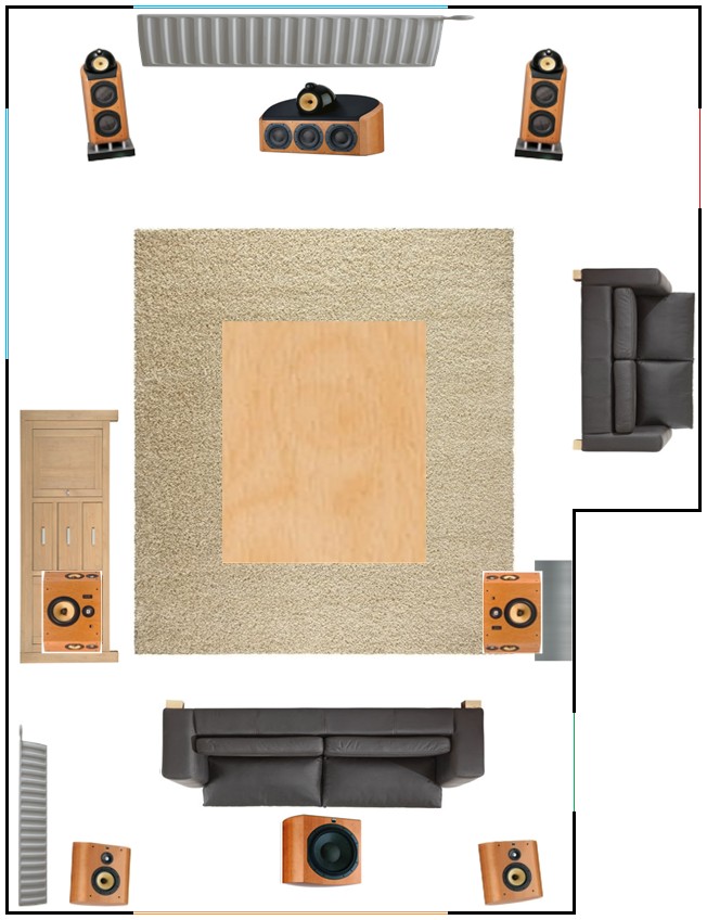

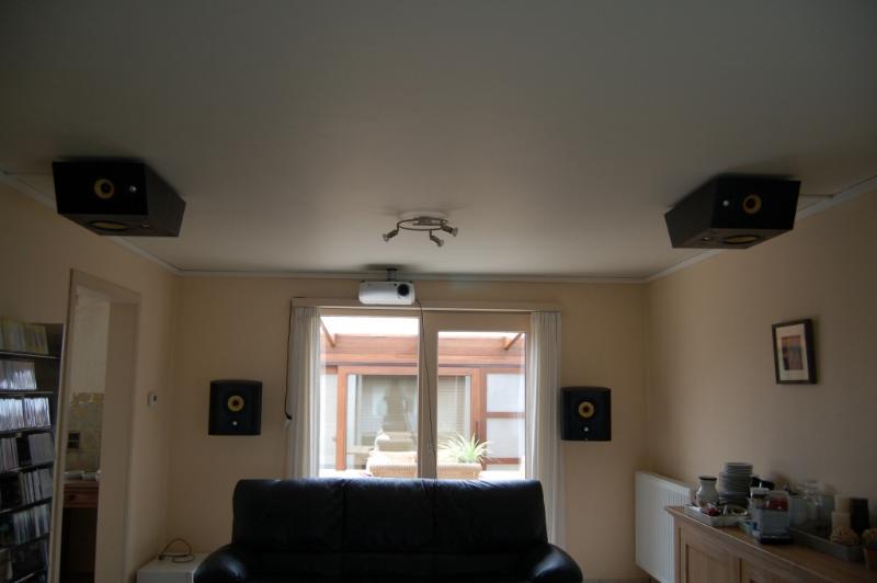

                            Hi guys
                            Thank you for taking the time to give me input! I took some pictures to visualise the situation better...
                            Please don't mind the mess in the living room, a new kitchen is to be installed next week, so :W
                            First pic: the DS8S & SCMS are alligned with front 800D speakers.
                            Second pic: due to the living room’s form it's impossible to put the di-poles in line with the sofa. If so, rears and backs would be to close together. I don't find this to be a bother...
                            Third pic: The space is there for 803D or even 802D in the back.

                              Cool I assume you live in Europe? The radiators are giving it away.
                              Any way you might have problems with the furniture if you put 802 or 803s in the back. Now that I see the room, I think your set-up is cool the way it is. On an other note you might want to think about removing your coffee table that is probably one of the best sound improvement you can make and your speakers and ears will love it.
                              I agree it is always great to upgrade but sometime improving the listening room is the best investment you can make.
                              PS: By the way with that many speakers in such a small room you must have a lot of reverberation? You might want to put some heavy drapes on the windows and also get some acoustic panels with digital printing.
                                Yeah, I live in Belgium
                                I've measured things, there is room for a pair of 803D's, I could even manage 802D's :B
                                Well, thanx ;x(
                                The coffee table was put there to break "floorbouncing" soundwaves, together with the carpet... Am I wrong to think so?
                                Like everybody, I'm dreaming of a seperate, dedicated HT!

                                  Would the radiator present a problem with the heat radiating too close to a floor standing speaker in the corner?
                                  I agree that the room looks very well set-up with speakers like you have it. I also agree that you could do with a bit of dampening. Heavier draperies would help. I have also been recently adding floor standing tropical silk plants that seem to be doing a decent job of absorbing sound waves. I placed them behind each floor standing speaker and in some empty corners. They look decent and my wife gave me the thumbs up.

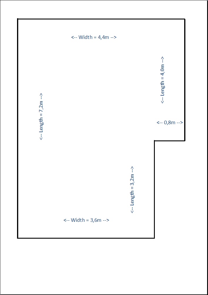

                                        Marco, what is the length of your room? Any reason why you can't move the sofa further in?
                                            I don't think so, at the front end, my center is also placed rather close to the radiator and it doesn't affect the speaker. I tried to sense any warmth on the back of the HTM1D, but it always felt "normal".
                                            The reason that I'm not in to "room dressing" right now is because of my former system (2.2) was from Lyngdorf. This compensates for room "flaws" in a electronic way (room correction). But now with the HT in place you are all so right that I should threat the room!

                                                Ok, let's continue visualising...these are the measurements of my living room:
                                                Height = 2,4m
                                                  Hi RebelMan
                                                  In my former "stereo" setup I always tried to put the sofa as far back as possible. I love "sitting" on row 7-8 of the concerthall. I listen to classical music a lot. If you put the sofa within the speakertriangle, you get more detail, but lose "overall" musical impression.
                                                  Of course, this is surround now, a new ballgame???
                                                  b.t.w.: the sofa could move forward indeed (not quiet esthetical, WAF!?)...

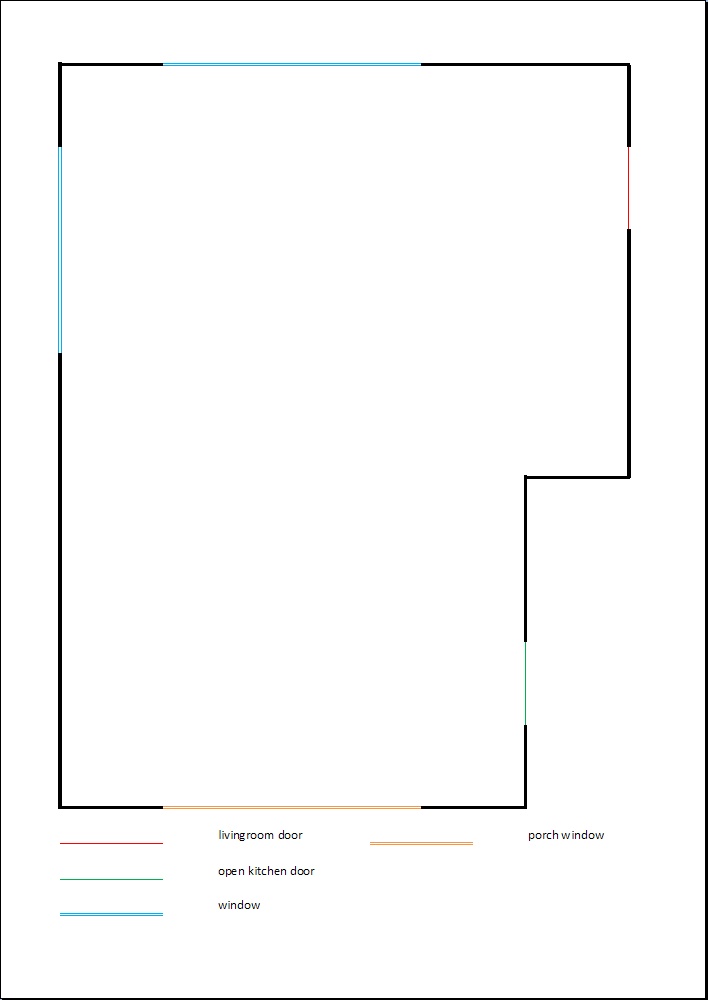

                                                    Living room with windows and doors:

                                                      Living room with speaker setup and furniture:
                                                      Extra info
                                                      1. Behind center speaker -> radiator
                                                      2. To the left of the left SCMS -> radiator
                                                      3. Under left DS8S -> sideboard
                                                      4. Under right DS8S -> cd rack
                                                      5. In the centre -> carpet with coffee table

                                                          Marco, it seems to me you have sufficient room to move the sofa forward and in line with the DS8S and still have enough setback from the front soundstage. It also looks like you could remount the DS8S on the sides and inline with the rears as monopoles. Although another pair of SCMS would probably work better and allow more flexibility for side wall placement. I think the extra effort to rearrange a few things would pay off big in the end and you won't need to give up any floor space in the process either.
                                                            Hello RebelMan
                                                            Why would you chance the DS8 into SCMS? You have to know that the DS8 can be "switched" from mono-polo tot di-pole operation. I think they use the same units.
                                                            In many literature my kind of setup is found to be the best for both movie and music: that is combining di-poles as side-surrounds and mono-poles as back-surrounds.
                                                            Would upgrading to floorstanders as (back) rears provide even greater benefit with music reproduction?
                                                            Let's just talk pure speakerwise now and leave accoustics out (for the moment)...

                                                                          Originally posted by Marco Lisi
                                                                          Hello RebelMan
                                                                          Spatial reasons primarily. If you have the space on the side walls to accept the DS8S then I see no problem driving them as mono-poles.
                                                                          There was a greater case for dipoles back in the heyday of Dolby Surround. Today's sound engineers are mixing tracks with the intent that they will be played back on monopole point source speakers (as they are in cinemas). Coupled with sophisticated matrixing algorithms and post processing schemes like Dolby ProLogic IIx and THX Ultra2, which are inherently designed to create a diffusive environment, and you circumvent the need for dipole speakers further if not completely, in rooms with the ideal configuration. Less than ideal rooms (that is rooms that are atypical in size, shape, configuration and seating) may require more creative approaches to conform to best practices.
                                                                          Yes and no. It depends on two things. 1) You have the room. 2) You know what to expect.
                                                                          The biggest problem with floor standers as surrounds is that inadequate room is donated to them and the diligence required to setup them up is not give due consideration.
                                                                          The other problem is knowing what to accomplish with a multi-channel setup. Are you interested in recreating the live performance within the acoustic confines of your own living space OR do you want to recreate the venue as if being "there"? If it's the former you don't need front/rear matching floorstanders. If it's the latter you may benefit with them to a small degree but it will depend mostly on the strategies taken to create the recording, the content of the show and the frequency with which you engage yourself in.
                                                                          I am not a proponent of recreating other places within the boundaries of my room because it can't be done. It can't even be convincingly approximated and there are many reasons as to why. Rather I prefer and recommend that the presentation be taken home. It's much easier to implement and the results are much more realistic than what you get experimenting with artificial teleportation. You'll still find yourself as being "there" but there as in your place and in real time not there as in the the 12th seat back in an auditorium of ten thousand with horn loaded speakers to pierce your ears and disturbances all around you (which are three-dimensional not flat space) some time ago or imagined. If you want that then there are much better ways of getting it by simply going.
