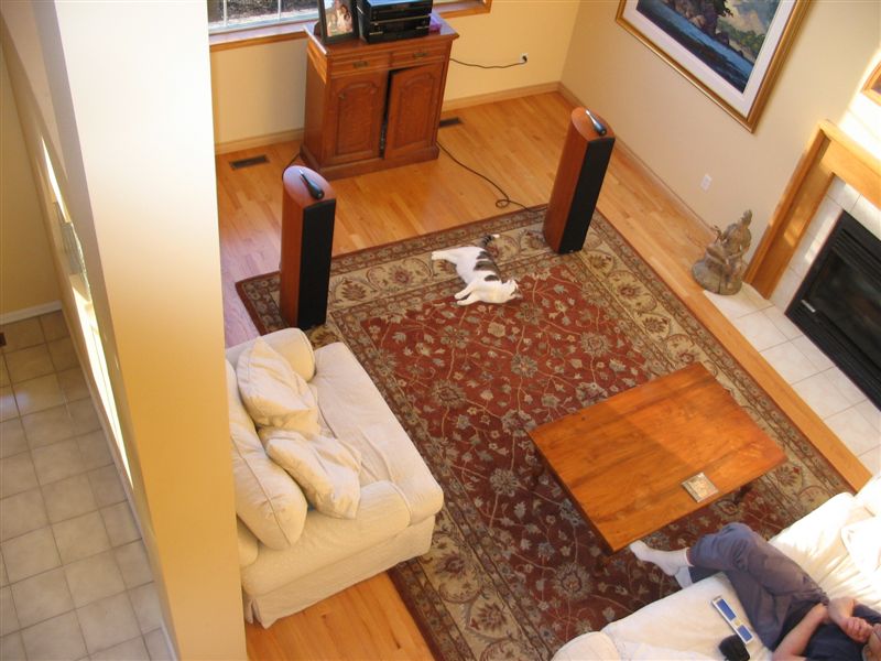

    Any suggestions for improving the sound of my 2 channel stereo system? I have 2 804S speakers and I am running these through my Denon 3805 AV receiver and a Denon DCM 380 CD player. I just bought the rug and it has helped with adding to the punch of the bass and reducing the harshness of the highs. The rear wall is 164 inches wide and I have each speaker 73 inches away from the rear wall and each speaker 45 inches from the side wall. I also have each speaker toed in very slightly towards the listener. The ceiling in the room is 16 feet high.
    Any suggestions for room treatments or placement of my speakers within reason would be greatly appreciated. I think I would still like to have more body and punch to my bass. The highs and midranges are sounding very clear and clean. I may consider upgarding the electronics in the future but for now my budget is limited for those upgrades.
    The cat is a camera hog and wouldn't get out of the picture

    Bass trapping in the corners.

      Good room treatment isn't cheap, perhaps even more expensive than your electronics.
      To see if that can improve, you can move your bed mattress in the living room, that's an easy test.
      I suggest:
      - Ceraball under all your electronics, that improve sound, and last forever.
      - Moving back speakers out of the carpet and use good spikes too
      Superspikes are ok, easy to move and won't damage your floor and are not too expensive for the result.
      - Ensure you have good power. Build DIY power cables, install power conditioner, etc... that make big difference in sound quality.
      - Try different brands of cables manufacturer, sure you can borrow some to you friends (MP me for more recommendations)
      - A much better furniture for your electronics will also be a good spend, stacking electronics it's not something I like. You can try to place a granite plate (buy cheap and heavy one for test) below with decoupling pad like stabren mesure between plate and furniture, and Ceraball between plate and electronics.
      But if you really want to improve sound you won't escape buying much better electronics, especially an amplifier, Denon is poor amplifier, but quite good pre-amp.
      Try to listen to a Rotel 1090, it can be found 2nd hand, and I personally like the result with 804.
      Your CD player is also far from perfect, try also to listen to Marantz CD/SACD player.
      804 are real good speakers, that will be the last thing to change in your system.

        It seems that your not happy with the bass production of your speakers, although your happy with the highs and mids.
        I used to believe that a subwoofer was just for home theater (ie movies) and that for real 2 channel sound music listening all you needed was a good pair of 2 front speakers like the ones you have.
        But after many years of listening experience and research of my own, in my opinion a subwoofer is a must and greatly improves the sound of any 2 channel system. I personally have the 703s and listen to lots and lots of cds (2 channel music) and I'm constantly amazed at how much better it sounds with the very tight bass production and just overall natural improvement in sound with my subwoofer (ASW750).

          Bass traps and speaker location in room are key (assuming your amp cam deliver the current the 804s want - not sure about your amp).
          The first think to play with would be speaker position. You might actually prefer them closer to the corner than you have them now.
          Room treatment does not have to be expensive. You can buy semi-rigid insulation (either fiberglass or mineral wool) and cover it with the fabric of your choosing. Placing thick absorbers in as many corners as possible can have a huge benifit to your bass response. I have about $400 in my room treatments, and it made a huge difference. (more than one person has looked for the subwoofer, which does not exist - yet)
            I have 704's in my 2-channel system, which are -3dB at 40 Hz (yours are -3 dB at 38 Hz), and adding a sub made a huge difference in the quality of the bass from my speakers. It's punchier but tight, and that -3dB point is now much lower than it was with my 704's. In addition, much less power is required from my amp because the sub's amp is doing most of the heavy lifting. If you add a sub, you'd want a sub that sounds well with music (some subs are OK with home theater but lack the control needed for music). I'm sure that bass traps in the corners would tighten the bass, whether or not you add a sub.

                If I may: None of that will make as certain and substantial an improvement as acoustical treatment of the room. The OP's experience with the addition of the carpet confirms this and points in the correct direction. The cheapest, easiest experiment is to buy a bale or two of fibreglass at HomeDepot/Lowes and, without opening the plastic wrap that holds it together, place a bale in each of the front room corners. Live with them for a couple of weeks and then toss them. Then, make your own decision.
                  Kal
                  If you want something bad for your health and ugly definitely go for that solution.
                  If you want something professional that's safe (health, fire,...) and not ugly that as a cost.
                  Auralex as very good products, just give them a look.
                  I've obtain better bass improvement results with the recommendations I made than with any room treatment, and that as cost me lot less.

                    I have to agree with Kal concerning acoustic treatments, because poor room acoustics will make it difficult or impossible to hear any of the subtle (or perhaps imaginary :P ) improvements caused by changes such as power cables and putting granite slabs under components.

                      not to jump on you, but I think Kal's suggestion was for a short period and at a low cost to see if it made any difference. Once the relization was made, then you can choose the more appealing solutions, such as auralex and some of the other brands.
                      • RobP
                        • 4747
                        I agree with Kal, try the fiberglass for a bit, if you dont like the results you can take them back and return them very easily, whereas with buying Aurelex bass traps (which are very limited in what they can do) You will have a harder time returning them if you dont like them.

                          Not if done with intelligence and care.
                          Foam is MUCH less effective than fiberglass or mineral wool.
                          If you say so. Of course, there's lots of subjective and objective data to prove the effectiveness of good acoustic treatment. :W

                              In my opinion, I think that it is important to note (again from my own experience) that yes good treatment with acoustic panels will improve the overall sound, sometimes very dramatically depending on how bad your room was.
                              BUT....acoustic panels, although they may greatly improve and define the sound like the bass in your case, it will not "ADD" some kind of magical performance to your speakers then they are capable of. All they will do is maximize the way the speakers were meant to be heard.
                              So if you listened to your speakers at a dealer where they are usually in acoustic treated rooms and love the sound (ie bass quality) but it sounds different in your home, then acoustic treatment will greatly help you in achieving that perfect sound you heard at the dealer before you bought them. But if you weren't happy with the bass production before at the dealer, then you're going to need to add a subwoofer. (Type of speaker wire, power conditioner, etc, etc will not give improvements like acoustic treatment or any type of signficant performance improvement for that matter that he wants..ie bass...again in my opinion).
                              And don't sell your equipment short (Denon 3805 AV receiver and a Denon DCM 380 CD player). There are of course better (ie more expensive options), but what you have are no slouch either.
                              • dknightd
                                • 620
                                I'll take $400 of proper room treatment over $1200 of cables, fancy feet, what have you, every time. A dollar spent on room treatments will almost always get you more bang for the buck. It might take a little more time to do it properly, and will not be as sexy, or as easy, but the results are worth it to some people . . . If you'd rather spend your money on equipment racks, fancy feet, fancy cables, that is fine with me. If I had money to waste I might do the same. Spending any money is premature until you have experimented (and preferably measured) the effects of changing speaker and listener position in the room.
                                Kal's suggestion to try rolled up insulation is a good one. You can cover it if you like. Try it for a week. If you don't like it return it, or better, spread it out in your attic. Almost all houses need more insulation . . .

                                  All this is perfectly true. However, it is important to note that magic is greatly overrated. :roll: All you can do is optimize the performance of the equipment you have and/or replace the equipment with something that suits you more.

                                    Move the sofa chair on the side further away from the speakers.
                                    Remove the coffee table.
                                    Soundstage will improve.

                                      Thanks so much everyone for all of the great responses. As the music room is also our family room, any changes I make are unfortunately limited by the impact on the aesthetics of the room. My wife has given me some dicretion on how the stereo is set up but moving the coffee table and the side chair are probably not an option.
                                      The bass traps in the corners sound like an interesting option and I will have to explore finding some that will be acceptable in regards to price and aesthetics. The Home Depot insulation idea is a clever way of trying this out for free (or maybe I could put 2 beanbag chairs in the corners???). Would it be necessary to have a base trap in each of the 4 corners of the room or are they most important in the 2 front corners of the room? The rear walls are about 5 feet behind where I am sitting on the sofa.
                                      A subwoofer may be the easiest (and not change the appearance of the room) solution because I could conceivably place it behind my stereo stand in the front of the room (I could move out the stand and have easily 12" to 16" behind there freed up for this). I could also maybe borrow a subwoofer from a friend to try it out to see how it improves the sound of the bass. Are there any subwoofer recommendations that are good for 2 channel music and that would cost approximately $1,000 Canadian or less?
                                      Thanks so much for all the imput you guys have offered, I truly appreciate all your opinions on this :T

                                          I have the 804s and a Denon 3806, which is almost idenitcal to your 3805 and I have wrestled with some of the same questions you have. Here are my findings.
                                          Speaker placement and listening position are key. It sounds like your speaker placement is good. I would make sure your listening position is about 62% into the room (i.e. room is 20' long, put listening position 12.5' from front wall). Try this as a starting point if you can.
                                          Room treatments do wonders. I would start with a bass trap in the 2 front coners and 2 more panels for 1st reflection on the side walls. You can do this for under $400.
                                          If you get a sub, and cross over at ~80hz, this will give the 804s a little more headroom, and add some deep bass which the 804s are good, but not great at.
                                          The 804s really like 200wpc, which the 3805 is not giving. If you can get a decent quality 200wpc amp, the 804s will really open up. I bought a used Krell, but Bryston, Rotel and many others make good amps. Try the sub 1st though, and you may not need the amp.

                                            Most of us have similar constraints.
                                            The more, the merrier. However, I would start with the HD bags in two corners and, if that pleases, get more esthetically acceptable traps to replace them. Then, continue the experiment by using the HD bags to supplement your new traps so you can determine if you want/need/can accommodate more. BTW, the bean bag chairs are not the equivalent due to their covering and their stuffing.
                                            I cannot recommend a specific sub but it is worth a try. Remember, however, that the sub is even more sensitive to the room modes. It's not a slam dunk.
