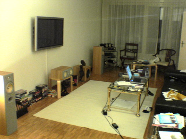

                                My set up. the photo is taken from the empty room beside.
                                • dyazdani
                                  • 7032
                                  Nice setup. The first thing I notice is that your speakers appear to be pretty far apart compared to where you sit (unless it's just the angle of the picture). Second, you have no toe-in on the speakers, they are pointed directly ahead. Both of these things would have a negative effect on the center image and make vocals somewhat incoherent.
                                  The above would be for 2 channel music, shouldn't have as much (or any) effect on voices in HT due to the center channel.
                                  I would move you speakers a little closer together and point them a little towards your listening position and see what happens.

                                    Ok. will do. I also moved the center spkr a little away from the wall. About 30 cm. It made quite a difference. You think I need to fill my walls and floor? I set all the fronts to small. See what happens. I'm going to the dealer 2mrw, to ask about the foams.
                                    • grit
                                      • 580
                                      I'm NO expert. With that in mind, let me say that when I moved to a Pergo-floor residence, the acoustics SUCKED. Horrible echo. I had to put a LOT of stuff around to absorb sound bouncing everywhere. In the photo, there does not seem to be a lot of stuff to absorb sound. The other thing I noticed is that your speakers are VERY close to the walls. I try to keep the back an sides of my speakers at least 18" from any wall (24" if you can help it at all).

                                                    Monk, By looking at your picture that you provided, I think that your biggest improvement would be in some acoustical treatments, your front wall is bare of any treatments, plus those sheer curtains dont really offer much in cutting down the reflection from the large glass area. Room treatment is probably one of the most important aspects of any audio system. You may try some bass traps in the corners, some panels behind each of the L&R speakers and the center channel. These can be made fairly cheap yourself or you can purchase them, it just depends on how much you want to spend.
                                                    Also you may want to play with that glass table directly in front of you, reflections from that table will wreak havoc on your center information.
                                                    I see alot of people spend thousands upon thousands of dollars in upgrading their equipment because it just does not sound right, but no money on the room treatment or design. Get your acoustics in order and you will really be amazed what you will hear. :T
