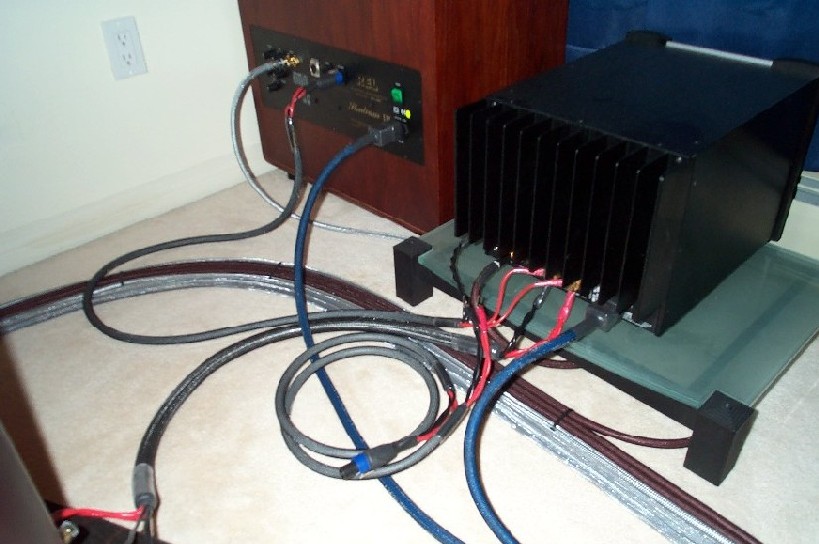

                                  In my 4 sub setup, this is how I've got it setup:
                                  1) All 4 subs receive the same 0.1 channel, allowing me to set the volume lower and allow them more "headroom" to support the other speakers. A side benefit of this is that the response is VERY EVEN throughout the room. With odd number of subs (1 or 3) you get more hot spots.
                                  2) Each sub supports only 1 additional speaker in "hi-level."
                                  3) Center speaker is set to small and thus technically, it's low end information below 40Hz is reproduced at ALL FOUR subs, which is not ideal, but what I found to be the best compromise until I try a 5th sub.
                                  Since each REL can support up to 2 more speakers, I could have connected the center to one of the front subs, but the way I have my cabling setup (I've attached 1 pic - ignore the extra REL cable in the pic ), I opted not to until I can try a 5th sub and see what happens. I run a custom 6ft cable to each sub, and it doesn't reach the CAM-350 for the center. Oh, the other reason is that I've got the subs connected via balanced hi-level connection, meaning both signal cables are connected to the amp leads, and then the ground is connected to chassis ground on the amp (basically any screw touching the chassis). That alone doesn't allow me to connect the center amp to it.
                                  Hope that clears things up... knowing me, that probably confused things :B
