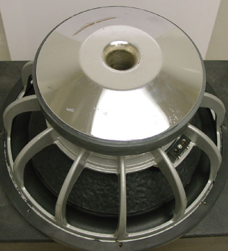

    I can say there are several sizes ranging from 12" -18"'s. They use the XBL^2 motor technology (for those that don't know this means significantly lower distortion ).
    Here's a peak at the 15", note the Fs, the Xmax, the cast VC and spider vents ....... :T
    Fs 15.7 Hz
    Qms 3.5
    Qes .34
    Qts .305
    Vas 300.6 liters
    Re 3.2 ohms
    Znom 4 ohms
    Sd 749 cm^2
    xmax 27+

    I think this is going to make a lot of bass freaks VERY horn-y! How many pounds of flesh will it be selling for?
      XBL^2 technology drivers aren't cheap. Best 'guesstimate' for the 15" is ~$329. That's compares to $499 for the Adire 15" Tumult.
      Below is a pic of the 15" sitting beside a Tempest (note that it's still comparatively shallow for a very high excursion 15")

        Interesting. I am in the market for a couple of 15" drivers. Competition is good. Speaking of which, I am curious, how is it that another company gets to use Adire's technology? Did they license it from Adire?
        JP
          Licensing is the only way to get the XBL^2 technology.
          Edit:
          This is a pic of the 'smallest' 12" driver in the product line. It's not the 18".
          Pricing will be approx $165, sweet price for the XBR^2 technology

                Got any specs on the 18? What sort of efficiencies are we looking at?
                There are many ways that 15 could be used, but I would love to hear it in a large, well designed bass horn . . . sort of like this one cast from concrete, using 12 Altec 515 woofers:
                Last edited by theSven; 26 August 2023, 09:00 Saturday. Reason: Remove broken image link
                  Nope no additional info at this time. My understanding is that they will be somewhat more efficient as compared to something like the BluePrints.
                  But as Hoffman's Iron law dictates, high excursion combined with low Fs means modest efficiency.
                    Oops I goofed, that's not a picture of the 18", it's a picture of the one of the 12"s........ ops: ops:
                    In the not to distant future we'll get our hands on a couple of these drivers for testing ...... That should be fun since I've never played with an XBL^2 driver before ........ :T

                                              Nope the cones are pulp, with carbon fiber inverted dust caps. I don't have any pics of the fronts of the drivers.
                                              Metal cones would increase the price a ton, and provide no improvement in performance

                                                  These are the 'fixed' parameters for the 4 ohm 4-layer VC
                                                  Fs 23.2 Hz
                                                  Qms 4.9
                                                  Vas 128.5 Liters
                                                  Re 2.8 ohms
                                                  Znom 4
                                                  Sd 481 cm^2
                                                  xmax 18+ mm
                                                  There's a second VC, it's not 4 ohms. That's all I can put in print at this time

                                                        Initially there will be the 12" driver shown above and a 15", both with the unique VC's arrangement and 18mm Xmax.
                                                        In addition there will be the 15" shown above and an 18", both with BIG motors (almost 9" diameter magnets), 27mm Xmax, and a standard VC arrangement.
                                                        All the drivers will have the XBL^2 technology
                                                        At this point in time I've said all I can say. In a couple of weeks there will be more info......... :wink:
