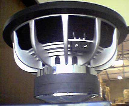

    Can't say too much at this point, product rollout will be in a few weeks. Brand new company (Jon and I are not affiliated with them, but from time to time we get insider info ).
    I can say there are several sizes ranging from 12" -18"'s. They use the XBL^2 motor technology (for those that don't know this means significantly lower distortion ).
    Here's a peak at the 15", note the Fs, the Xmax, the cast VC and spider vents ....... :T
    Fs 15.7 Hz
    Qms 3.5
    Qes .34
    Qts .305
    Vas 300.6 liters
    Re 3.2 ohms
    Znom 4 ohms
    Sd 749 cm^2
    xmax 27+

    I think this is going to make a lot of bass freaks VERY horn-y! How many pounds of flesh will it be selling for?
      • 10933

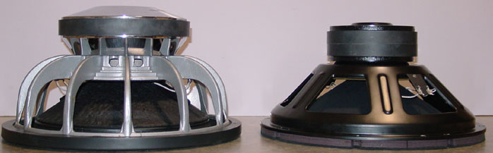

      XBL^2 technology drivers aren't cheap. Best 'guesstimate' for the 15" is ~$329. That's compares to $499 for the Adire 15" Tumult.
      Below is a pic of the 15" sitting beside a Tempest (note that it's still comparatively shallow for a very high excursion 15")

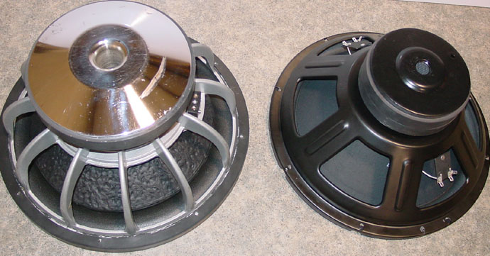

          This is a pic of the 'smallest' 12" driver in the product line. It's not the 18".
          Pricing will be approx $165, sweet price for the XBR^2 technology

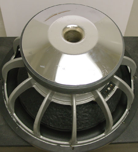

                                                        Initially there will be the 12" driver shown above and a 15", both with the unique VC's arrangement and 18mm Xmax.
                                                        In addition there will be the 15" shown above and an 18", both with BIG motors (almost 9" diameter magnets), 27mm Xmax, and a standard VC arrangement.
                                                        All the drivers will have the XBL^2 technology
                                                        At this point in time I've said all I can say. In a couple of weeks there will be more info......... :wink:

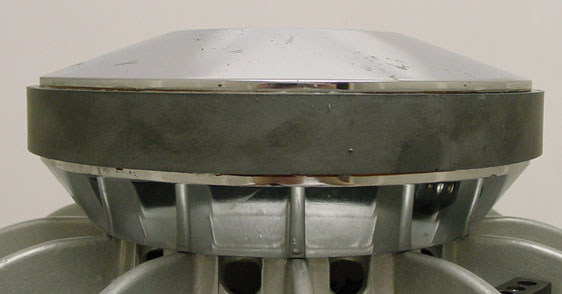

                                                                                  The "larger" motor features 27+ mm of xmax. It uses a single magnet nearly 9 inches in diameter. It will be available in both a 15 and an 18 inch version. Both drivers will be priced under $400. (The 15 incher will probably be priced at $329) Here are some preliminary specs on the 15 inch version with this motor:
