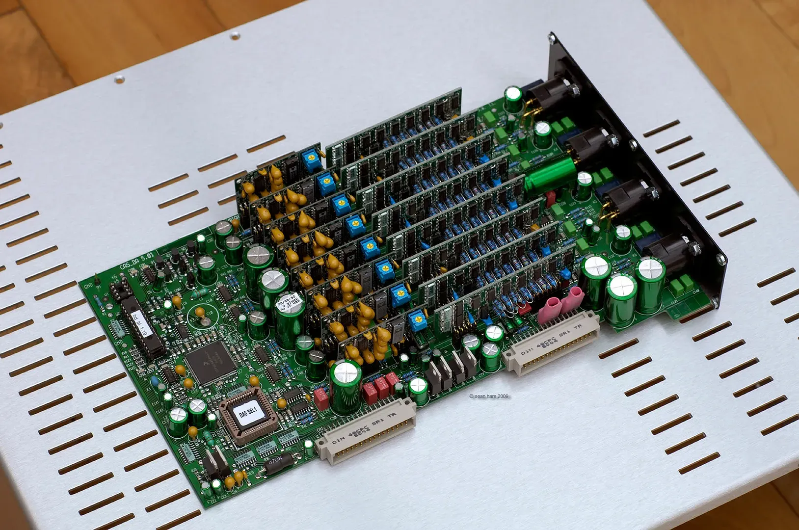

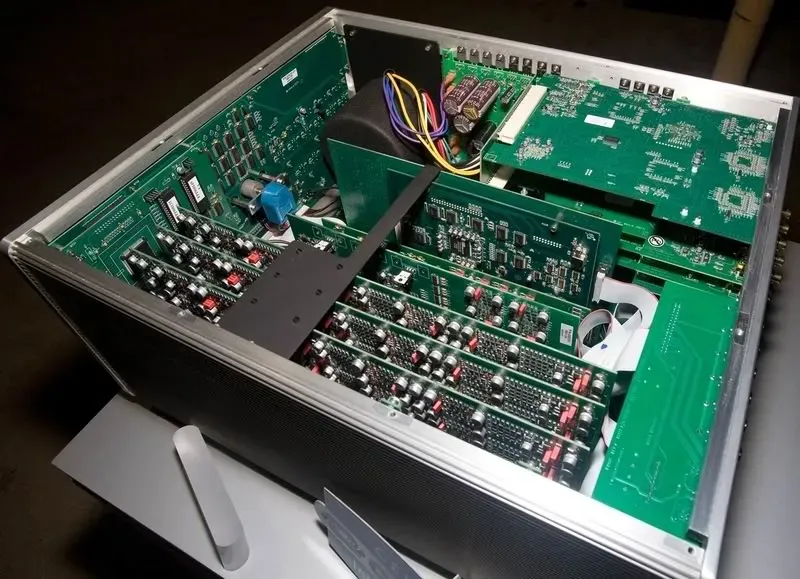

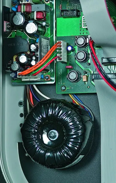

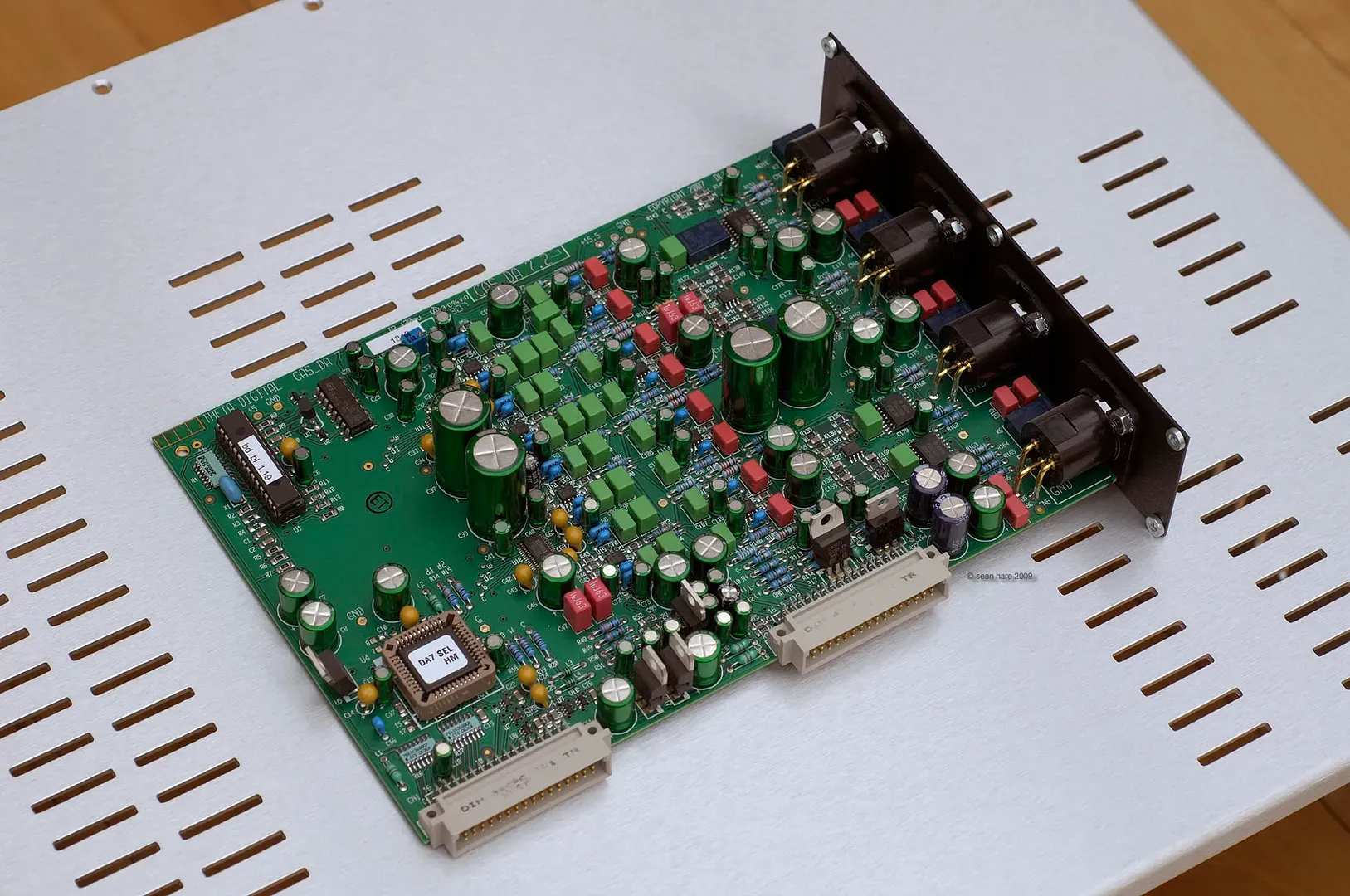

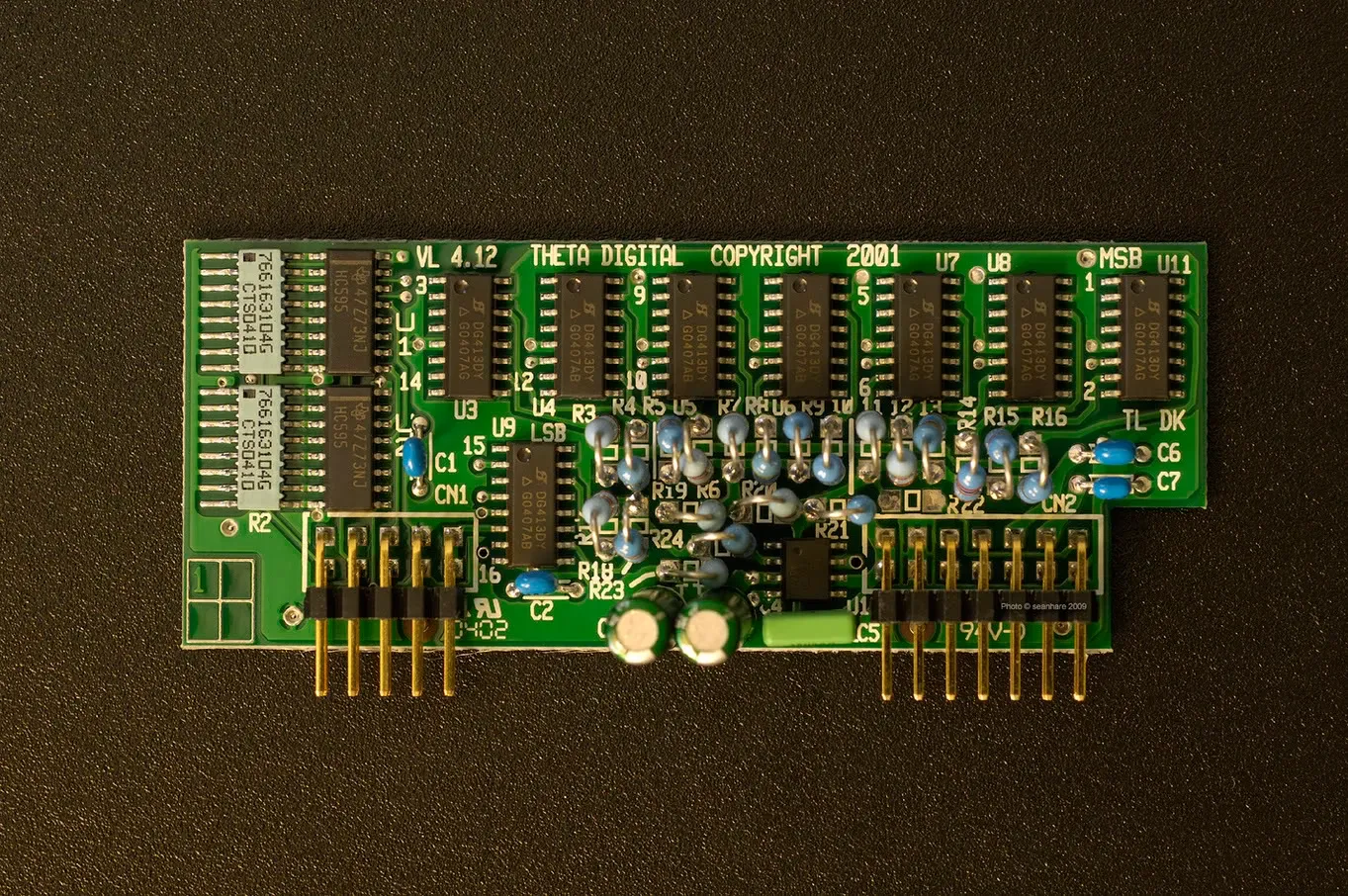

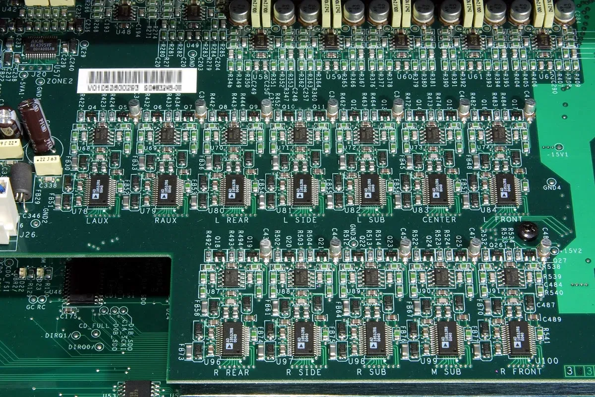

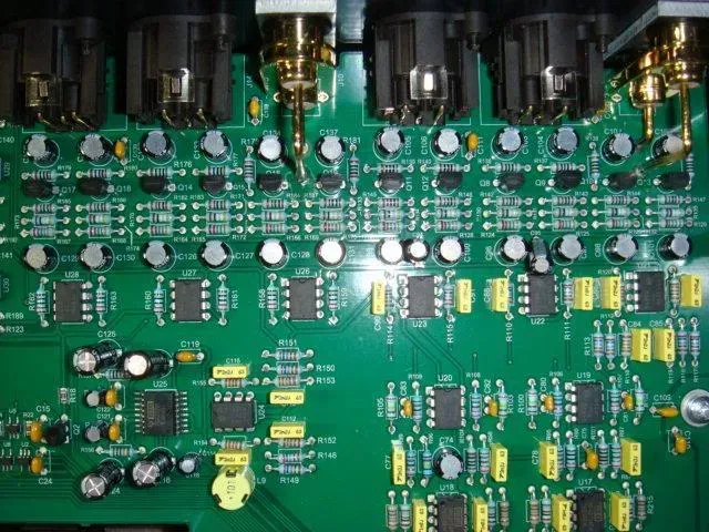

    Theta digital casablanca III

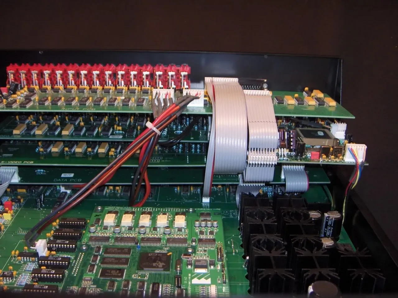

    Click image for larger version  Name:	Extremeclose.webp Views:	0 Size:	263.8 KB ID:	938114
    Click image for larger version  Name:	ExtremePremium.webp Views:	0 Size:	252.5 KB ID:	938115

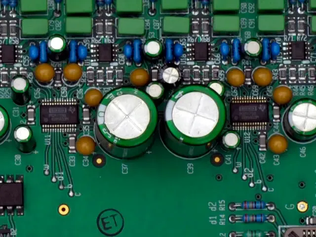

    Click image for larger version  Name:	Premium-BB-1796-DAC.webp Views:	0 Size:	46.3 KB ID:	938116
    Click image for larger version  Name:	Premiumclose.webp Views:	0 Size:	223.5 KB ID:	938117

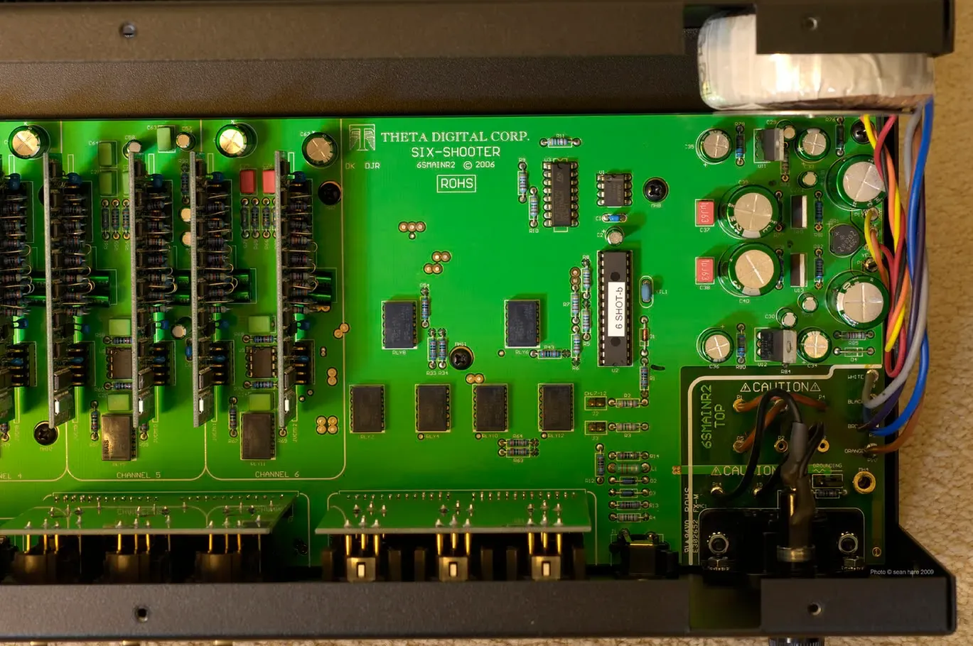

    Click image for larger version  Name:	Six-Shooter-interior.webp Views:	0 Size:	152.9 KB ID:	938118
    Click image for larger version  Name:	Theta-3.gif Views:	0 Size:	307.3 KB ID:	938119
    Click image for larger version  Name:	Thetaboards.webp Views:	0 Size:	63.6 KB ID:	938120
    Click image for larger version  Name:	ThetaCB3.webp Views:	0 Size:	43.3 KB ID:	938121
    Click image for larger version  Name:	Volume-control-card.webp Views:	0 Size:	354.9 KB ID:	938122

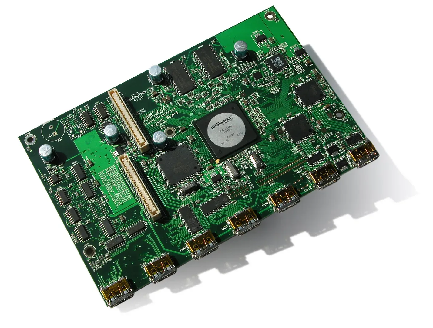

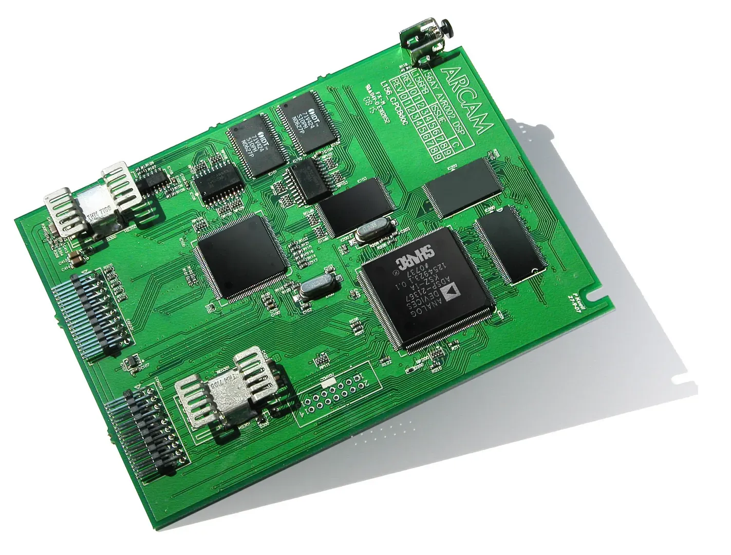

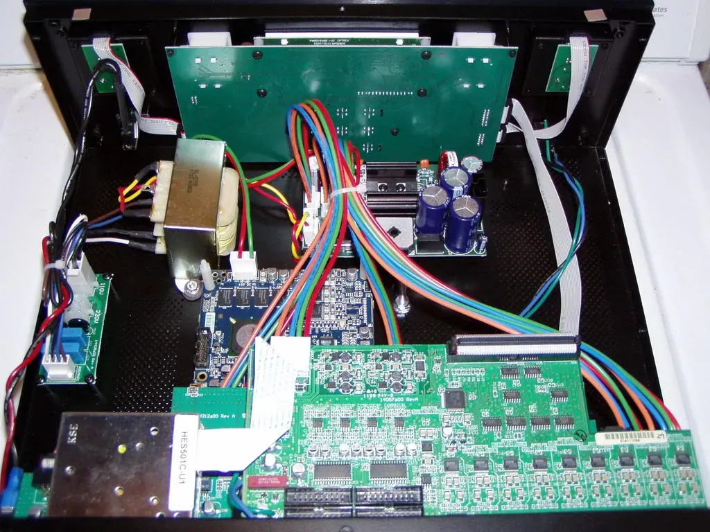

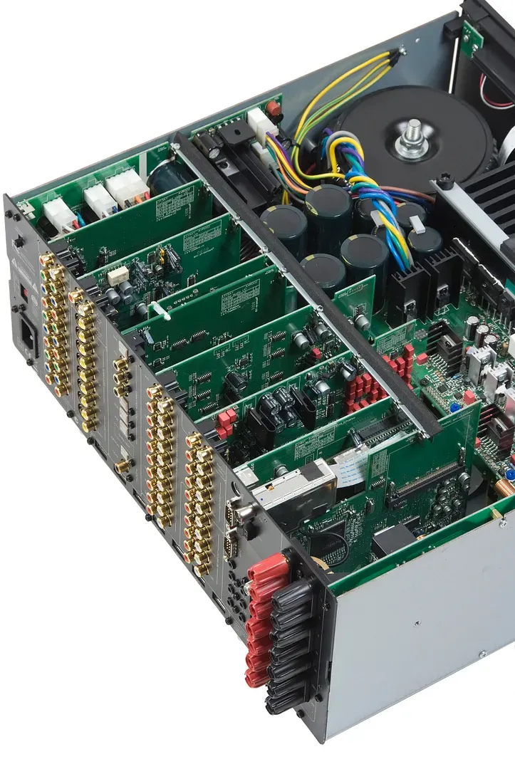

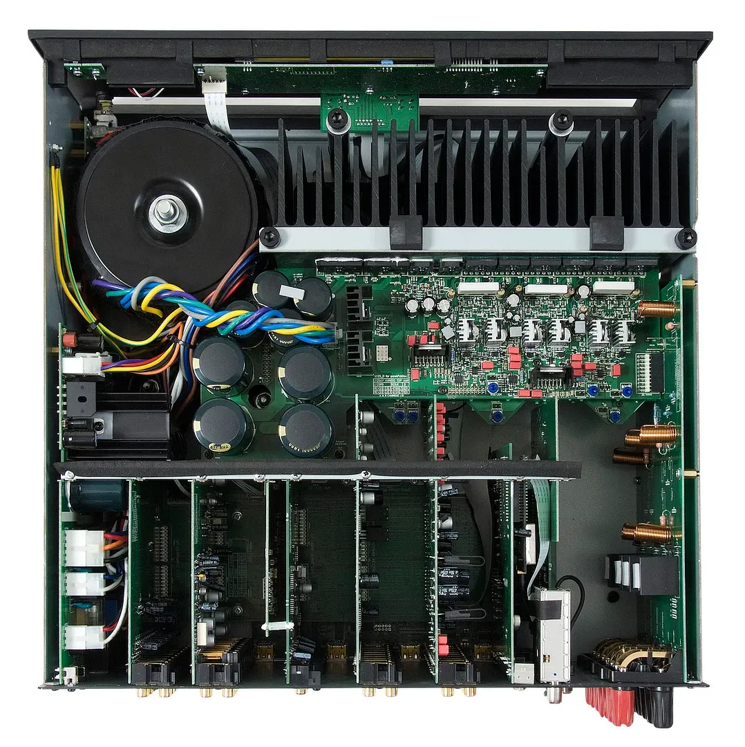

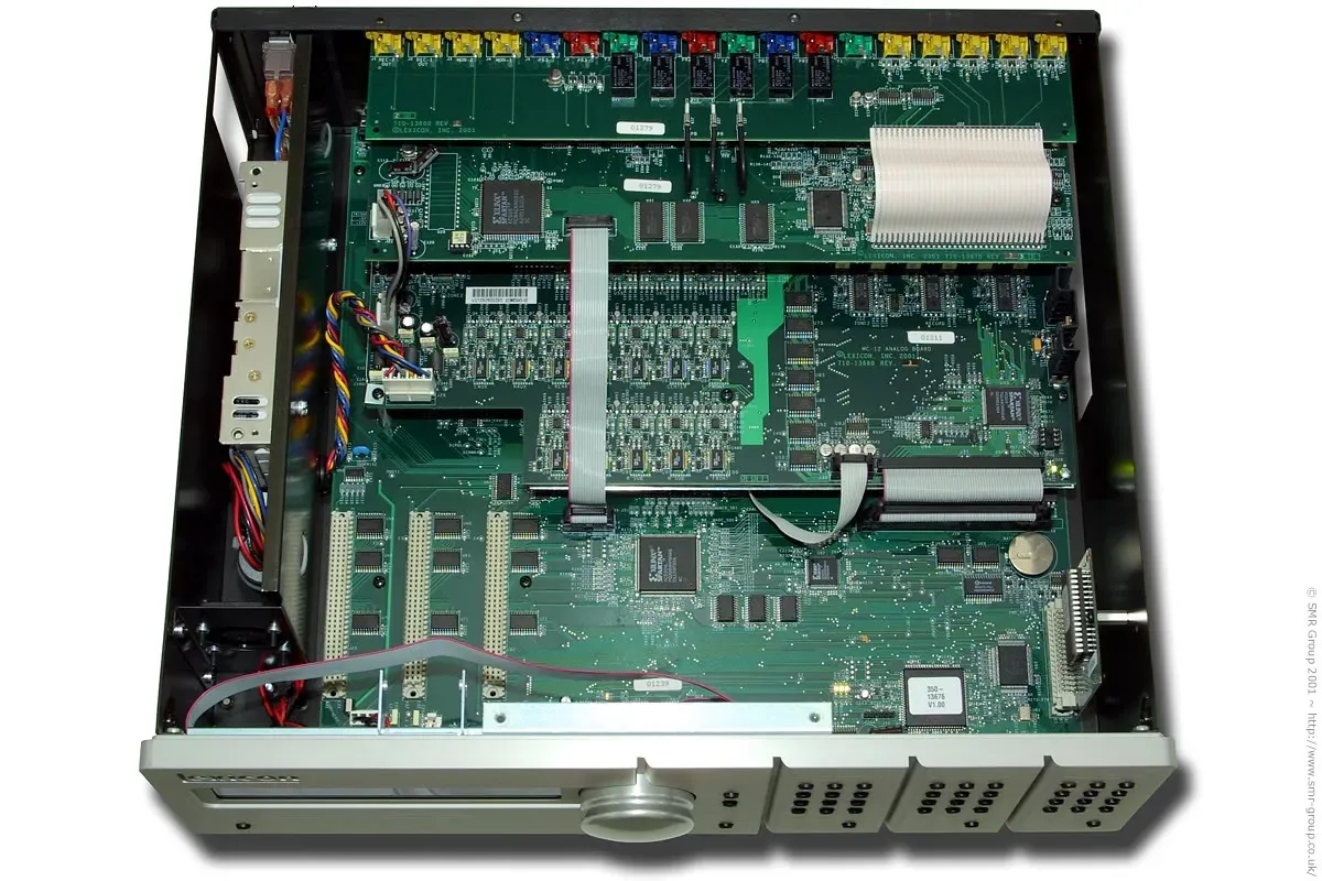

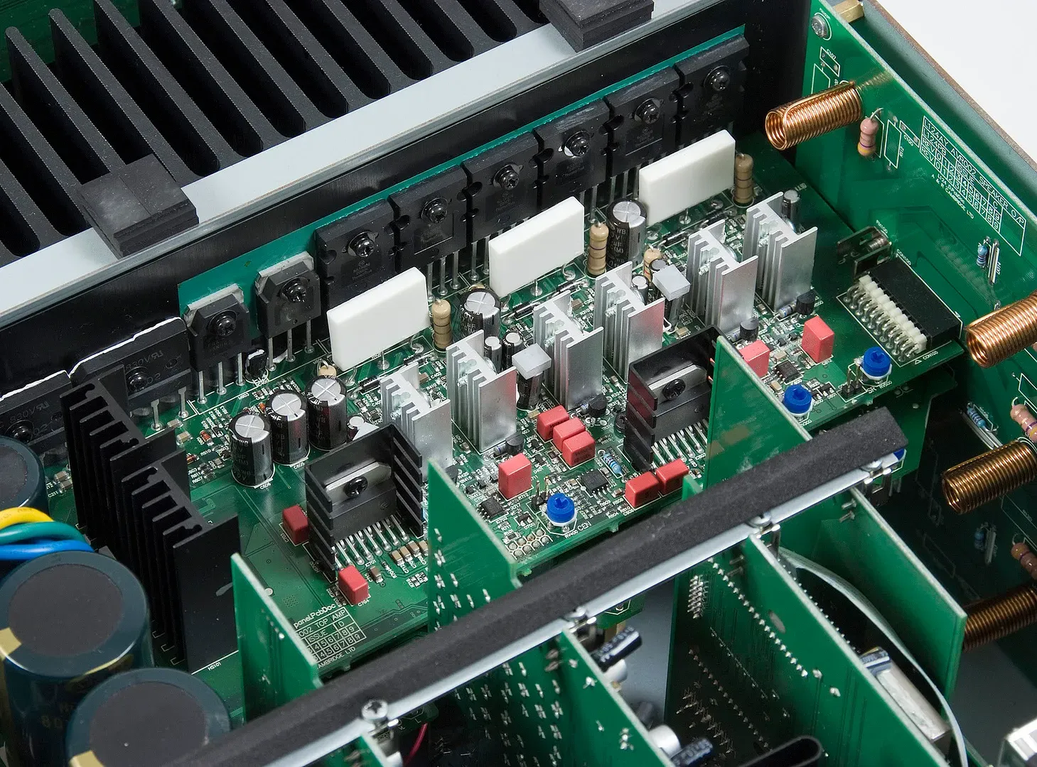

    Arcam FMJ AVR600/FMJ AV888

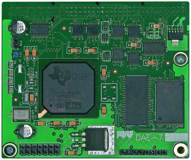

    Click image for larger version  Name:	arcam-AVR600lid_off_top.webp Views:	0 Size:	210.3 KB ID:	938123
    Click image for larger version  Name:	arcam-avr600-internal-dsp.webp Views:	0 Size:	189.1 KB ID:	938124
    Click image for larger version  Name:	arcam-avr600-internal-video.webp Views:	0 Size:	196.6 KB ID:	938125
    Click image for larger version  Name:	arcam-avr600-modules.webp Views:	0 Size:	109.0 KB ID:	938126

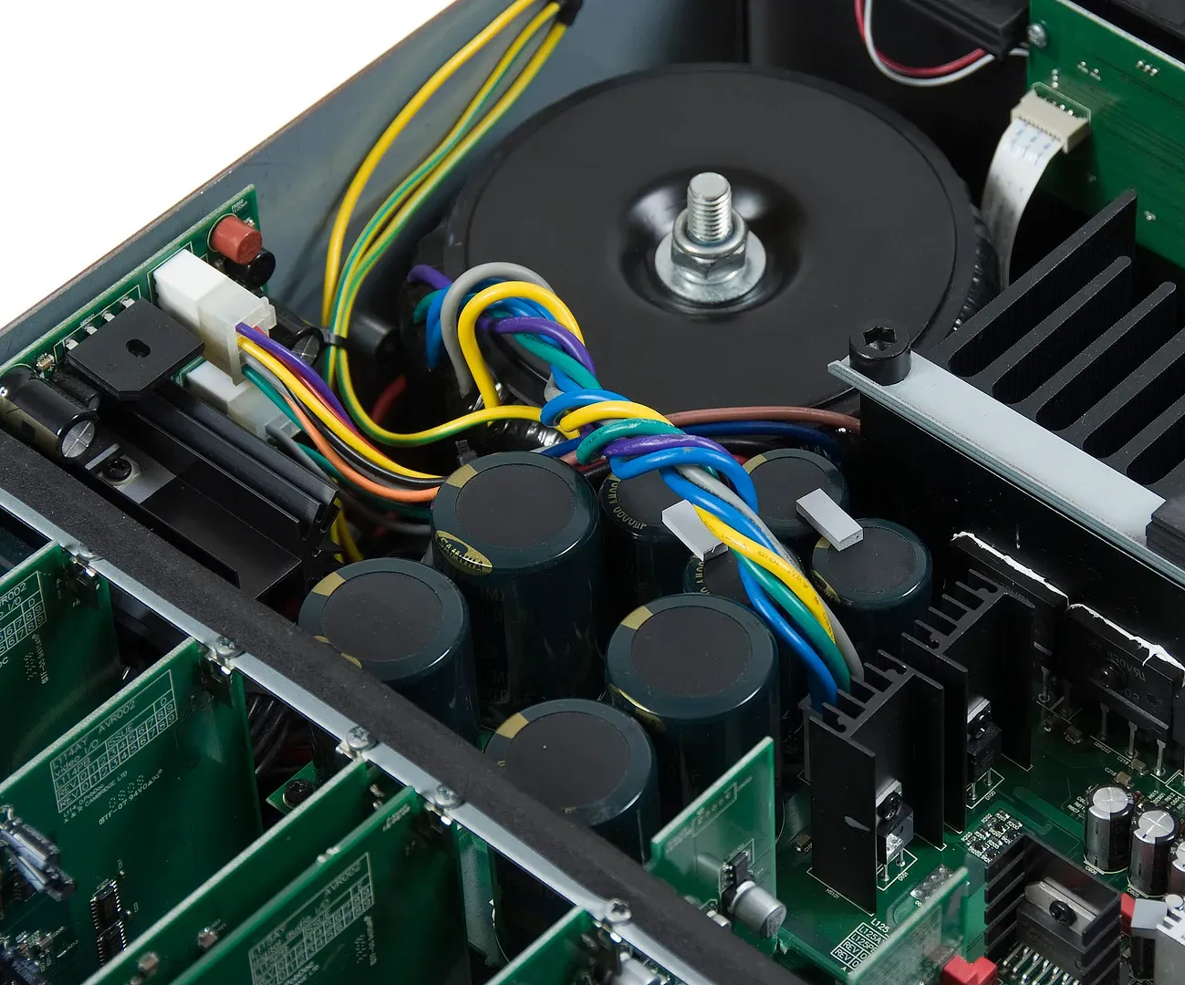

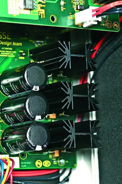

    Click image for larger version  Name:	arcam-avr600-power-amp.webp Views:	0 Size:	290.2 KB ID:	938127
    Click image for larger version  Name:	arcam-avr600-powersupply.webp Views:	0 Size:	149.6 KB ID:	938128

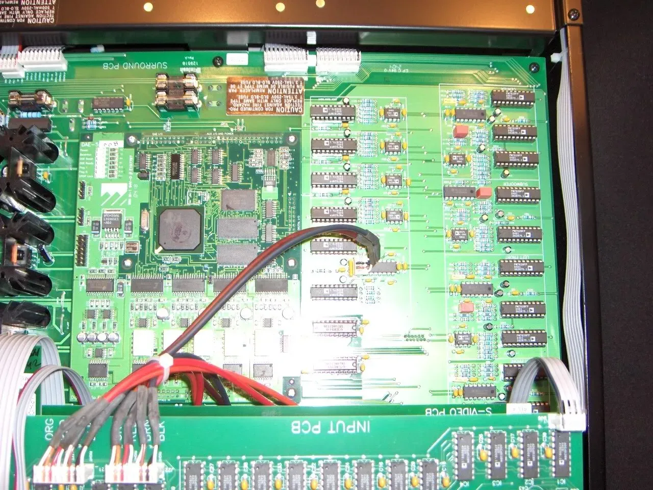

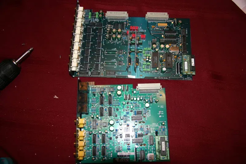

    B&K reference 70
    Click image for larger version  Name:	P1010020.webp Views:	0 Size:	127.8 KB ID:	938129
    Click image for larger version  Name:	P1010021.webp Views:	0 Size:	151.1 KB ID:	938130

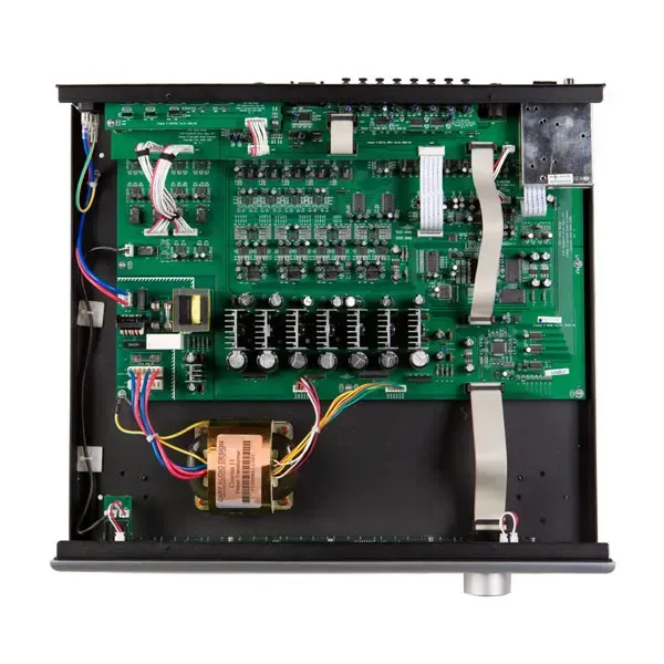

    Cary cinema 11a
    Click image for larger version  Name:	cary_cinema_11-2.webp Views:	0 Size:	40.6 KB ID:	938131

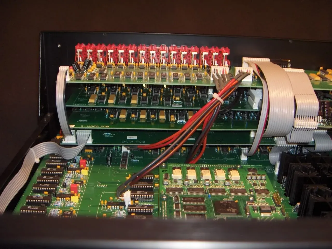

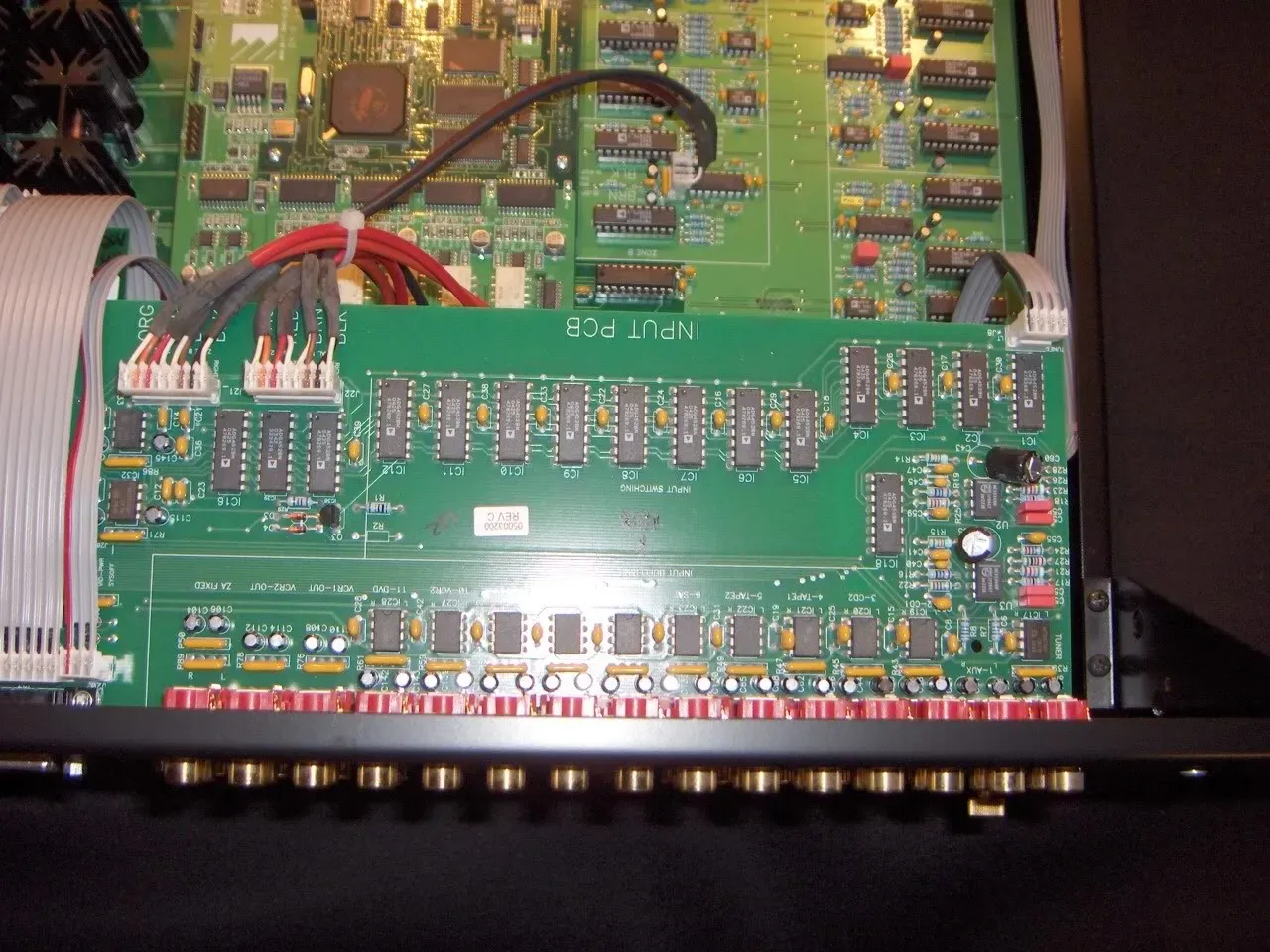

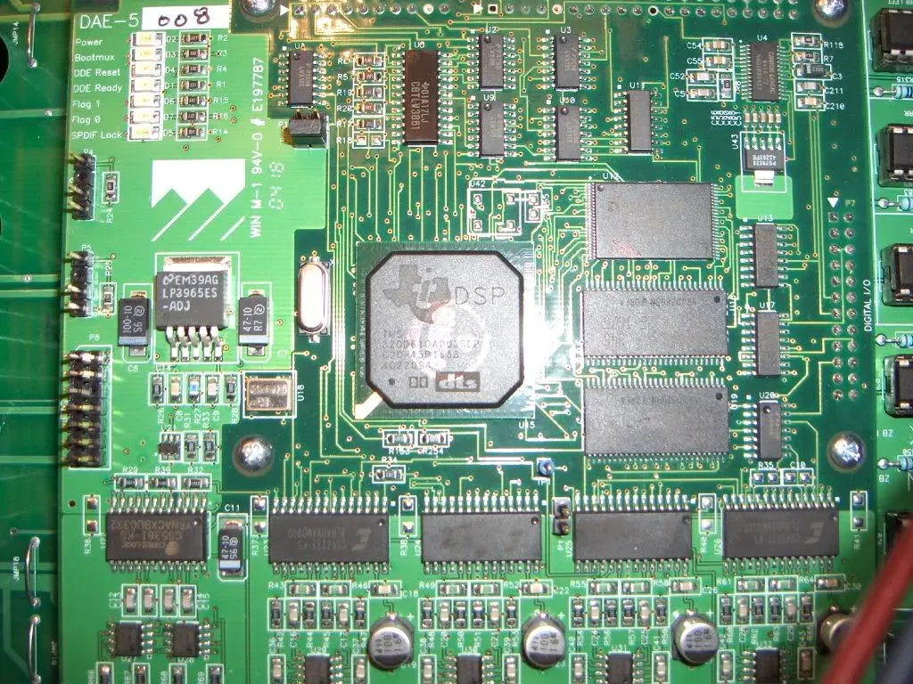

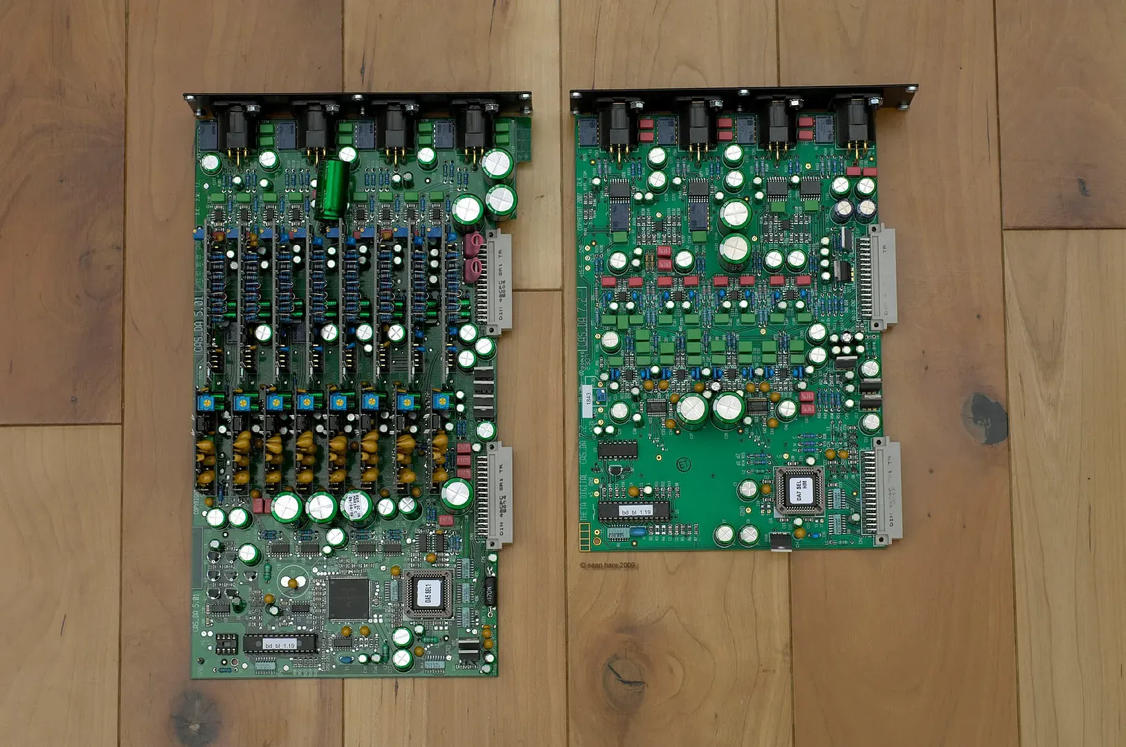

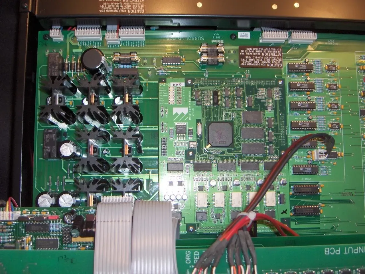

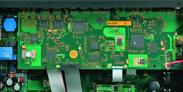

    Classe SSP-800

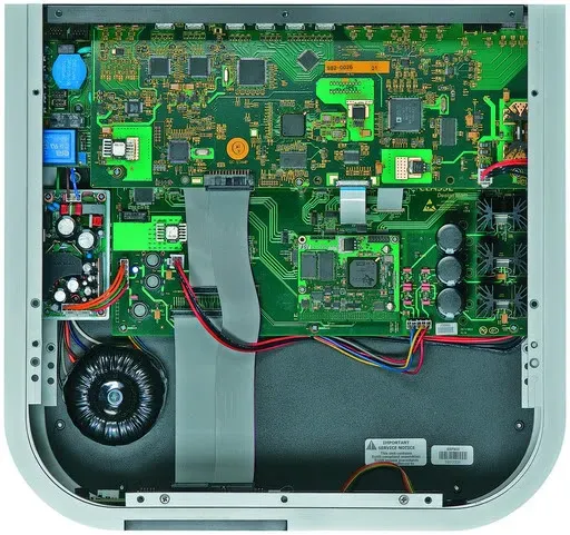

    Click image for larger version  Name:	SSP800MainGut.webp Views:	0 Size:	60.0 KB ID:	938132
    Click image for larger version  Name:	SSP800-Board1.webp Views:	0 Size:	59.0 KB ID:	938133
    Click image for larger version  Name:	SSP800-Board2.webp Views:	0 Size:	57.0 KB ID:	938134
    Click image for larger version  Name:	SSP800-Board3.webp Views:	0 Size:	103.8 KB ID:	938135
    Click image for larger version  Name:	SSP800-Transformer.webp Views:	0 Size:	67.9 KB ID:	938136

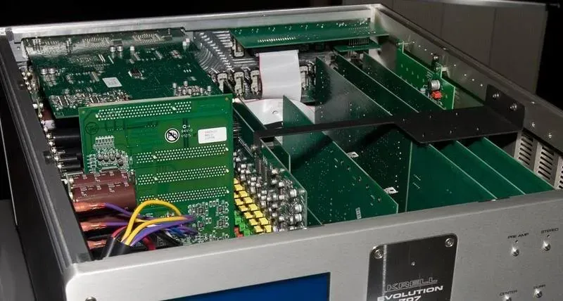

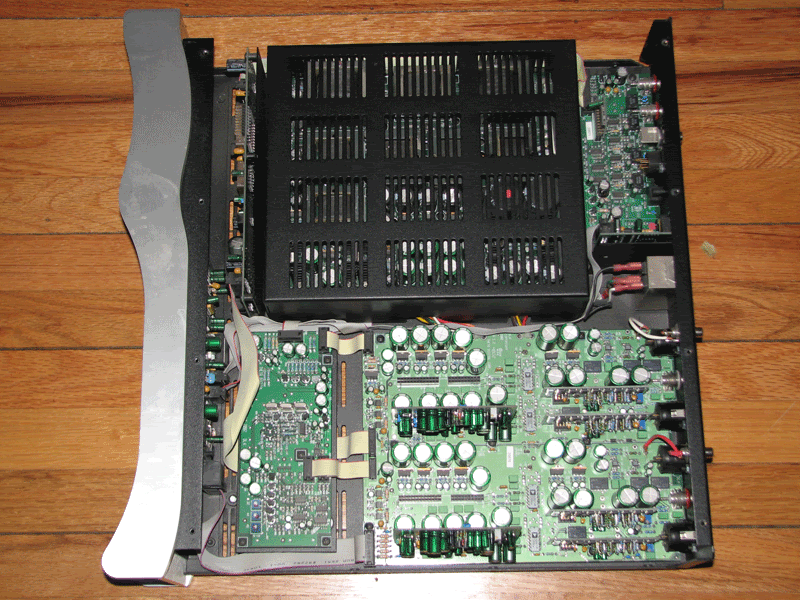

    Krell evolution 707
    Click image for larger version  Name:	707inside2.webp Views:	0 Size:	74.3 KB ID:	938137
    Click image for larger version  Name:	707inside1.webp Views:	0 Size:	54.2 KB ID:	938138

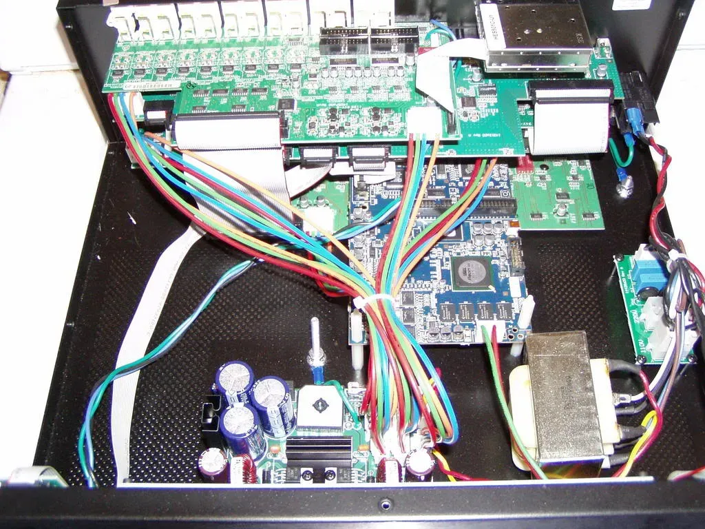

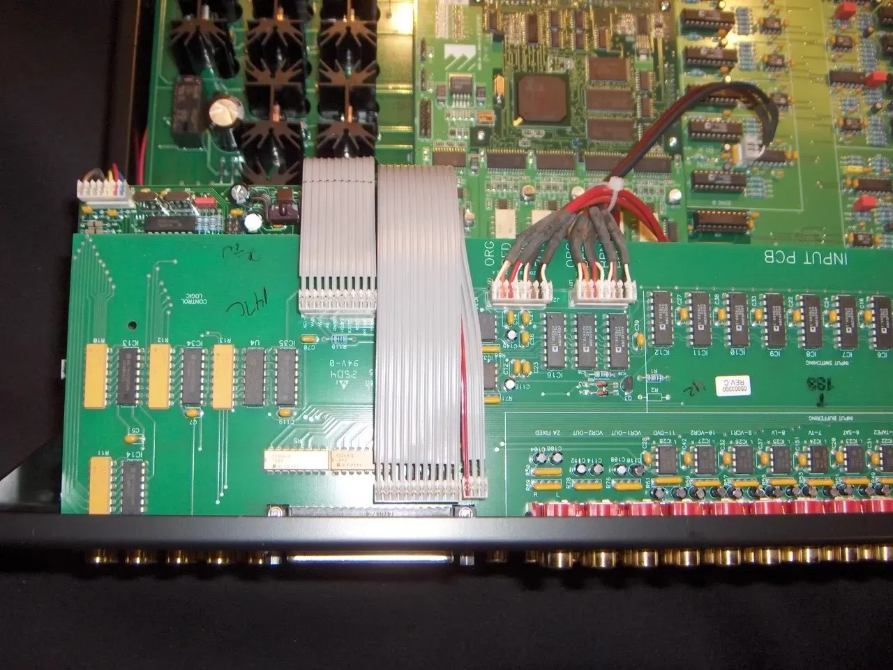

    Lexicon MC-12
    Click image for larger version  Name:	smr_101.webp Views:	0 Size:	135.4 KB ID:	938139
    Click image for larger version  Name:	smr_41.webp Views:	0 Size:	269.6 KB ID:	938140

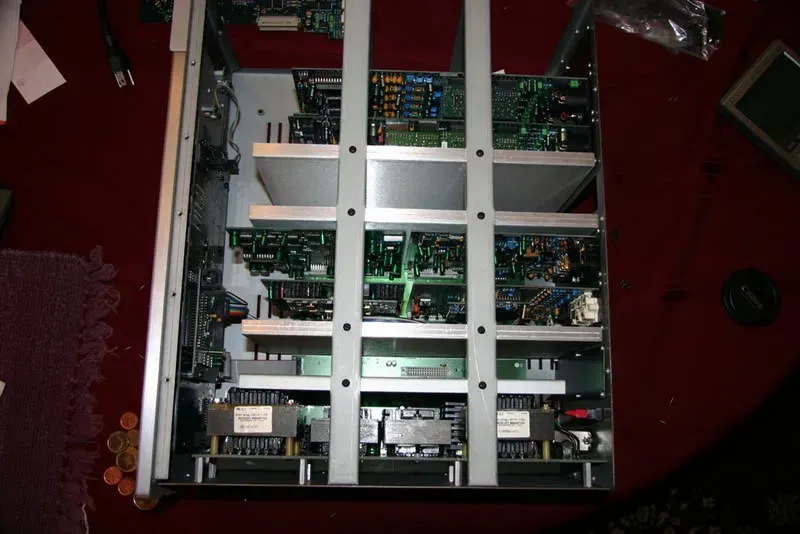

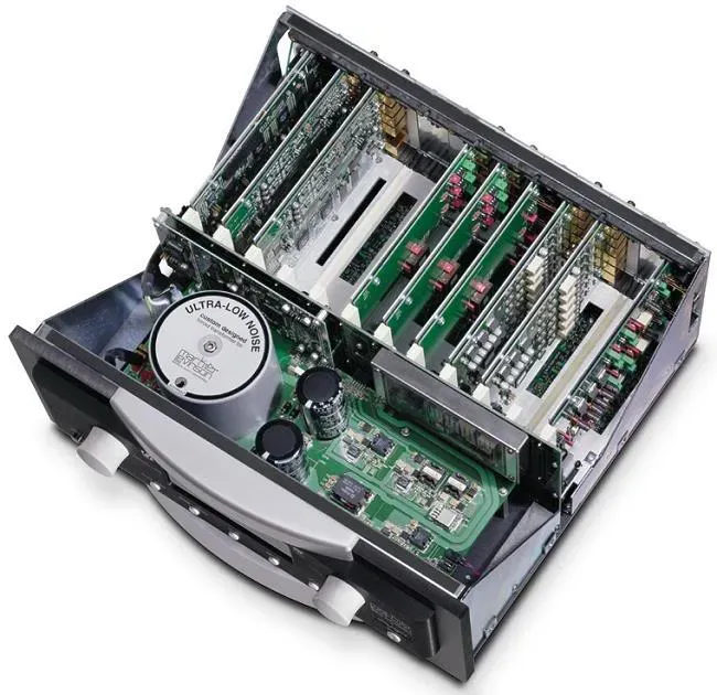

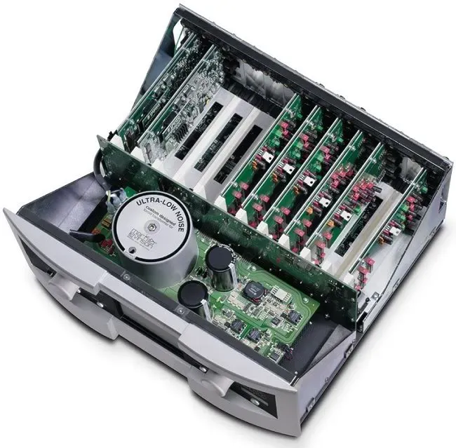

    Mark Levinson Nº 40

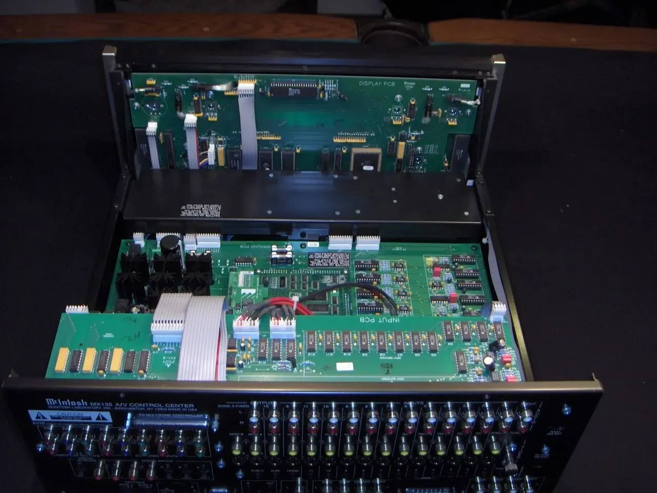

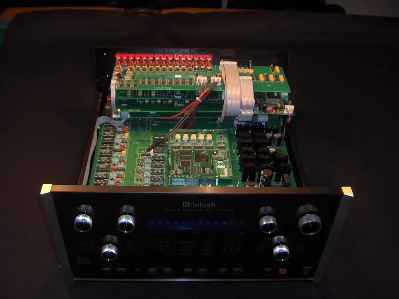

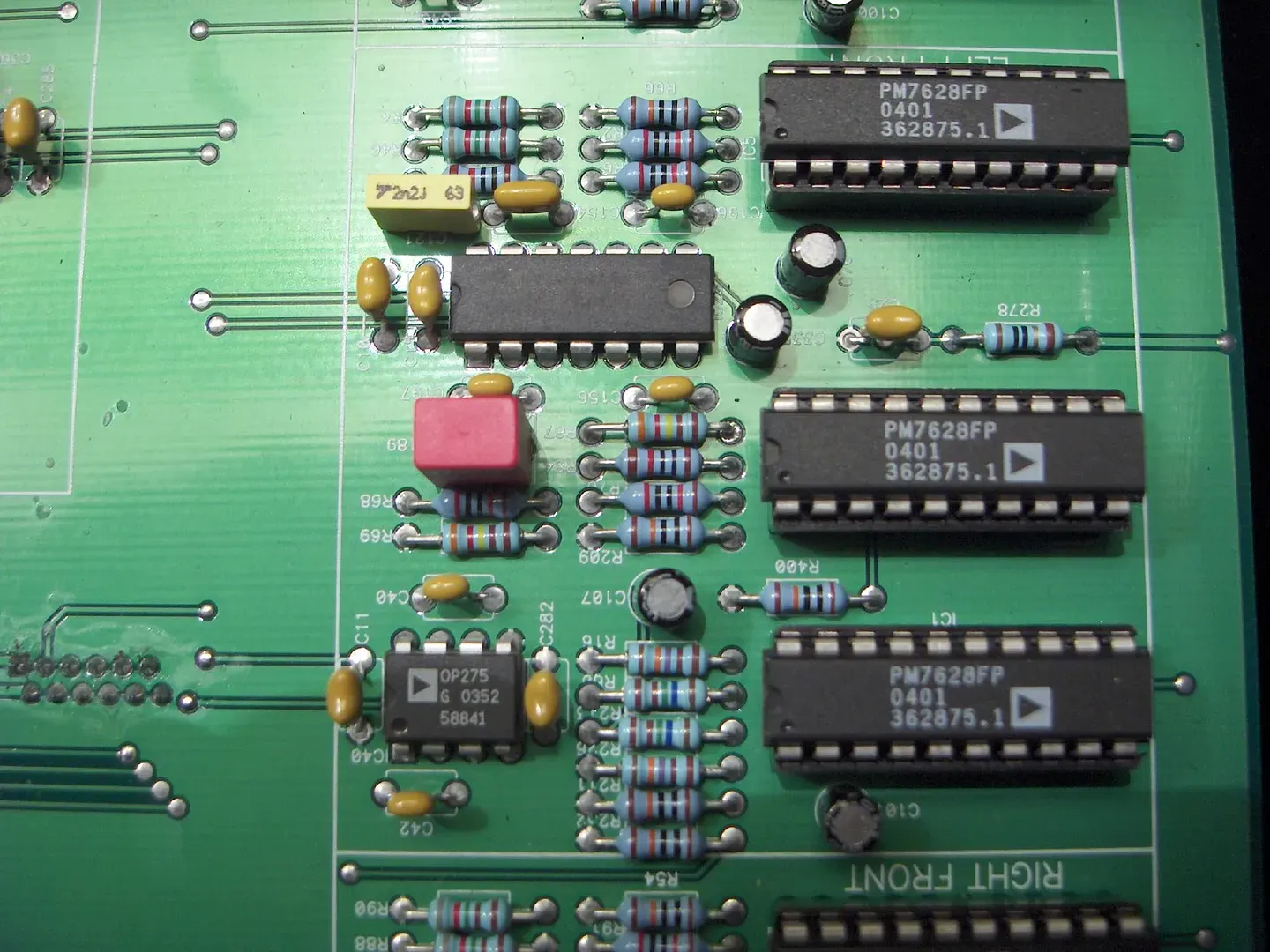

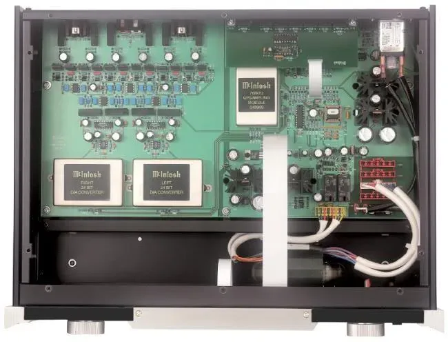

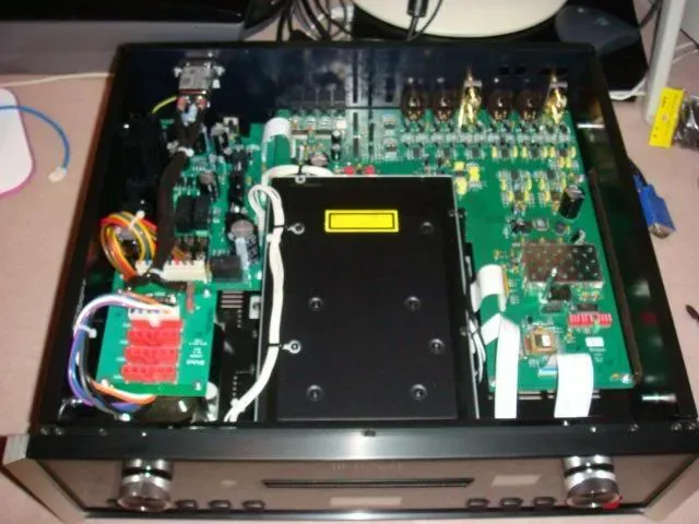

    Mcintosh MX135 MX136

    Here is a response from Classe when asked
    "With respect to the SSP 800 what exactly is it doing to a PCM signal which sets it apart from other SSPs? I assume that the DACs alone is not what separates the 800 from other SSPs. "
    Originally posted by Classe
    A. PCM (Pulse Code Modulation) is the most common form of digital audio. It appears fairly simple, consisting of the data and the clocks. The data can be either a one or a zero, while the bit clock defines the moment when transitions between ones and zeros may occur. The basic idea is that you want the data to be accurate and the timing to be precise so that the signal gets put back together (turned into analog) exactly as it was taken apart (sampled into the digital domain).
    Since cheap digital audio products can actually work, we know it isn’t particularly expensive to get sound from a digital circuit. What is exponentially more difficult and expensive, however, is getting that last few percent of performance. This where the magic in high-end audio has always been.
    It’s hard to be both specific and complete when there are so many factors that contribute to the overall performance of the SSP-800. I can site specific examples like the processing power of the Texas Instruments DSP.
    HD Audio involves more data than ever, so data integrity is a feature of processing power. Try to express the fraction 1/3 in the digital domain. You have 0.33333…, which is an example of the fact that digitization involves approximation. With HD Audio, we are handling more data than ever and performing more calculations than ever. Having a DSP which can do many different tasks while also maintaining the highest precision was one of the objectives of the SSP-800 design. We use a Texas Instruments platform which can process at up to 1800 Million Instructions per Second (MIPS). Compare that with the most common DSP used in other processors (including one costing over $20,000) and you’ll find them using a 300 MIPS part. Decoding Dolby TrueHD can use up about 270 MIPS, not leaving enough for EQ or other processor intensive post-processing functions. The TI processor works in 64-bit double-precision mode with floating point arithmetic (the decimal point can float anywhere in the number, giving small numbers higher accuracy). All this is to say that today, the SSP-800 has a monster of a processing engine. When the new dual DSP board is released, we will use a newer DSP chip, capable of up to 2800 MIPS—and there will be two of them.
    Other topics for discussion could be the masterful way power and ground are distributed within the 6-layer mother board, or how circuit trace lengths are calculated and optimized, or the use of LVDS (Low Voltage Differential Signaling) to minimize jitter (timing errors in the clock) and eliminate common ground between digital and analog signal paths. There’s also our sample rate conversion and re-clocking of the signals entering the DACs, etc. But the key to it all is attention to detail throughout the design. I’m sure there are also some details I can’t point out because our engineers have tended to them without even consciously thinking about it. Like a chef in a familiar kitchen, certain methods come naturally to an experienced professional.
    We also consider the reliability and stability of the design and whether digital circuits create radiated or conducted noise that detracts from the performance of other nearby circuits. However, everything we do has a single clearly defined purpose: to supply the DACs with exactly what they need (accurate, precisely timed data and an incredibly low noise floor to allow the highest possible resolution and dynamic range).
    The SSP-800 is special, but it does not owe that quality to any one part. I guess the cooking analogy works pretty well. Different chefs may have access to the same ingredients but come up with different results. Some are clearly better than others and sometimes two dishes might both be judged to be good, but the results appeal to different tastes. Using a more expensive wine in a reduction won’t necessarily improve its flavor or texture, so it’s both the ingredients and how they are used that matters. In the end we use our own senses to decide what works and what doesn’t. The DACs themselves are only one (although not unimportant) factor in the overall results.
      • 3815
      Very interesting post. And nice compilation of images.
      I am no expert with this stuff so just ignore me if I sound like an idiot. But on reading the Classe guy's response I have a couple of comments:
      1. He mentions the TI processor doing 1800 MIPS vs some other processors using 300 MIPS, and then mentions how that doesn't leave a lot of instruction cycles for EQ or other functions. What I'm curious about is, he mentions that decoding Dolby TrueHD can use up about 270 MIPS, but he doesn't mention how many cycles the other "processor intensive" functions use. Now I have not written audio EQ software before, but have been a software developer professionally for several years. I cannot imagine some of these other functions in a audio processor taking all that much in terms of processor power. EQ software to me would just be a bunch of simple equations to adjust the output levels to each channel appropriately. It wouldn't be anything nearly as complicated as decoding compressed audio. Not to mention other processor functions like running menus and such should not require much more processing power than a digital watch.
      2. Other than the processor the only things he mentions are LVDS and pathing on the motherboard, things which are pretty standard in any kind of digital electronics.
      3. He mentions the cooking analogy, but I have to disagree wholeheartedly with that. These devices are essentially computers. If I hand the same pile of computer parts to two people, and they both connect all the parts properly, they will end up with the same computer. Software, on the other hand, is a whole different ballgame, and IMHO where the real differences lie.
      Now this is no diss on Classe, just interesting to see things which seem rather common, or parts built by another company being mentioned as what sets a specific brand apart from another. I think it'd be interesting to see what other manufacturers' reps have to say as well.
      -Chuck

                        A TI DSD/PCM 1796 which measures better then the xtreme DAC's in the $30,000 theta are worth $2.95.
