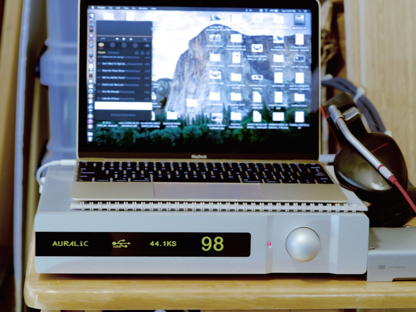

    I've got to do some different kinds of work now where I need to have a "known" and relatively portable music source on hand- after doing a lot of research, looking at reviews, both test data and listening comments, it seems to me that the Auralic Vega is the tool I need for now...
    It's on burn-in for a while, the only convenient extra source I have is not what I would consider ideal, a Macbook running an OS beta, (El Capitan, the successor to Yosemite) but it will certainly be fine for just putting some hours on it. And you know what? Even through the Phiaton headphones I use mostly for gaming and computer stuff, it sounds pretty dang decent... at least with Edie Brickell and the New Bohemians, also with Howard Jones. Both robust and delicate, seems to get out of the way of the music nicely- will have to listen to a variety of recordings on it to see.
    I am using a Schitt external headphone amp with it (doesn't have that built in) but the Vega does have robust balanced outputs, and also AES-EBU inputs, so it hits my key check off list points.

    One thing I think I've learned today, is that USB C is NOT a good idea for audio... they splice a lot of different data possibilities together, and I think it may mess up asynchronous transmission. Anyway, playing a number of cuts, some came through OK, some had a bit of grit or grunge, and some plain out had drop outs and clicks.
    So, I switch to my 2014 MacBook Pro, and whoa.... this is more like what I was expecting. Lots of definition, and that up front sound that Auralic Vegas are known for. And that little headphone amp is working pretty well for only a C bill! :T
