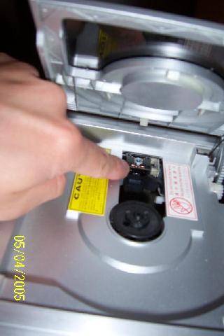

                                I got your email, but let me help you on this thread so others can benefit as well. How would you like to set it up? Have you had a HT before or is this your first setup? There are a lot of wires so if this is your first time, it can be intimidating.

                                  Success! Let's see how long the fix/realignment lasts.

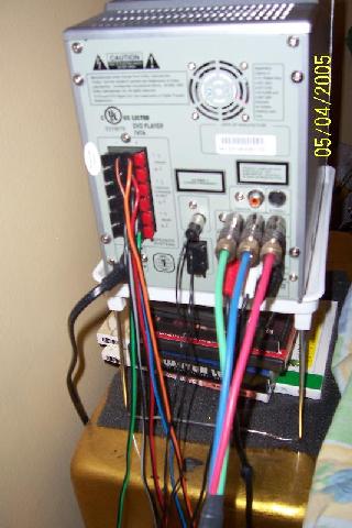

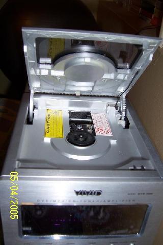

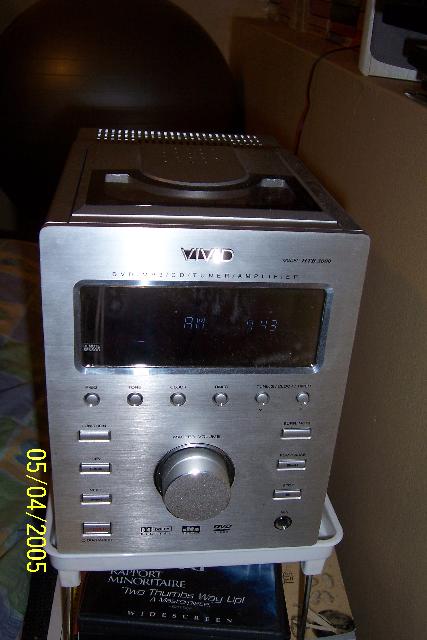

                                  Here's some pics that I took to show you what I did.
                                  Hmm, let's see if I can figure out how to post pictures again. Just click on the thumbnails on the bottom.
                                  First picture is the front panel of the machine.
                                  Next picture is the back of the machine. Check out all those cables.
                                  Third picture is the top open ready to accept a DVD. The laser is just past the spindle.
                                  Last picture is where I just used my figure to push back the laser.
                                  Issues: When I first attempted this fix, I didn't get instant results. In fact my player refused to even spin a DVD or CD. So I was a bit bummed, but then it stopped playing DVD's for about 2 months now. So I popped the lid open and with a DVD in the spindle, I turned the dvd with my hand and closed the lid. I did this about twice and then the unit started working! In between I was powering off and powering on and pushed the laser pickup back again. So I'm not sure what I did to fix it, I just care that it's fixed! :T
