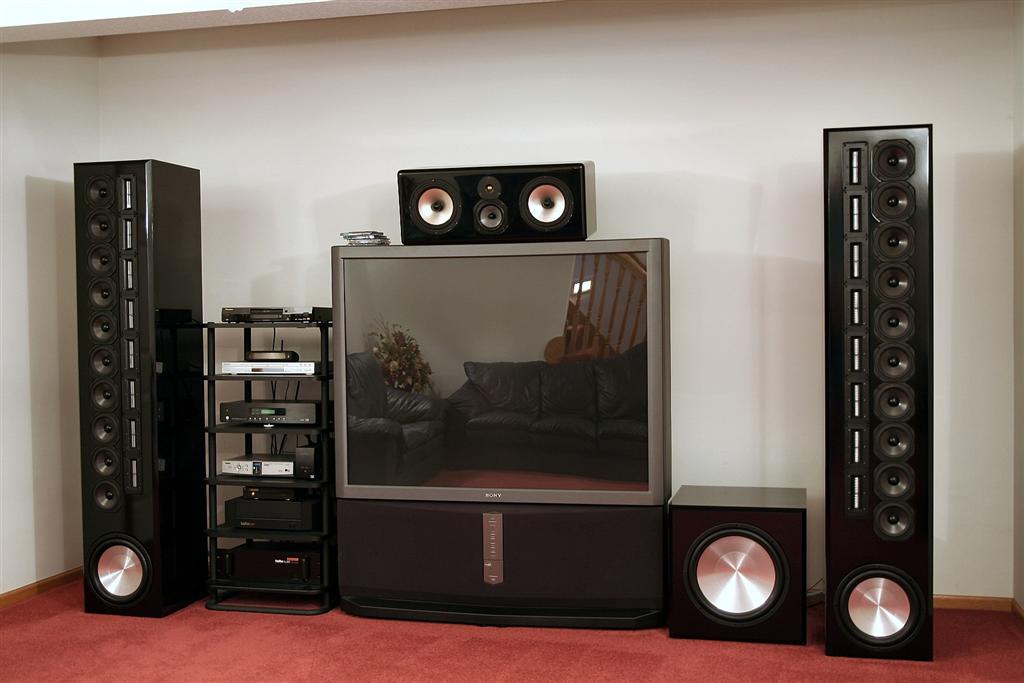

                          This is an excellent point that I forgot to mention. The HPSA amps won't put out full power unless you either use a "Y" cable in the L/R RCA inputs of the HPSA or tie the sub amp into your mains for a full range signal. It should also help with the turn on sensitivity issue.
                          FWIW, I had three of these amps at one point in my home theater. One powering a 12" AV-15 in each of my line arrays and the third one powering a 15" AV-15 sub. All of them had the same issue. Once corrected, they've worked flawlessly.
