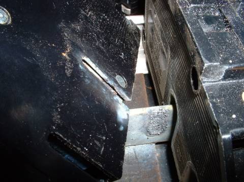

            Thanks John. Well I spent the better part of today rerouting electric cords and bundling signal cords away from power cords. I also was able to remove two extension cords that I did not need after organizing the gear better. Then I spent some time checking my interconnects and for some reason two of them had loose end plugs that I screwed tight. I don't know the correct term for them (they are the male plugs on the end of the cord ). Then I rerouted my left and right interconnects to try and give them more space from other cables. I then turned only my amp on and the buzz is basically gone. To hear it you have to put your ear a few inches from the left or right speaker now whearas before it was audible from a few feet away. So here is the topper of the story. After doing all of this, I go to turn on my amp to listen to some music. I just recently had a dedicated 20 amp line installed for this amp. So I turn on the amp and after about two seconds it turns off and I notice my 20 amp Panamax suppresor that is on that line shut off the power. So I go out to the electrical box and I see the breaker is red and needs to be reset. Well I thought no big deal but it did seem kindof strange. So I go to reset the breaker and the breaker comes out of the electrical box. Gee I guess the electrician didn't do too good of a job installing the breaker in the box. Thank goodness I had my Panamax on line or maybe the improperly installed breaker might have sent some kind of surge to my amp. So now I have to wait for the master electrician to call me and set up a time to come back to install the breaker properly (you know so it doesn't fall out of the panel). :M Thanks guys for your input, I think this problem is solved.

              To end this story, the electrician came back out and put in a new beaker and all is well. The first one had a bad clip so it did not stay on the connector in the house electricial box thereby shutting off the power. Weird but all is ok that ends well. :B

                  Was it an arc fault breaker (should have test buttons on it) ? That may explain why it tripped from a loose connection. That's a good thing. A standard breaker would likely have kept arcing repeatedly at the contact point, causing burning and pitting, or worse, a fire.

                    No it did not have any test buttons on it. Basically the contact clips did not hold it tight in the box so it actually sprung off the house box connection causing the power to go off to my amp. The electrician told me later that he used a "restored" breaker (read used). He replaced it with a new one that grabs tight when snapped in place and no problems anymore. Gee you'd think for $300 he would have used a new one in the first place. I didn't know he put in a used breaker at first.
