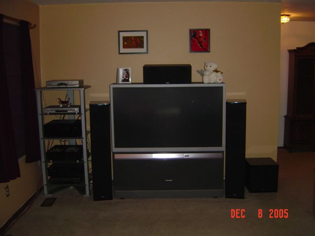

    Hello, I was wondering if anyone has advice or corrections for having difficulty hearing dialog in most movies. It seems that the center channel has a much lower recording level than the rest of the channels. I find myself cranking up my system to hear the conversation and then turning down when I am blown out of my chair from the action. I have used a spl meter to set all my speaker levels correctly and even matched my subs to the proper level.. Is this something I will have to live with or is there a cure?

      A couple of suggestions that may be helpful.
      I have my center channel sitting on top of the large screen tv. Tilting it down so it points directly at my listening position helped with my system. I have an AVR-3801 which has a setting for "music" or "cinema". Music mode sends a lot of the center channel info to the mains, cinema leaves the info separated. Is there a similar setting on the 3805?
      There is also nothing that says you can't crank the center channel a few db above the "balanced" level if it sounds beter to you.

          Assuming your system is calibrated via avia(ignoring the auto setup that is currently out there), I would go the route of tilting your center. Simple rubber door stops will do the trick and not be visible.

                  Center channel is matched size and brand with fronts. Also it is tilted down towards the viewer.
