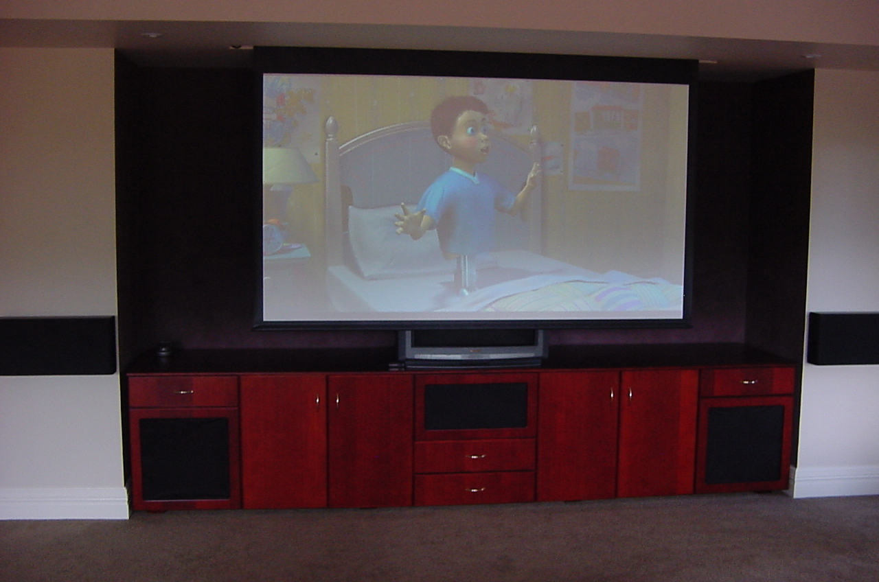

    After a bit of reading on room / subwoofer interactions, I picked up a Behringer Feedback Destroyer Pro from a local Music shop on friday. Yesterday I spent a couple of hours setting up the BDF with my two subs. You can view the results in this graph. As you can see, I had three large humps, while not a 'house curve' yet (a bit more tweaking is required), the BFD has greatly smoothed out the response of my two subs. While the low end slam is still there, the big difference is the increased clarity in the mids to highs as the humps around 56 and 100Hz were muffling the higher frequencies. I never realised this until I heard the difference. You can take the BDF in or out of circuit with the press of a button, so its easy to compare the sound before and after. I'm a newbie with the BDF, but so far the results are very promising. I'll introduce a 'house curve' by raisng the frequencies (reducing my current cuts) < 40Hz when I get some quite time (i.e. wife and kids aren't around). While the BDF has a bit of a learning curve, this guide is invaluable. I'd really appreciate if any any of the more experienced BFD users had any suggestions on how I could improve my graph further.

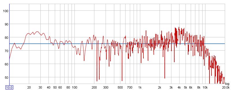

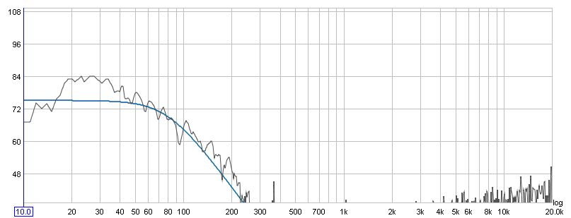

                                    I have made some more adjustments to my subs using my recently acquired BFD. I originally charted my response with that spreadsheet, I have since tested it with RoomEQ Wizard. I'd also like to thank Sonny for his amazing guide page and spreadsheet.
                                    It looks like my filters are doing the job... do you think the peak in the lower region is too high? This sweep is with the subs only.

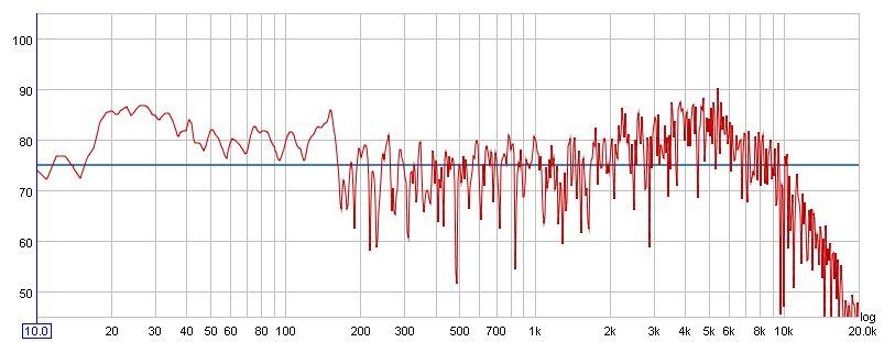

                                    Also, here is a graph of the the fronts with the subs in stereo 10 Hz - 20 KHz:
                                    Here is an image of all speakers running in 5.1 DPLII Cinema mode 10 Hz - 20 KHz:
                                    If anyone see's any problems or something I should address, please let me know.
                                      Nope. I think if you look at the subs response from 20Hz and higher, it's quite good. Ignore the graph less than 20Hz. Not much info there anyway. The portion from 20Hz to 50Hz satifies what many would call a house curve. I'm sure it sounds fine. :T
