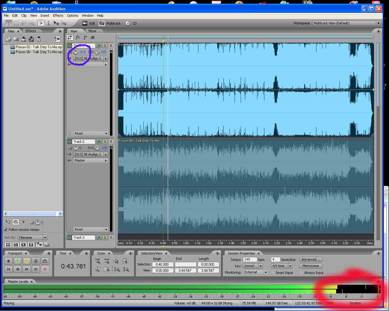

    Maybe I'm going to go on a little bit of a rant here (but it shouldn't be too bad).
    First, let me start of by what is causing all this...
    I originally thought that I had lost a couple CDs, they were my Poison collection. I've known that one of the discs had been missing, but recently couldn't find the other two I had. So I found the remaining two the other day (as it hasn't been recently that I've listened to them), and knew there was some good songs off the third that I was missing. Well I'm going to go to the store to pick up the old missing disc, but in the mean time I borrowed my friend's greatest hits cd, which is 'remastered'. So looking forward to the 'remastering' done to the old songs, I popped it in and started listening.
    This is where my frustration begins... upon listening I found myself disinterested in the music. Which for me is odd, especially since I love listening to old music that I haven't heard in many years. So out of my own curiosity, I popped in my old CDs (early 90s printed) and the sames songs I listened to on the greatest hits disc I found much more pleasing on the old CDs. Things I noticed is the remastered version, while louder, seemed to have very little dynamics to it, which is where I think my disinterest came in.
    So now I moved into trying to figure out why this was... I ripped both CDs down to my PC using EAC (Exact Audio Copy) with Accuraterip and then opened the similar tracks with Adobe Audition. I went into the multitrack mode and lined up the tracks so they are beat for beat identical. *note see picture below*
    The first thing I did was move the 'remastered' track to the Right channel by 100% and move the Original to the left track by 100%. I think matched the tracks beat for beat and started to play around. Being that the original track as mastered back in the mid 80s ('86 to be exact) its over all volume is much lower. To compensate for this, I lowered the 'remastered' track by -6.5dbs (circled in blue) and to my well trained ears (lol) both channels sounded Identical. I repeated a section of the song and used my sound meter just to make sure I was dead on. I then played and found a decent example of a spot in the track(s) that really shows how "limiting" the remastered copy is. Circled in Red is what I mean it's the same beat and you can see where the last beat was (noted by the small line) and the current volume is. There is almost a 6dB difference, where the remastered version has less than 2dB.
    If I had a video of the bars moving you would see that, except for the drastic silence to loud parts, the bars stay typically within about a 5 - 7dB range. However, the original mastering goes over a much more dynamic range of almost 10 - 18dB. You can completely tell a difference in the kick drum and the "power" it has behind it in the original recording over the remastered version.
    One thing I did do was increase the volume on the original master by 2.5dBs and it was amazing close (volume wise) to the remastered track but it still had all the dynamics to it... Why then can't they just remaster the disc by making sure it sounds the best it can instead of just upping the volume and running limiters on it so it doesn't clip?!?!
    This really got me depressed that they (the recording industry) considers this type of thing 'remastering'. I mean, yes, I know that technically it IS remastering...but it's not a BETTER version of the track. I went through a couple of my other 'remastered' CDs and almost every one is this exact same way (one that isn't is the remastered version of Pink Floyd's A Momentary Lapse of Reason). The reason I think this one is done much better is the fact that Roger Walters had to sign off on the remaster and worked with them to get it sounding like it does.
    Having now experienced and seen for myself what the recording industry is doing, I will now be hard pressed to buy a newly 'remastered' recording of any CD I want.
    Yeah, maybe I'll have to turn up my sound system a little bit louder, but I'm 100% ok with that, after all, that IS why there's a volume knob on my Pre...
    I just feel helpless like the music industry is getting away with this-- which to me is like killing music --and there's not way to stop it. It also bugs me that we as a society are more concerned about how loud something is over how good it sounds... If this is the world of music we are going to continue to get, I'm not going to be listening to much more music. I'll keep trying to find the older recordings and just stick with them....
    Sorry for the somewhat rant and most likely mindless pieces put together, but does anyone else feel like this??? I think we need to start a petition or something to state that we (as music lovers) want quality, not loudness!!!!
    I apologize for the picture quality, it's tough to fit a whole screen into a 100Kb file.
